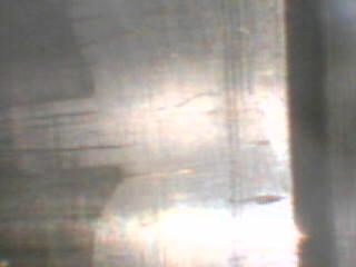

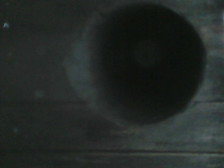

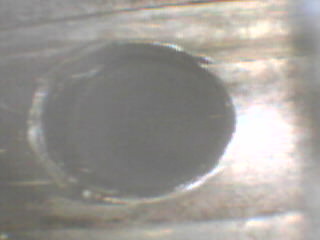

Post from subwrx is on point. BA, even their match line, is pretty rough out of the box but do shoot pretty well once they are given time to settle in.
Here is one that was used as OE on a complete upper:
New, but test fired:
1150 rounds and a lot of de-coppering:
It shoots right around 1 moa, which is very decent I think for what it is.
Port burs, which an indication of poor finish work, are not really a problem if you plan to break the thing in. They shoot out very fast.
The rough throat and some button chatter it had were more of an issue, and the first couple cleanings would pull out blue gobs with an aggressive solvent like Sweet's
All in all, I think they are a decent value and it's worth noting that you get what you pay for.

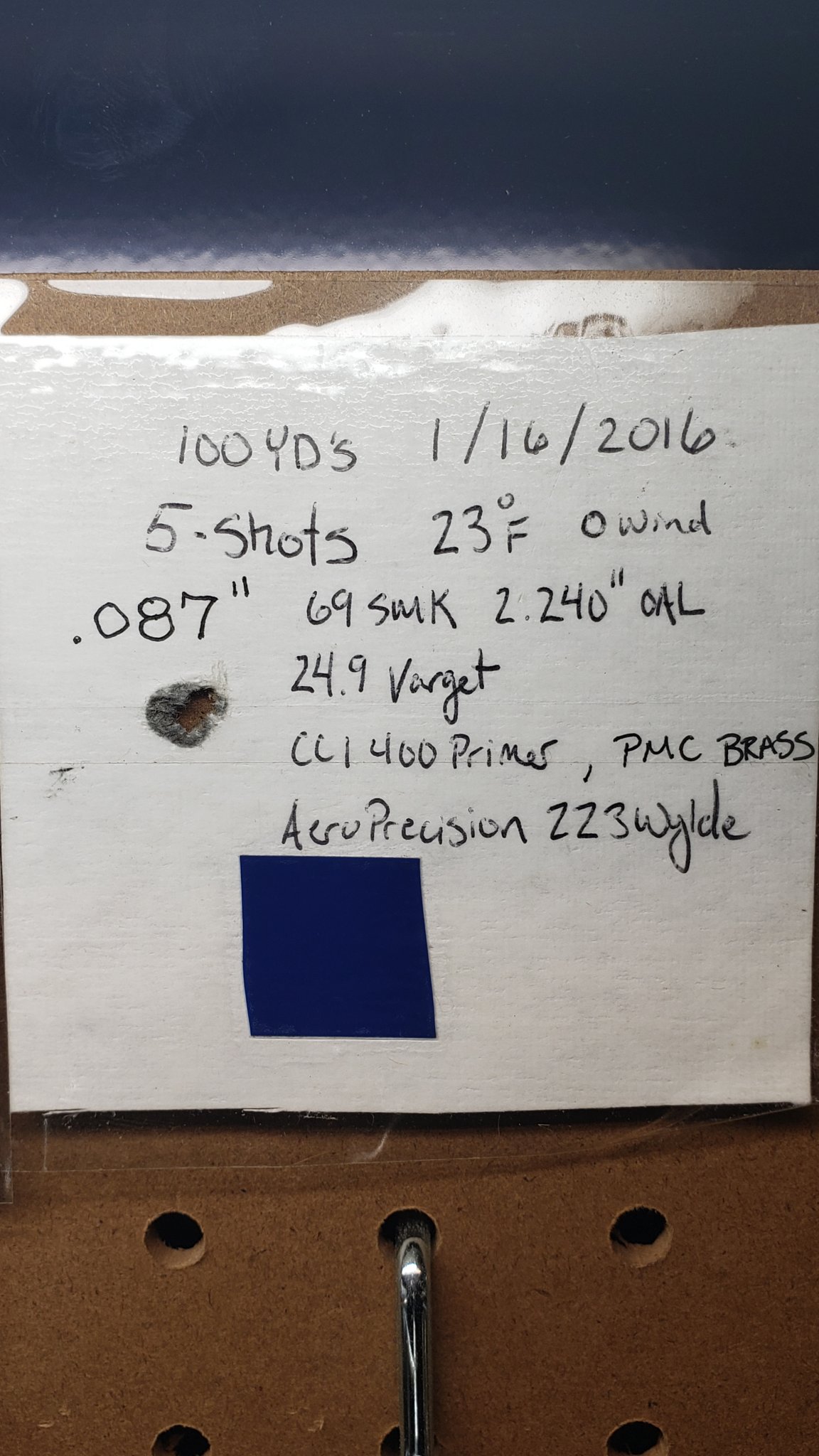

I do have AR barrels that get .5 MOA or slightly better with match grade, but now we are talking hand lapped, cryrogenicly treated and a whole different price point.
I'm not usually about single groups meaning much, but I can say with certainty that whether lucky or maybe before quality changes were made, my Aeroprecision complete upper 18" DMR was the most consistently accurate AR barrel/upper I've owned. It shot most 5 shots groups into .5-.7 or better with very few groups at 1" or worse. At distance it stayed the same (sub minute) out to 400+ yards under calm conditions.
In fact it still holds my personal record for smallest 5-shot group. Picture below. Stars aligned and while I've come close since, even my bolt rifles haven't touched that group yet (they hover in the .2-.3 for best groups).
Sample of one but AP and Ballistic Advantage will always have my vote of confidence until they break it with a crap barrel (which I haven't gotten yet).

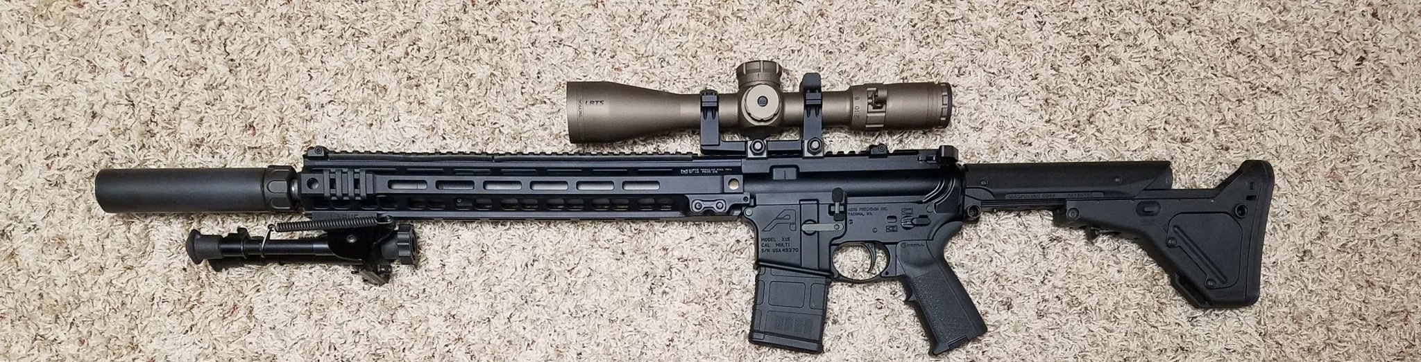

I just finished my 3rd 6.5 Creedmoor AR, the second build using a Ballistic Advantage barrel. This time I used an Aero Precision M5 builder set (cerakoted FDE by a friend), Brownells nitride 308 bcg, Ballistic Advantage 18 inch fluted premium barrel, Vortex Diamondback HP 4-16x42 (temporarily), Magpul UBR gen 2 (also cerakoted FDE by my friend), SLR Sentry 8 clamp on adjustable gas block, Schmid Tool & Engineering Corp nickle teflon trigger (Brownells), JP yellow reduced power spring set, JP 308 polished carbine spring, Spikes Tactical AR-15 H3 buffer and PVA Mad Scientist muzzle brake I had laying around.
After shooting a box of factory Hornady 140 ELD-M ammo to do a quick break-in, tweaking the adjustable gas block and zeroing the scope, I shot two 5-shot groups of my 140 ELD-M load I developed for my 22 inch 6.5 Creedmoor (one group pictured). The first group went into .63 moa, the second went .64 moa. Ejection was about 3 - 4 o'clock and bolt hold open. No cycling or feeding issues whatsoever. The scope and trigger will be replaced when funds allow. The Schmid T&E trigger is a pretty damn good trigger for the money (e.g. $37 @ Brownells) and is better than the ALG QMS triggers I have in other builds. I plan to cerakote the barrel and muzzle brake graphite black but didn't want to put the money into the barrel until I knew it grouped well. Suffice it to say, it will be pulled and cerakoted. LOL
Now the pics...

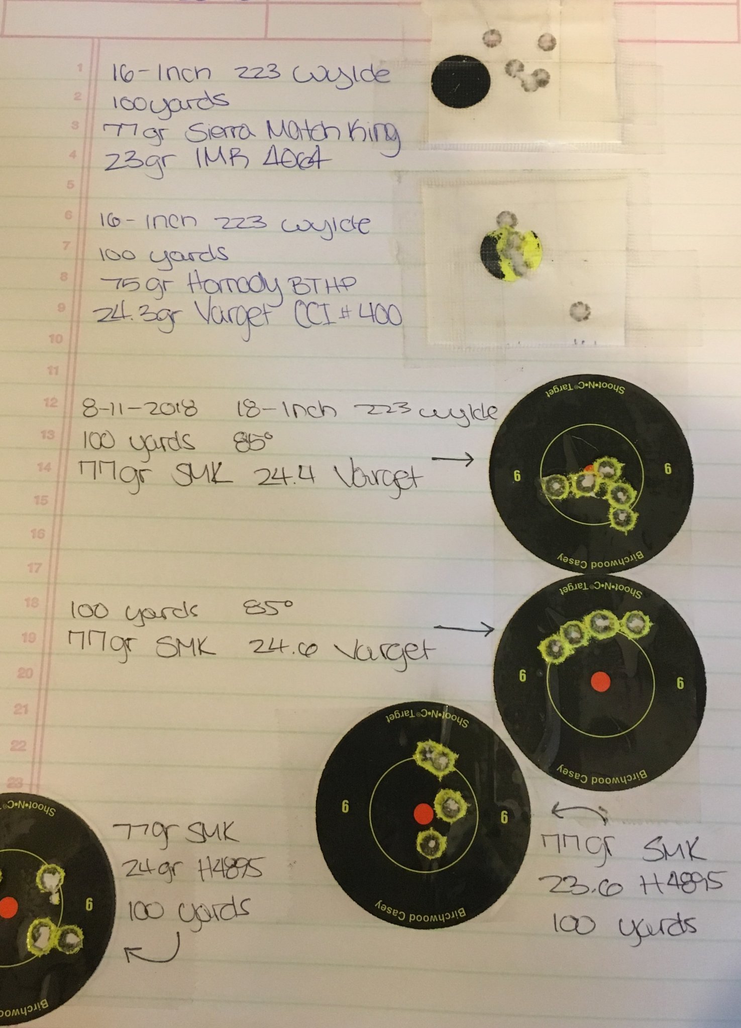

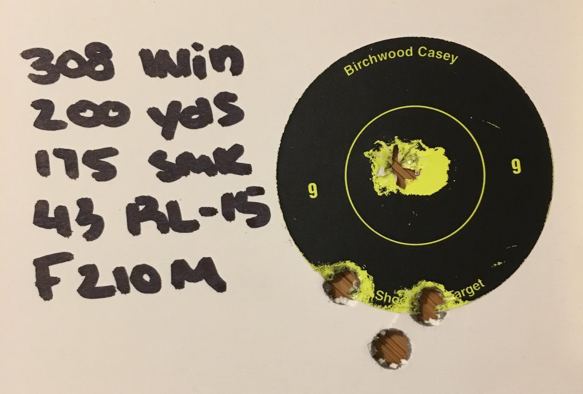

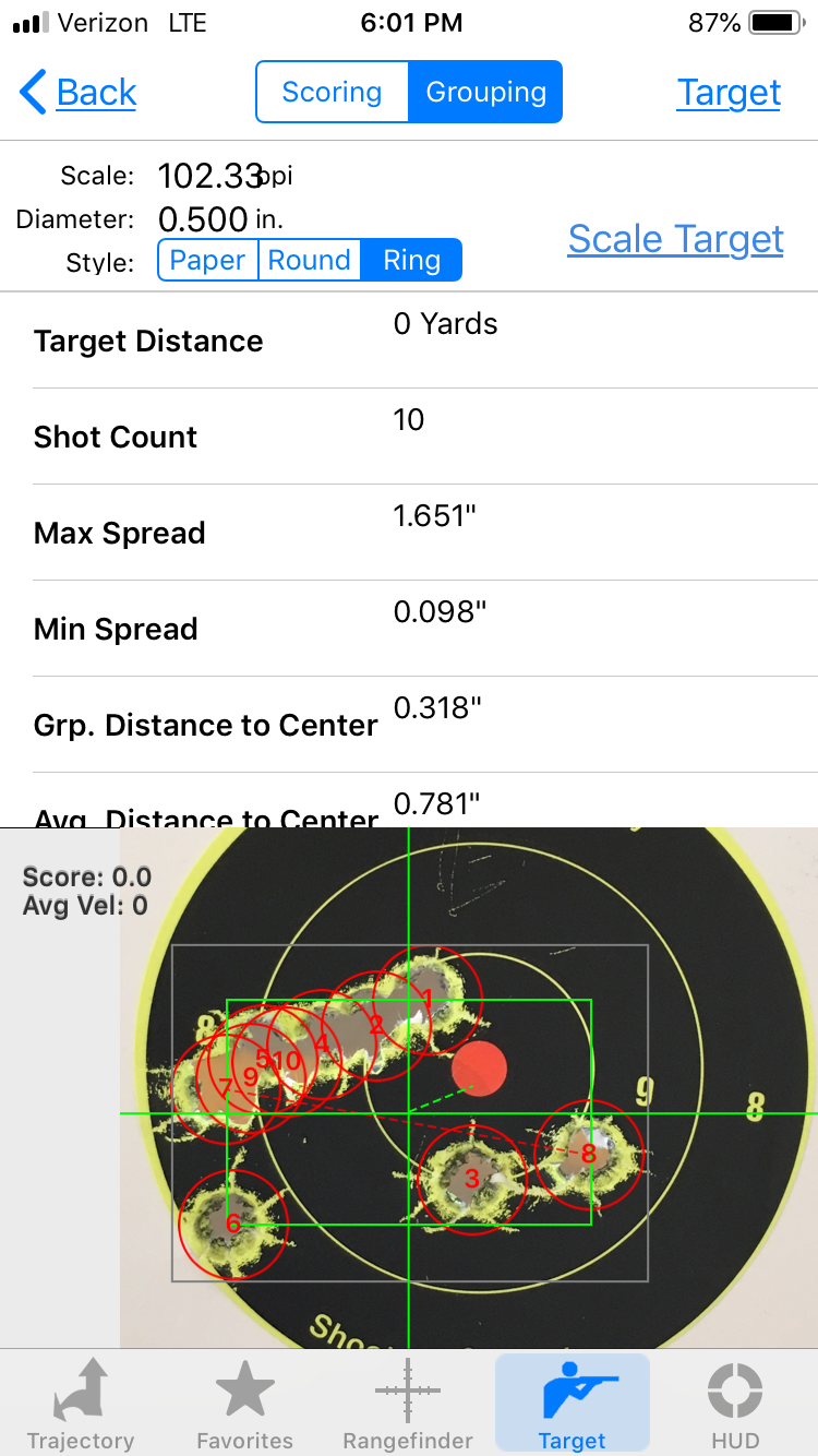

I've owned 4 barrels from Ballistic Advantage. I would definitely recommend their Ar-15 barrels, both of my 223 Wylde rifles shoot sub MOA and have been super easy to reload for with 69gr and 77gr SMK and Varget.
I've tried 2 different 308 Win barrels and had to return them for failing the no-go gauge and field gauge tests, and also poor accuracy. I ended up settling with a Criterion 24-inch barrel on my LR-308 and it's been a sub minute shooter since day 1. The 3rd photo is 10 shots at 200 yards with my 175gr SMK / 43gr RL-15 load. Needless to say, I have a ballistic advantage barrel that I'm looking to sell now :|

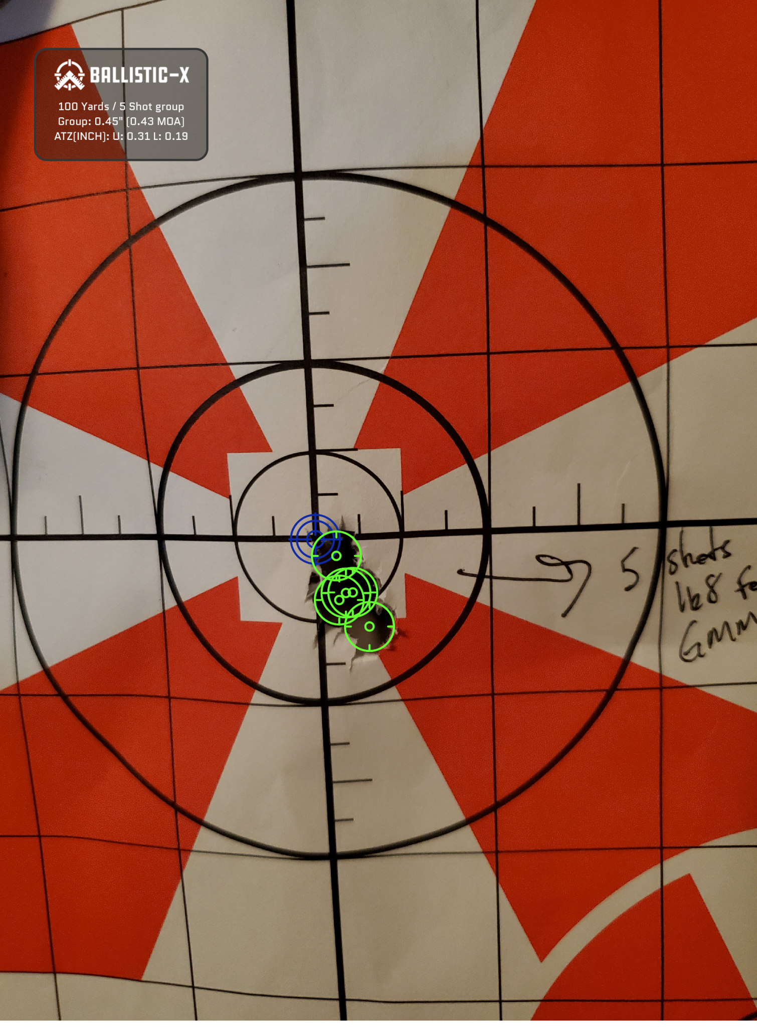

I have a Premium SPR 16" mid length 223 Wylde with pinned gas block. Accuracy is sub MOA and it is pleasant to shoot suppressed. I was concerned that it would be over gassed with the suppressor, but it actually shoots very soft with no gas blowback with the SureFire.
Also, they have an MOA guarantee on all their barrels. If it doesn't shoot, let them replace it for you.
Messed around with an Aero complete upper with a 308 SS BA barrel on it. First one was a complete dud. Sent it back to Aero and they replaced it without question. Second barrel with 168 FGMM......
Ballistic-X-Export-2020-02-06 20:11:12.166660.png
I've tried 2 different 308 Win barrels and had to return them for failing the no-go gauge and field gauge tests, and also poor accuracy. I ended up settling with a Criterion 24-inch barrel on my LR-308 and it's been a sub minute shooter since day 1. The 3rd photo is 10 shots at 200 yards with my 175gr SMK / 43gr RL-15 load. It's 1.651 inches center to center so just over 1/2 MOA. Needless to say, I have a ballistic advantage barrel that I'm looking to sell now :|
1.5" would be 3/4 MOA at 200.
