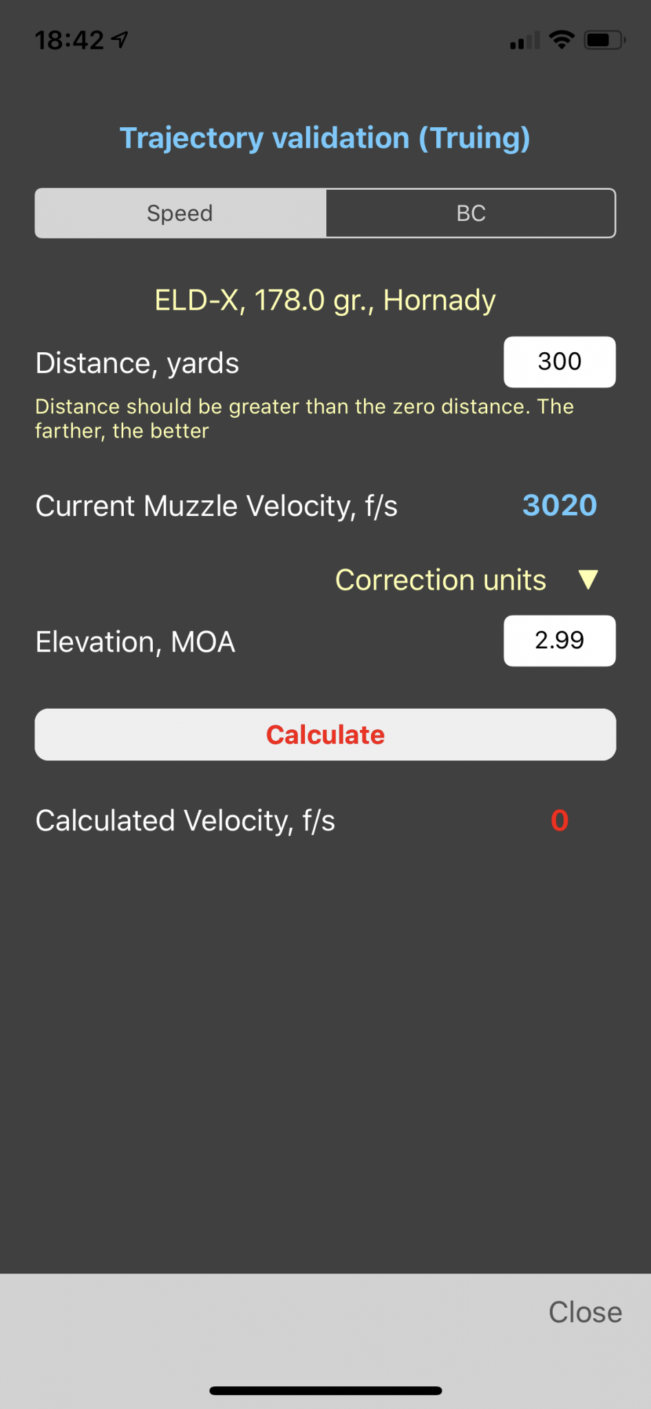

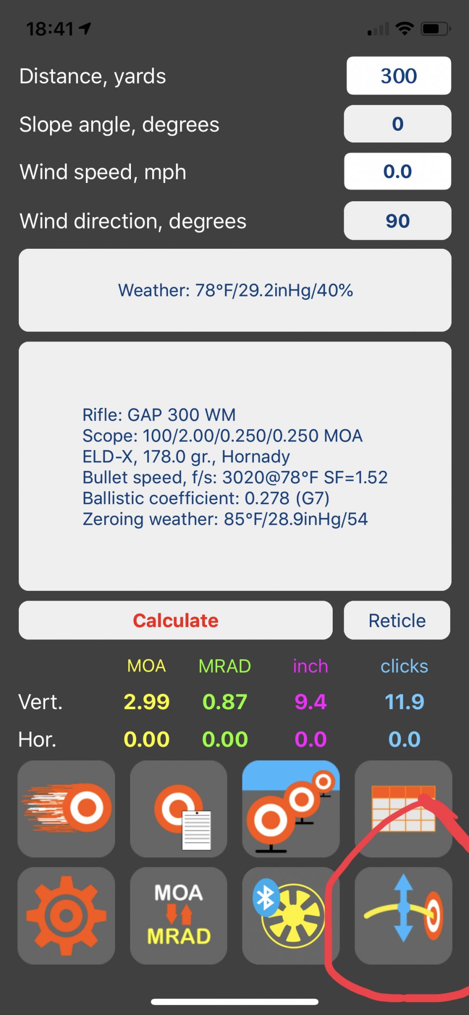

That’s 2 pics. Click on the icon circled in red and the other screen should pop up. Enter yards and drop. Will suggest a different speed. That’s how I do it

I generally sight in for 100 or 300 depending on rifle. Than shoot 300/500/800 yards to verify drop.
Since using my magneto speed the app has been very close. The old crony I had wasn't very accurate and I would have to adjust the speed and bc to fine tune the app. Usually can get all drops within 1/4 MOA to 800 just adjusting numbers on the app
If I understand your question, it is generally accepted to adjust bc to true your software. Especially since you have chronoed and are confident in your muzzle velocity. You can true via velocity or bc on those screens above.
Reactions: Gobears16
That’s exactly what I want to do but didn’t know how to do that on the app. Looks like you guys have helped me figure it out. I knew it had to be a simple fix
