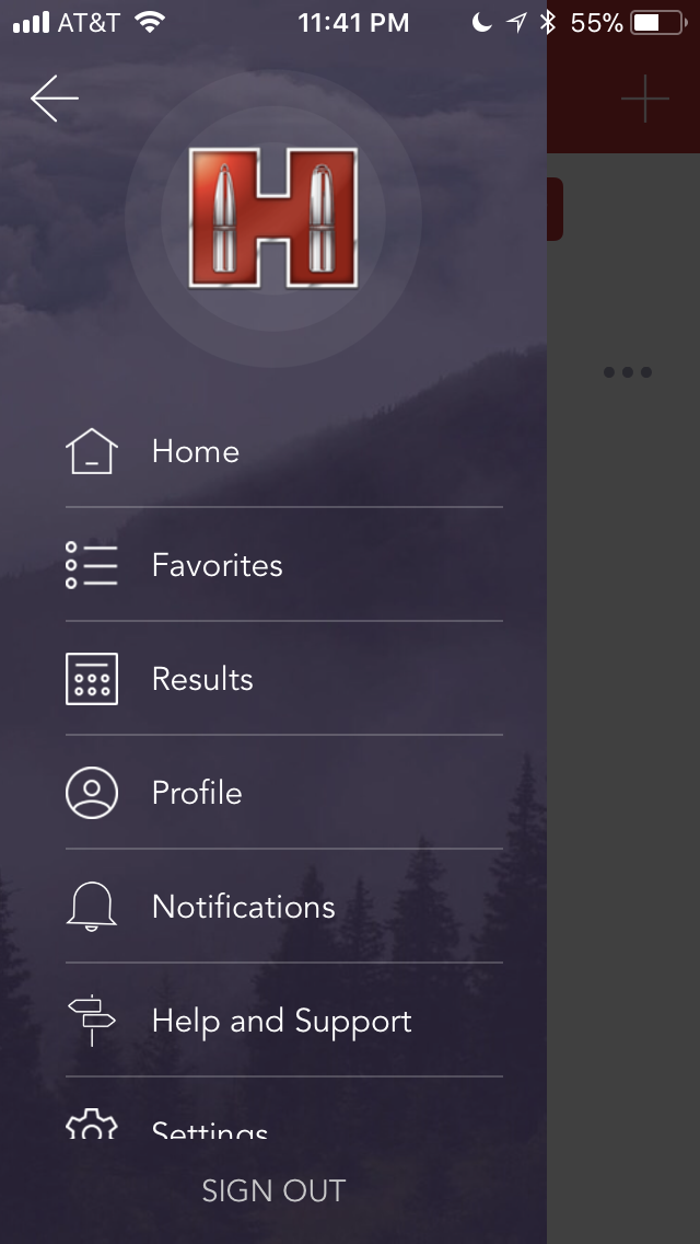

Set up your log in - here is the main page:

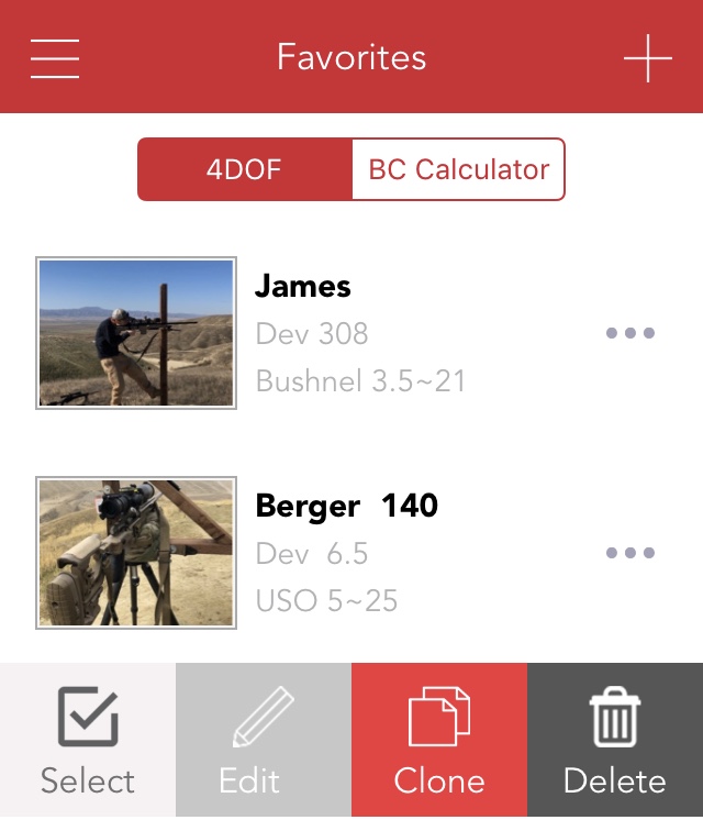

Click on Favorite- the the + button to add rifle data in either the 4DOF or BC listing

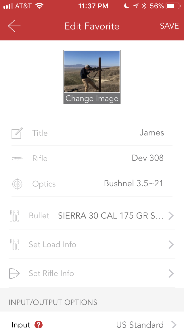

Click on the profile to edit or copy.. enter or change data

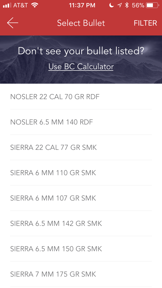

Click on Bullet to find if one is listed in the 4DOF

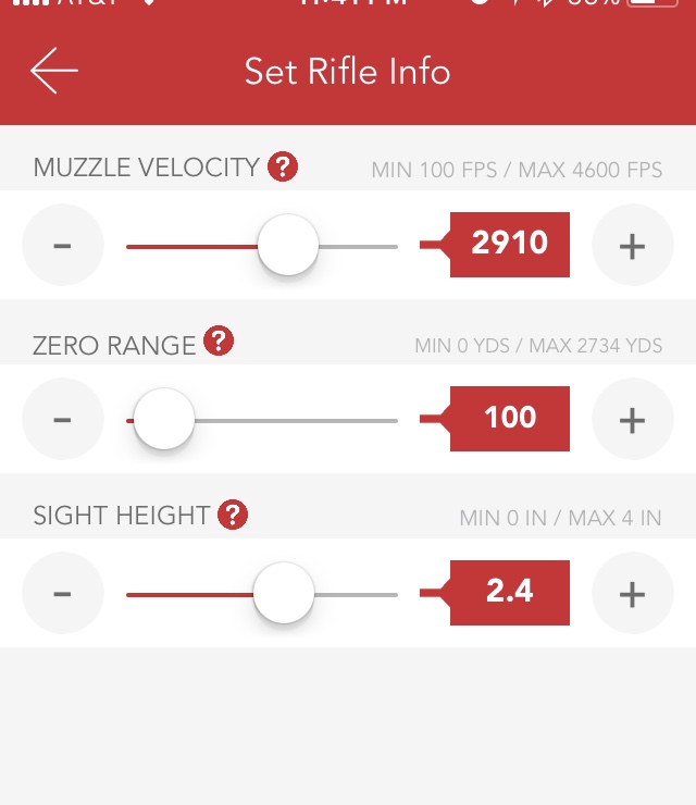

Add rifle // load data
Save and click “Select” to load the rifle data into the solver

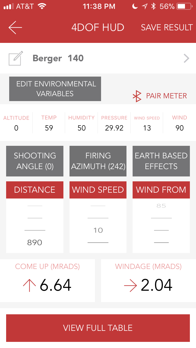

Change conditions and used the slider wheels to change distance and wind

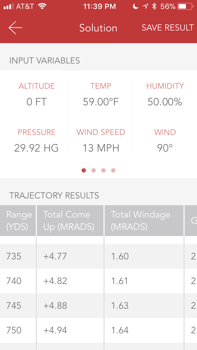

Click on view full table, enter resolution then the table will be displayed- scroll down and left to right for more info
