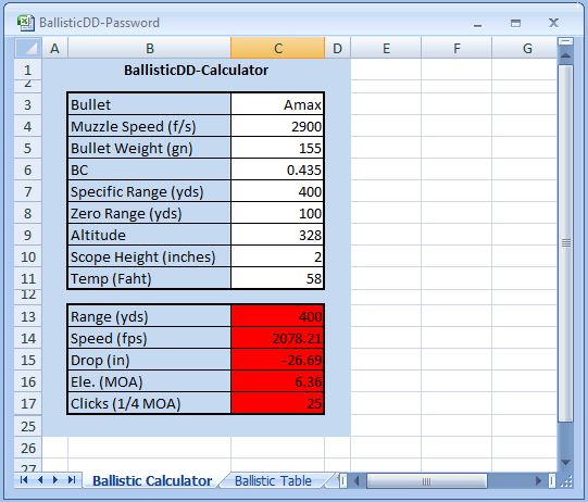

Now I already have Strelok on my Android phone and I love it, but I wanted something for my tablet, so I built one in Excel.
I have used Excel extensively (building Actuarial Rating tools for the insurance company I work for) but one draw back of the Surface RT is its ARM based processor, thus it's version of Excel can't have macros or vba coding.

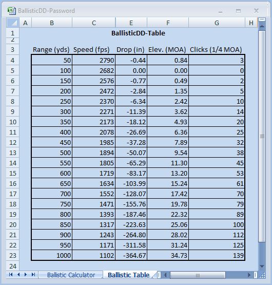

Side stepping this, I created a formula based spreadsheet that has user input (the white cells in first picture) and a quick view drop chart for a specified distance (red cells in first picture) and a drop table in 50 yard increments (second picture)
The only cells that can be modified on the sheet by the user are the white ones (so formulas don't get messed up by accident)
