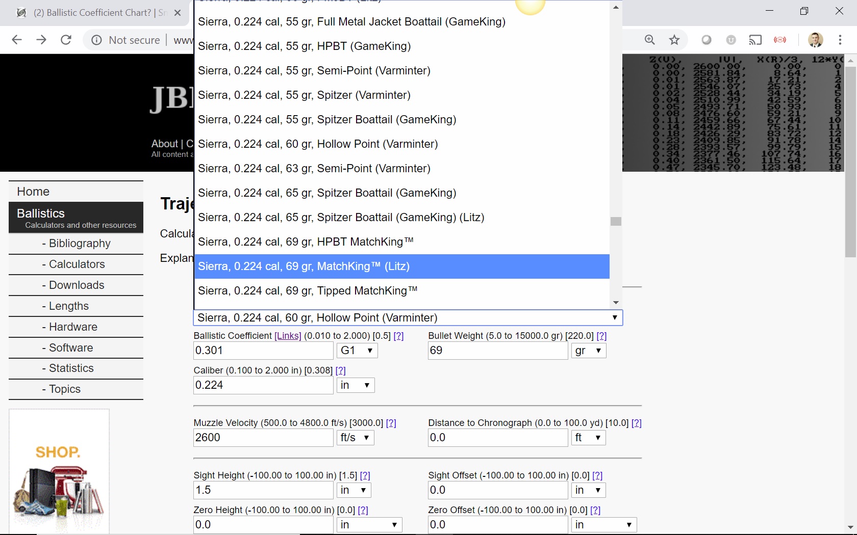

JBM Ballistics click that link and then put in your parameters and click calculate at the bottom. this will show you the BC for the various velocities. Always use the Bryan Litz BC if available his are the best. Also most of his books have lots of bullet BC's in the back appendix. Remember the seller's advertised BC may not be entirely accurate.
