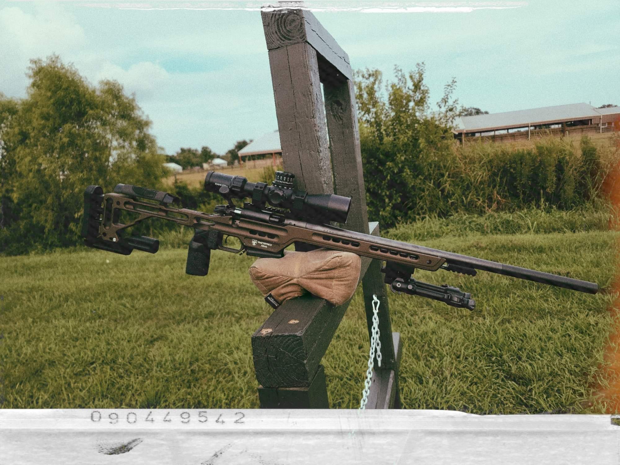

FYI I'm shooting a Bergar B14

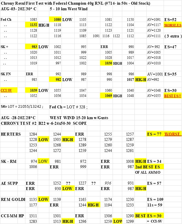

AND I did a chrony test of several ammos back in 2022, that showed those days the CCI-SV and MMs had the best ES out of my Sav B-22 ->

In the same month I did the chrony tests of Post 21, I shot some 100-yd targets with that Sav B-22 w-CCI-SV and got a 10-round low of 1.550" and avg 1.651 of 30 rounds. I didn't have the chrony set that day. Also, last Oct-2023 I shot those same targets and ammo w-only 5-shots per bull. I got a low of 1.242" and avg of 1.633" with 4-bulls and a temp of ca 60*F. Finally, back on Sept-30-2023 I shot my CZ-457 VMTR at 100-yds with SK Flat Nose SV. Using 4 bulls and 5-shots each I got a low of 0.896" and an avg of 1.173". The temp was ca 70*F and under 5mph breeze in my face. Again no chrony, I just rely more on performance altho back in '22 the Flat-Nose did have a ES of only 35. As for accuracy with the CZ 457 & 455 I've found SK-Rifle-Match or SK+ generally better than other ammo excepting the FN. And I'm on my last 150 of the FN and it's now out of production.
