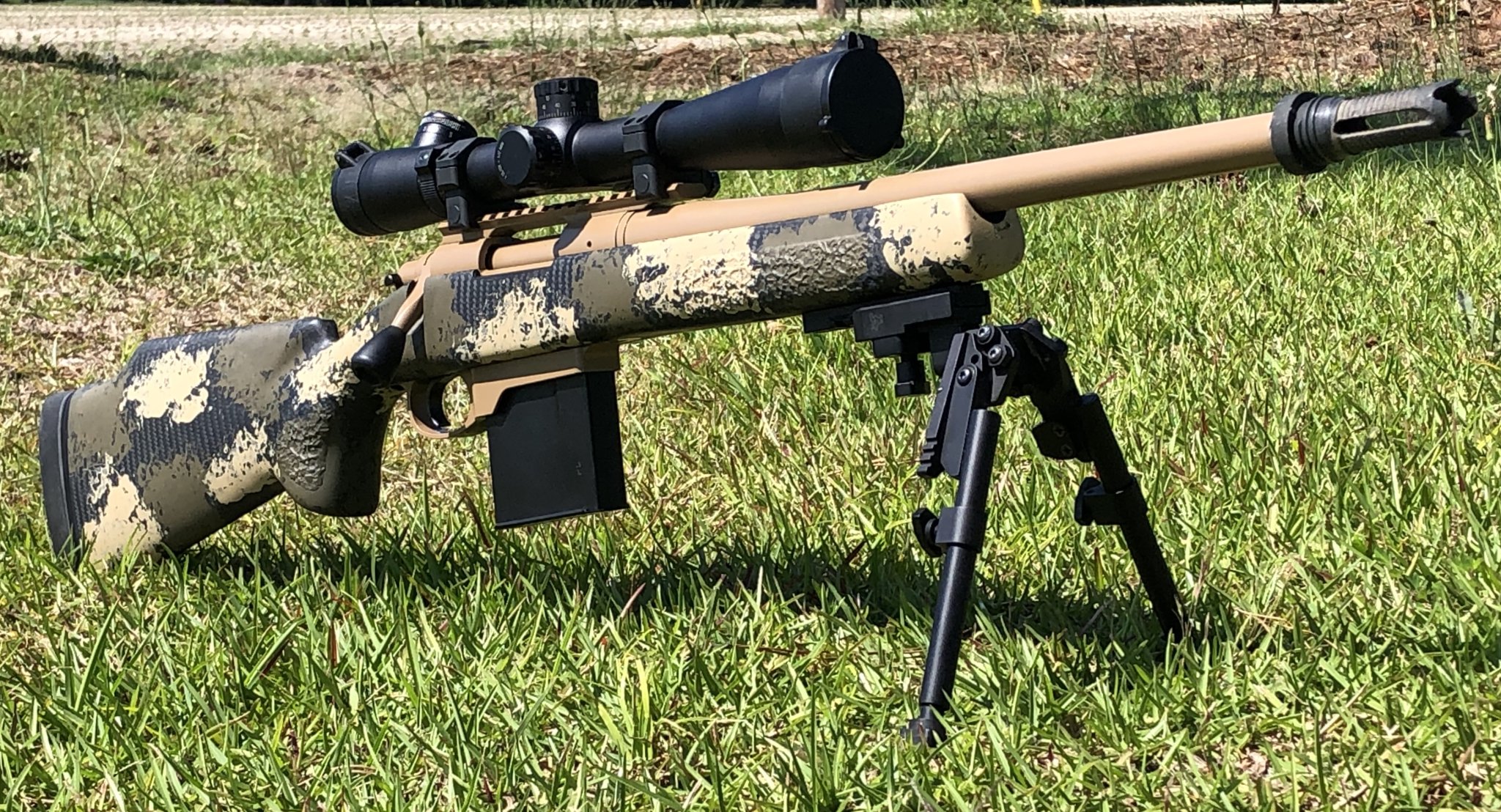

I built a 5.7x28 bolt gun. It is a blast to shoot.

Rem700 SA, timney trigger, shileen 16in 1:14 SS barrel, manners stock, Leupold mk4 2.5-10, Badger rings, sitting on an old set of GG&G bipods. Usually wears a YHM SS Phantom as well. Launches 40g pills like magic for a tiny baby round. I’m getting right at 2300fps with a mild load of autocomp powder.

Very cool. Would love a bolt gun in 5.7 to go along with the SBR’d PS90

Why a 5.7 over a .223? Just curious
Just to have something different. Same reason I have a bolt gun in 338 Spectre. I have all the normal bases covered when it comes to guns, so some oddball ones here and there keeps range trips interesting. Plus, it’s a great size for tinkering with different loads as it doesn’t use much powder.
I reload 40gr VMAXs over Autocomp for my PS90 and get an extra 100fps over the factory stuff without even getting close to max load, but still only burning 5.4gr of powder. Makes a pound last quite awhile:)
A buddy and myself built ours based off a conversation we had one day. Kinda started as could it be done. I built mine off a 700 frame, and he built his off and model seven frame. He went longer barrel with a slightly faster twist. Kinda fits in the reloadable 22 mag category IMO. I’ve shot this out to 400, but it gets wishy behind so small and relatively slow. Bottom line is we answered the question of could it be done. It just turned out to be a lot of fun to shoot really.
