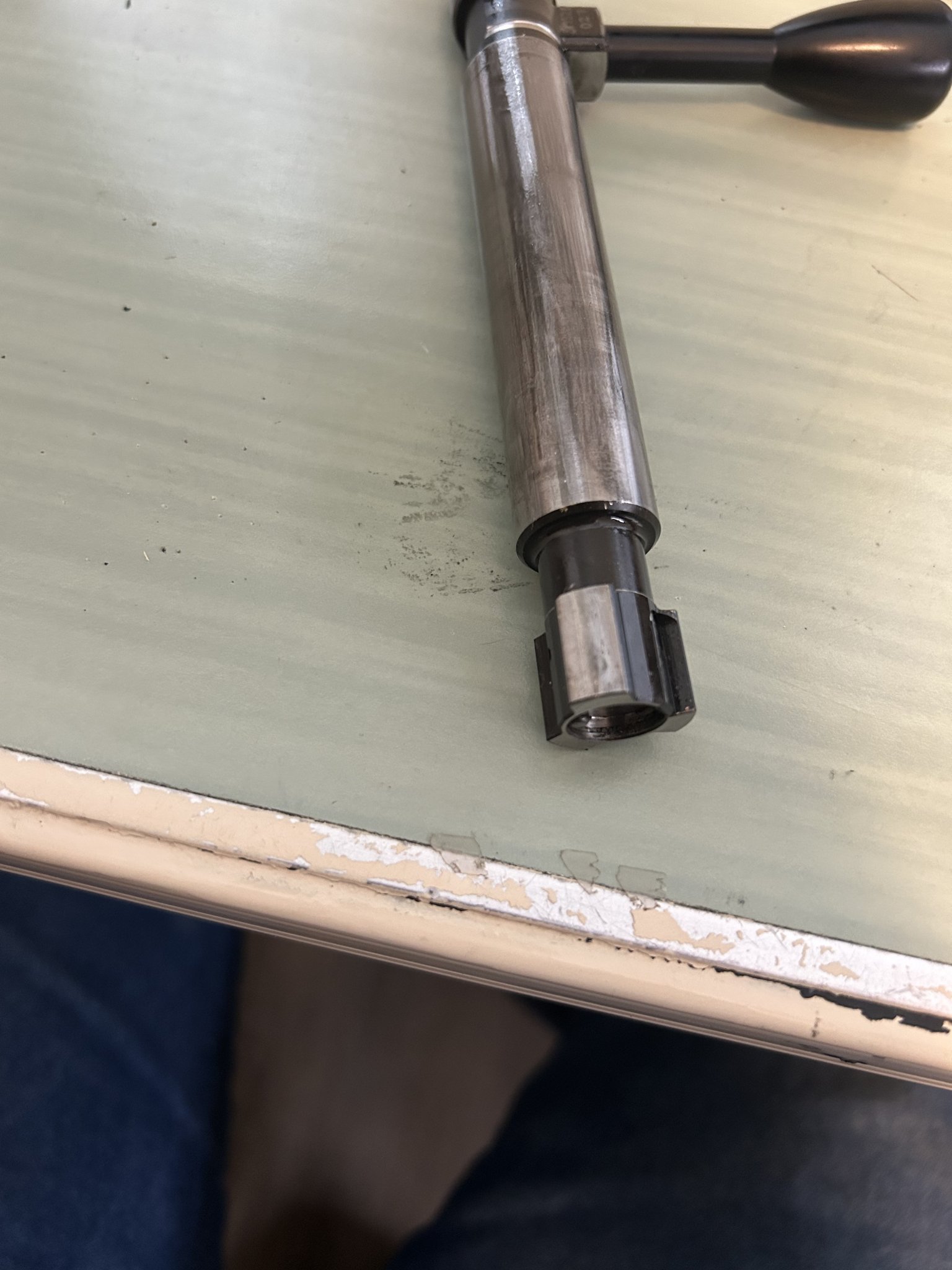

Secondly, I kept having feeding issues. The next round would get caught on the bolt body at the relief cut when closing the bolt, I had a hard time figuring this out bc I figured it was a magazine problem. The fix ended up being fairly simple- just using a Dremel and sanding/polishing the shoulder of the relief cut behind the 6:00 lug. Now it feeds flawlessly.

Secondly, I kept having feeding issues. The next round would get caught on the bolt body at the relief cut when closing the bolt, I had a hard time figuring this out bc I figured it was a magazine problem. The fix ended up being fairly simple- just using a Dremel and sanding/polishing the shoulder of the relief cut behind the 6:00 lug. Now it feeds flawlessly. View attachment 8008059
