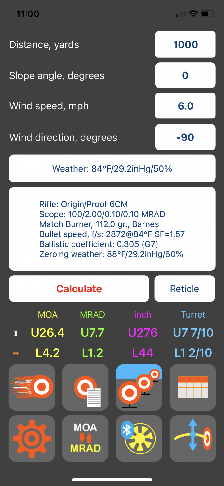

Needing a G7 BC @ ~2700fps
Its not an exact science by any means but g1 * .5 = g7 is a way Ive read over the years to short hand and make a decent ball park guess. Some bullets it works out to a higher or lower ratio but they all seem to hover around a ~.49-.51 ratio
So in example .624*.5=.312 which actually works out to not far off from what canezach said he uses in his experience.
I’ve heard of and use G1*.5=G7, but I’m not sure how’s consumer grade G1 lends itself a G7 conversion for use at 1K
It will be close enough to spot the miss in your scopes field of view and correct/true it up from there.

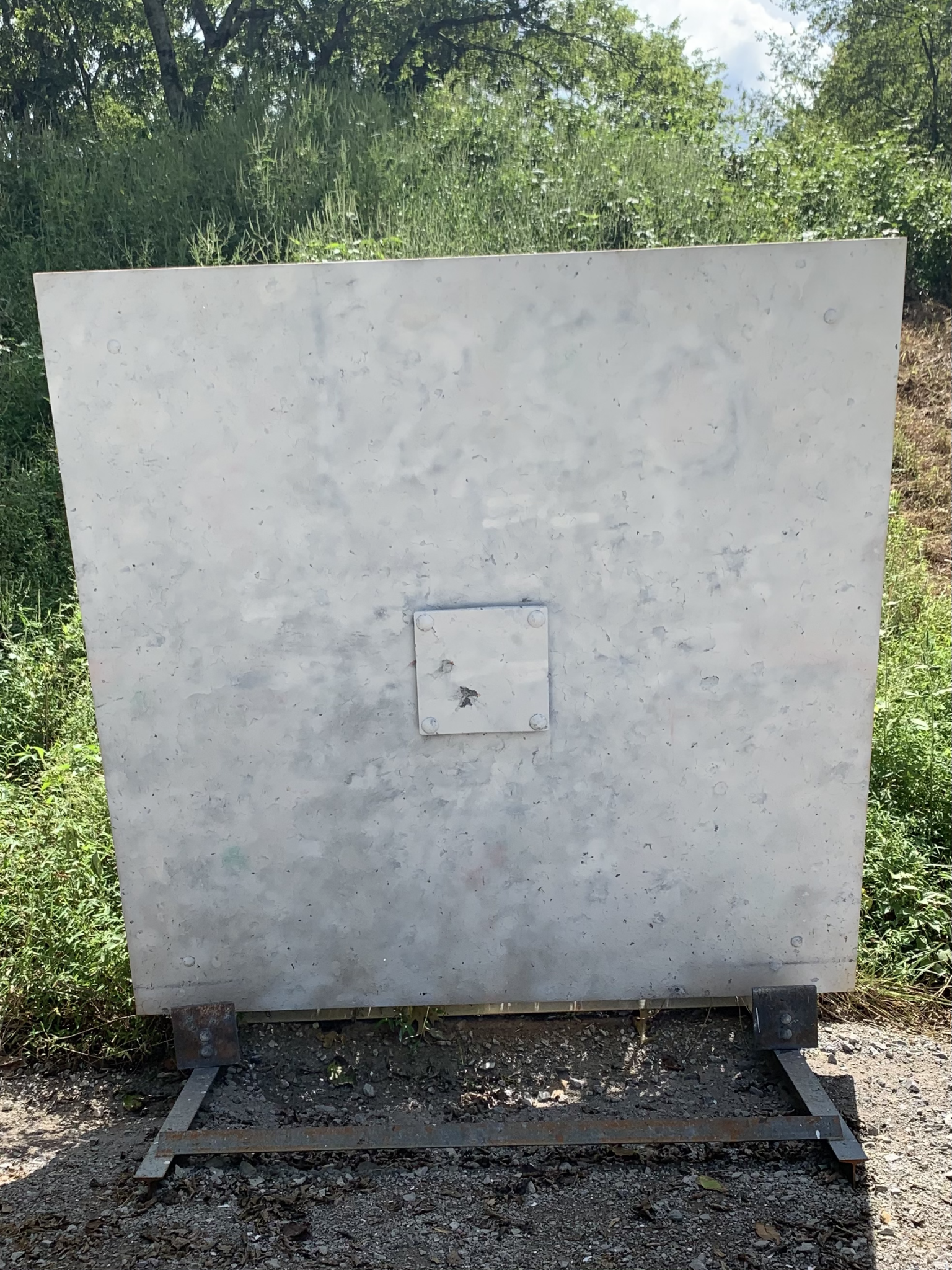

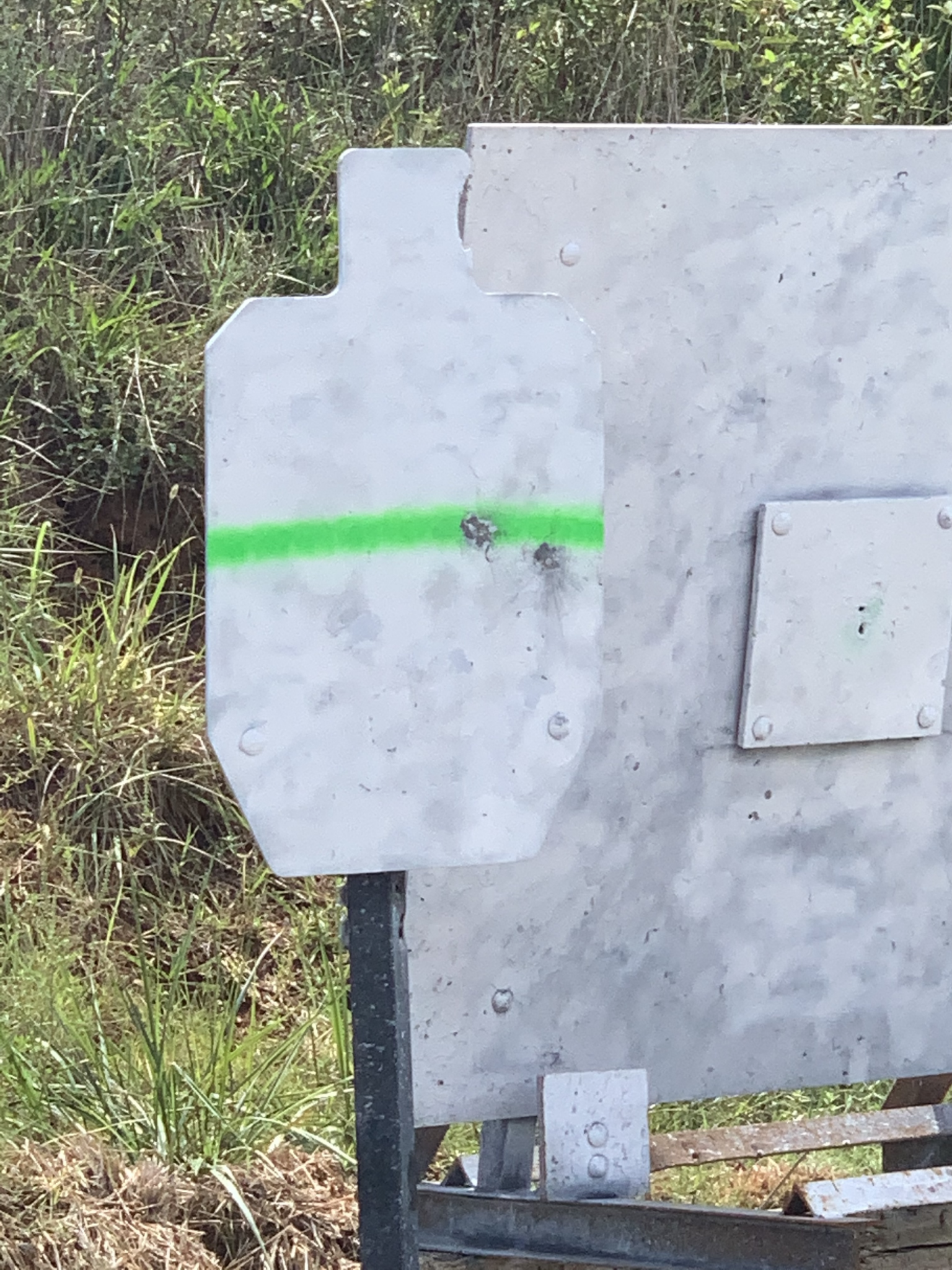

From yesterday:
@750 yards:
@1250 yards:
