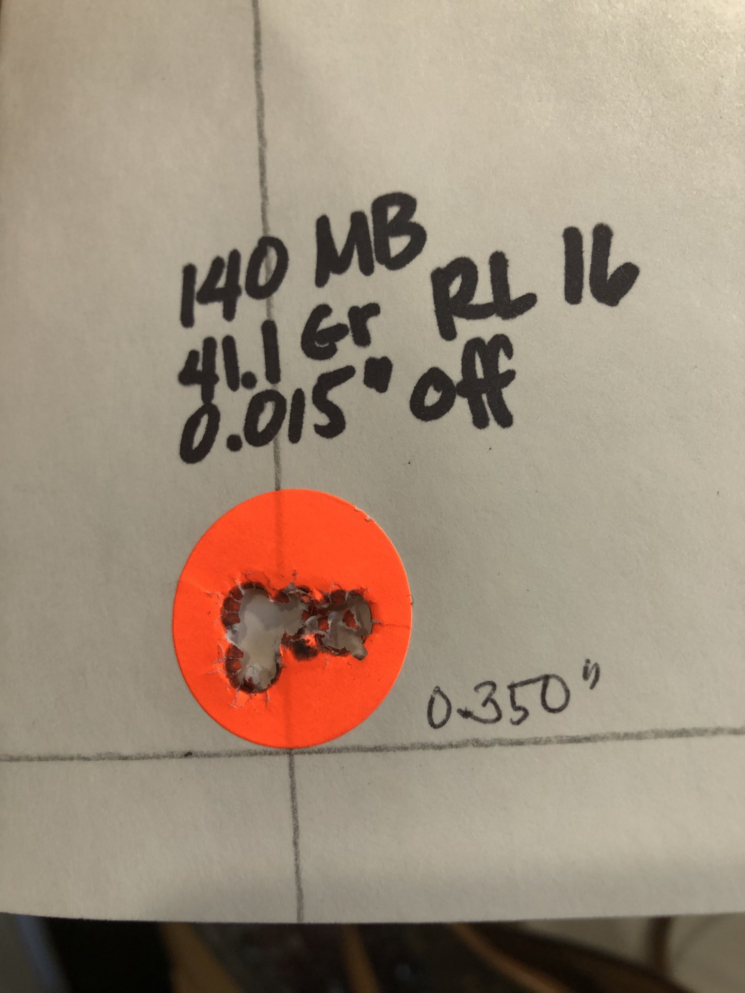

I just settled on a load for the hunters challenge next week with the 140 burners. My match load is a 130 eldm but couldn’t really make power factor which is how I ended up with the Barnes. Once I found a good speed node I played with seating depth all the way out to a hundred thou. .015 off was the best, nice tight groups, seems like a good bullet.
