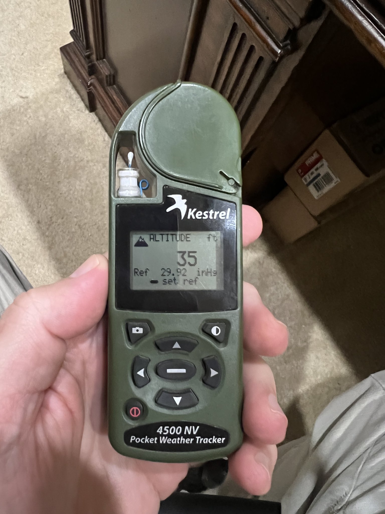

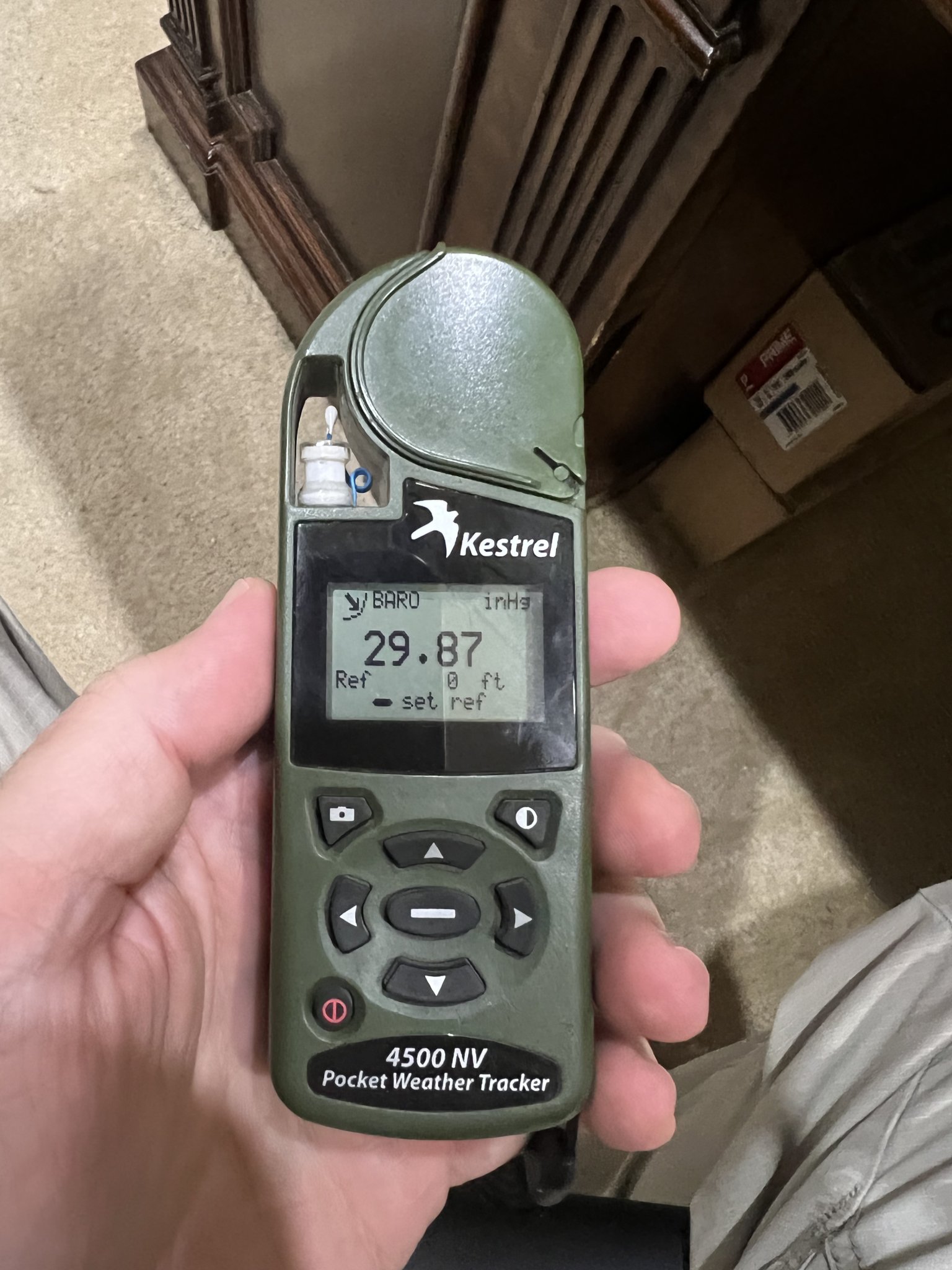

I just happened to have a 4500 sitting here. This is how it should be set
Reactions: Andrew863
One more question do I need to turn the sync alt off? If I don't when I set the BARO at 0 then set the alt ref at 29.92 it will change the BARO?
yes off. But the alt screen is meaningless honestly when using station pressure. If you had it set up where you are using barometric, corrected, pressure it has merit,
But yes, turn sync off.
and on the altitude screen turn sync baro off.
