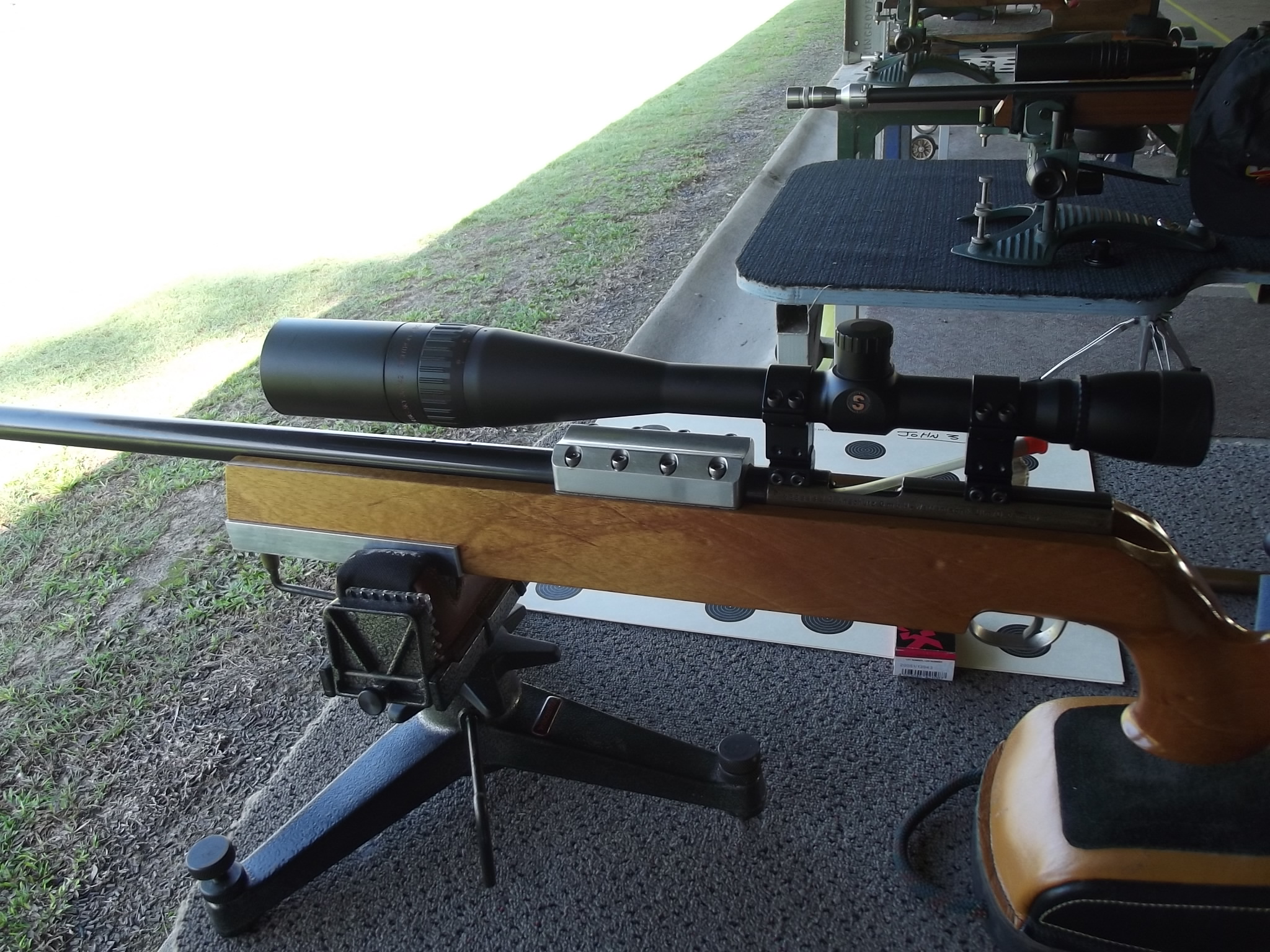

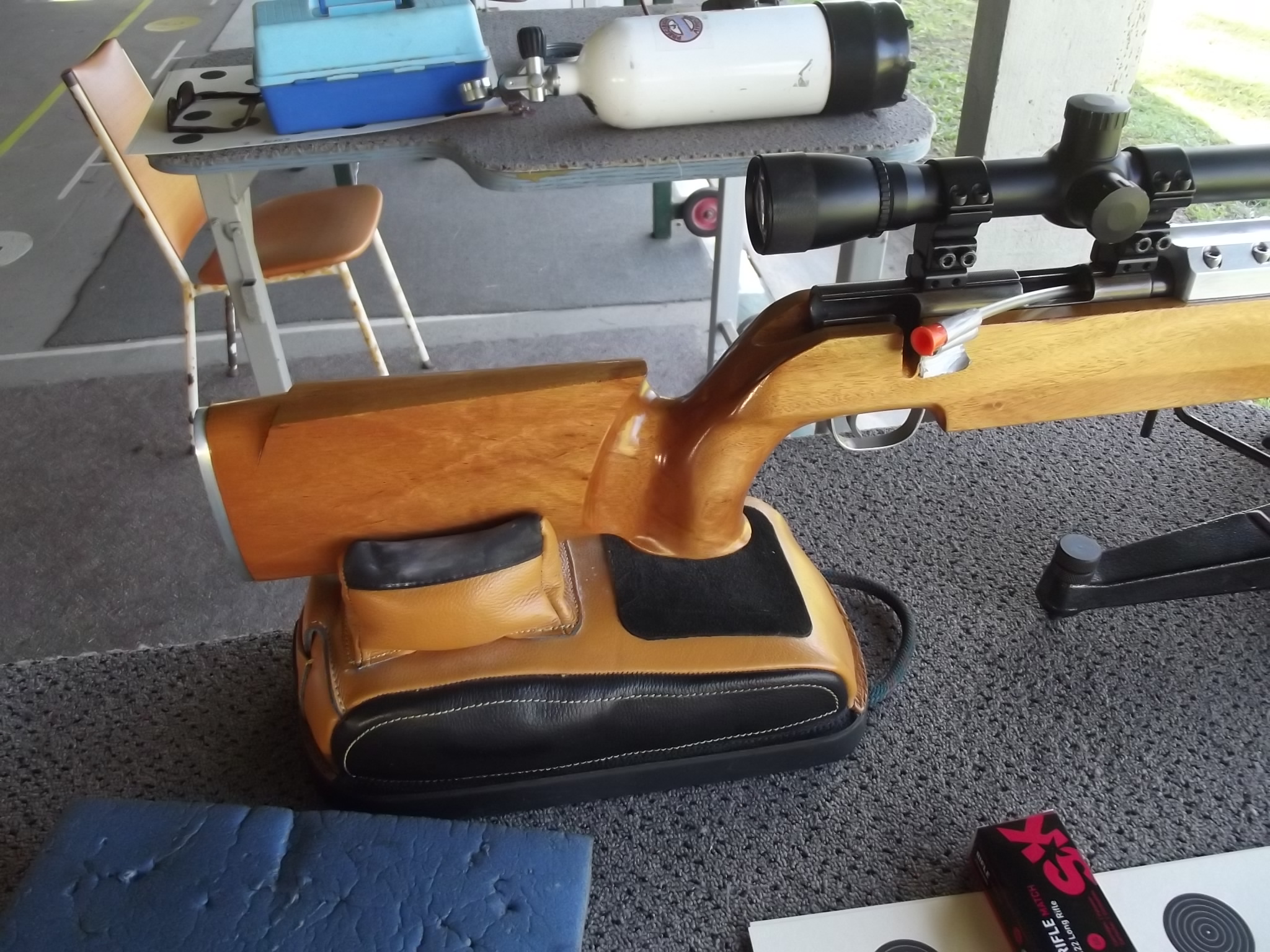

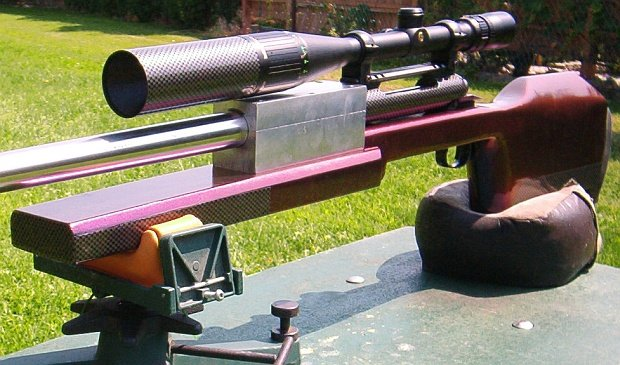

The Fuglie and SOF are only held in place by the steel plates and leather pads.
Receivers are not attached to the stock/block, only the barrel provides support.
The result is a minimum of barrel resonance/vibrations.
The accuracy is dependent on the skill of the shooter and ammunition quality,
when the Lilja bull barrels are installed.
The 3rd picture, with the purple stock, is the 6.5 Mystic.

Yes, accuracy did improve.
Heat is not a factor with the 22lr.
With magnum rimfire, I have to watch the temperatures.
Shoot 5, take a break until the barrel cools off.
The Fuglies produced better results than the free-floated/receiver mounted setups.
Was it the extra weight/stability? Elimination of stock flex? Dampening of barrel harmonics?
I think all three factors helped.
