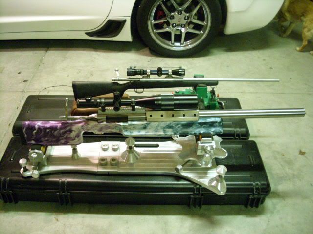

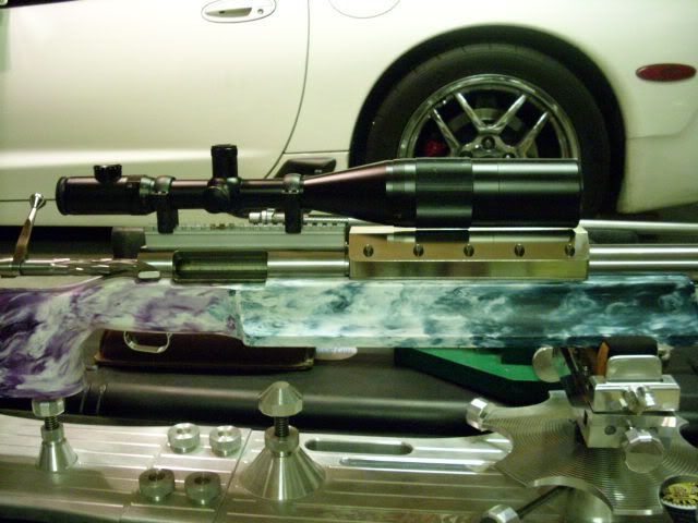

Sorry for the busy picture, it's the only close up I have showing the block.
<span style="font-weight: bold">Remington 700 LSS in background for some idea of size.</span>
-Rick
