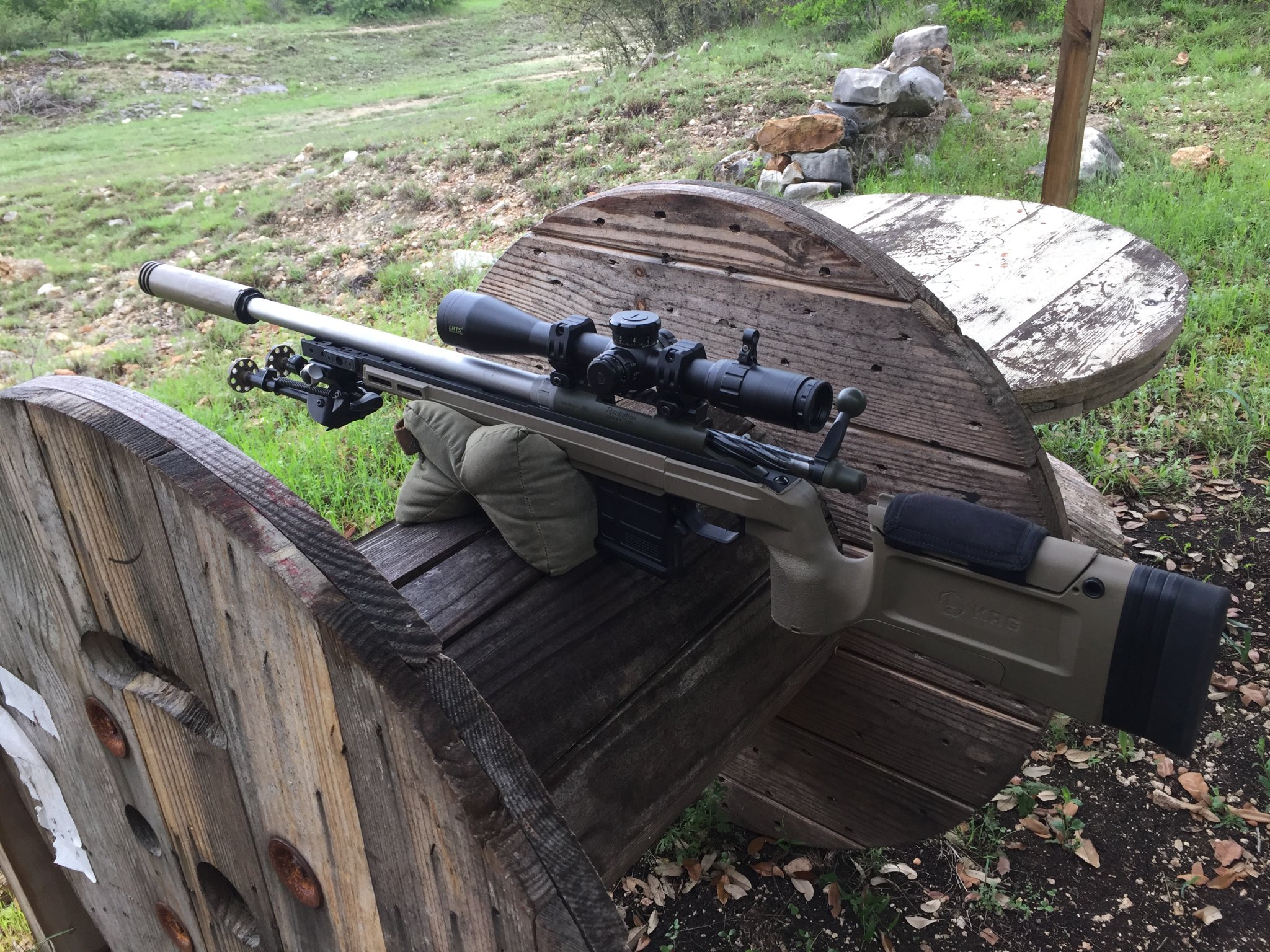

I just put together a general purpose 6-BR with a Proof comp contour with most of the heavy section removed. Finished at 22" and it balances nicely.
The XRS-1 is already off of it and I installed an XRS-2 last night.
MDT XRS stock.
Proof 7.5t in 6-BR.
Cherry bomb.
TT Diamond 2-stage.
MDT 10 round BR mag.
Kauger PRS action.
Bushnell XRS-2.
Harris bipod.
F-1 supressor. Not in pic.
It could end up in a Bravo. Time will tell.

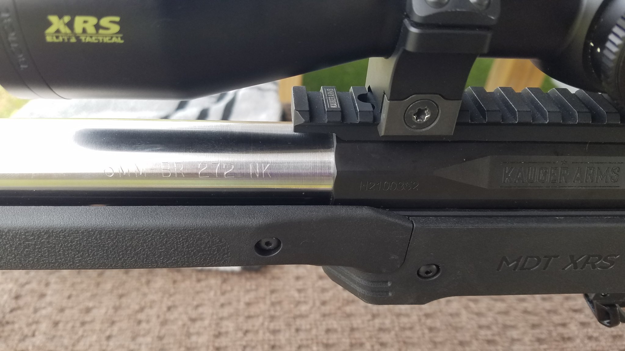

Prefit barrel by Archer Custom Rifles.
Notice the markings line up. Very nice touch.

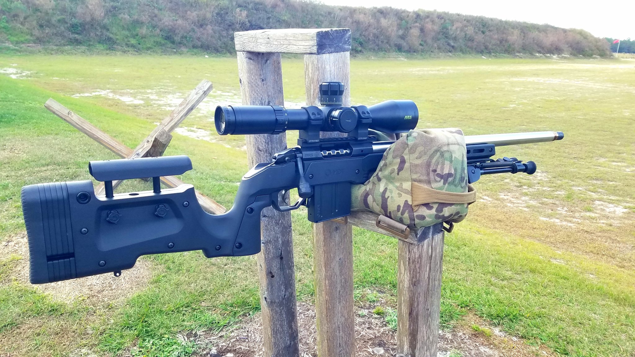

Any idea of the weight and how do you think it would handle in a tree stand or off the back of an ATV?
I’m not sure, maybe 14 lbs as pictured there with all that included.

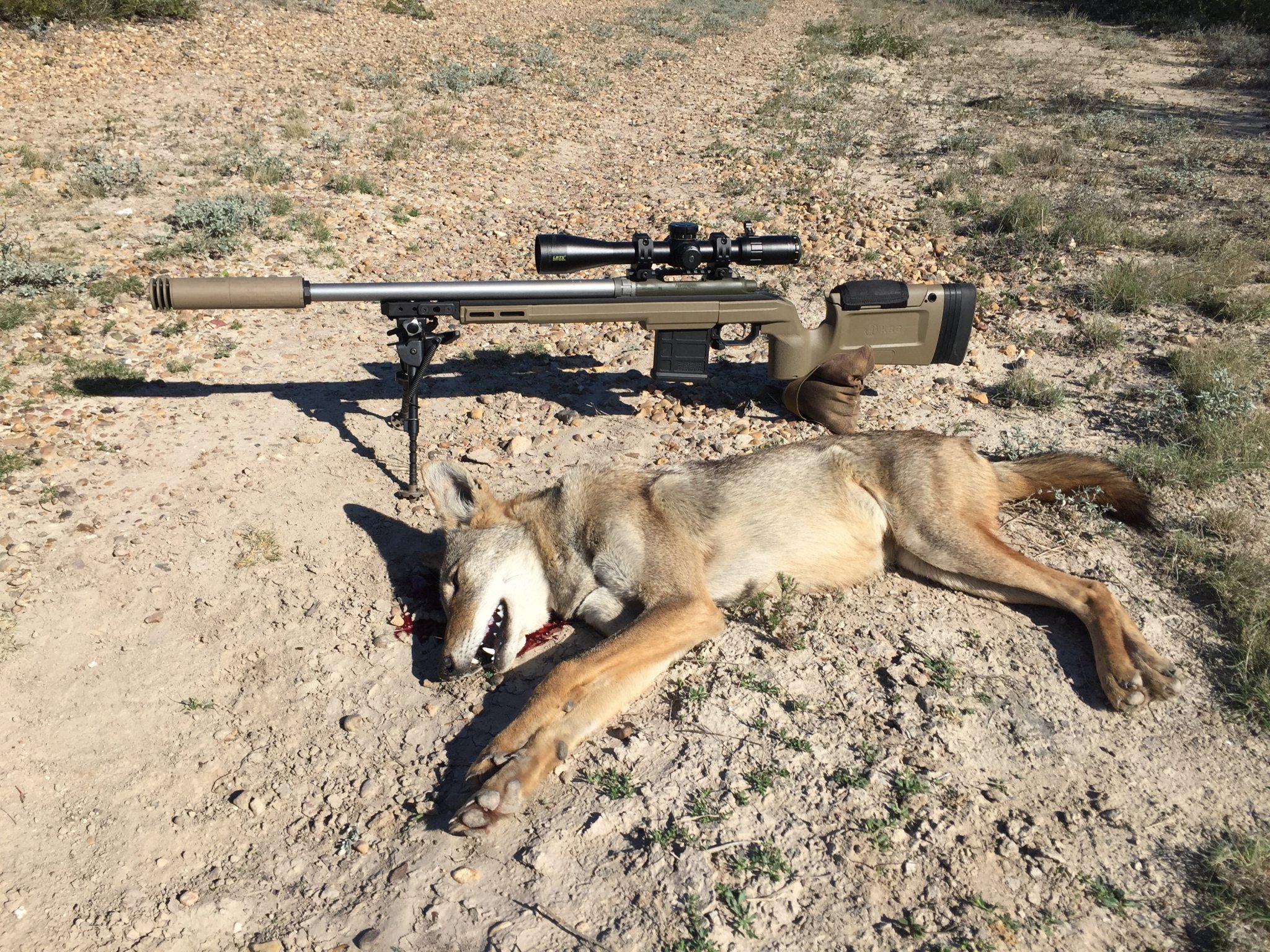

Both pics have an 18” 6xc or 6.5 creed barrel in in the varmint profile, can’t remember which was which now. It’s been a couple years.
I used it in a 4x4 box blind just fine. It’s not going to be ultra light but it’s compact enough and not overly unwieldy with the can on the end to preclude swinging it around at critters
