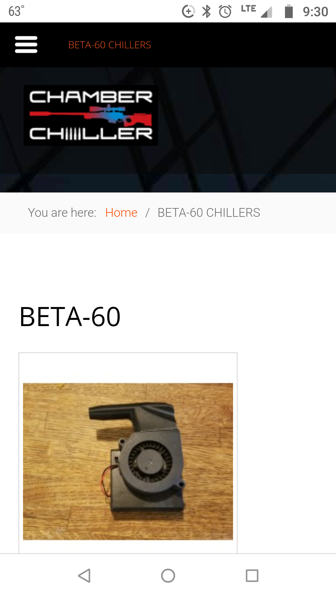

I've been using the chamber chiller for about 2 years and it works great. I have the original battery powered model and two of the USB newer units.
I don't actually use it during matches that much because we're moving around and doing other things. But many guys do use them especially in the summertime.
My favorite use for it is during load development and range sessions especially in the hotter months of the year. That allows me to shoot and get done what I need done without as much waiting in between. that means more time at the reloading bench or with family or whatever have you.
Many folks talked about barrel life being preserved, accuracy, etc but for me the main benefit is limiting the time I have to spend testing loads at the range. You can buy on Amazon for about 40 bucks.

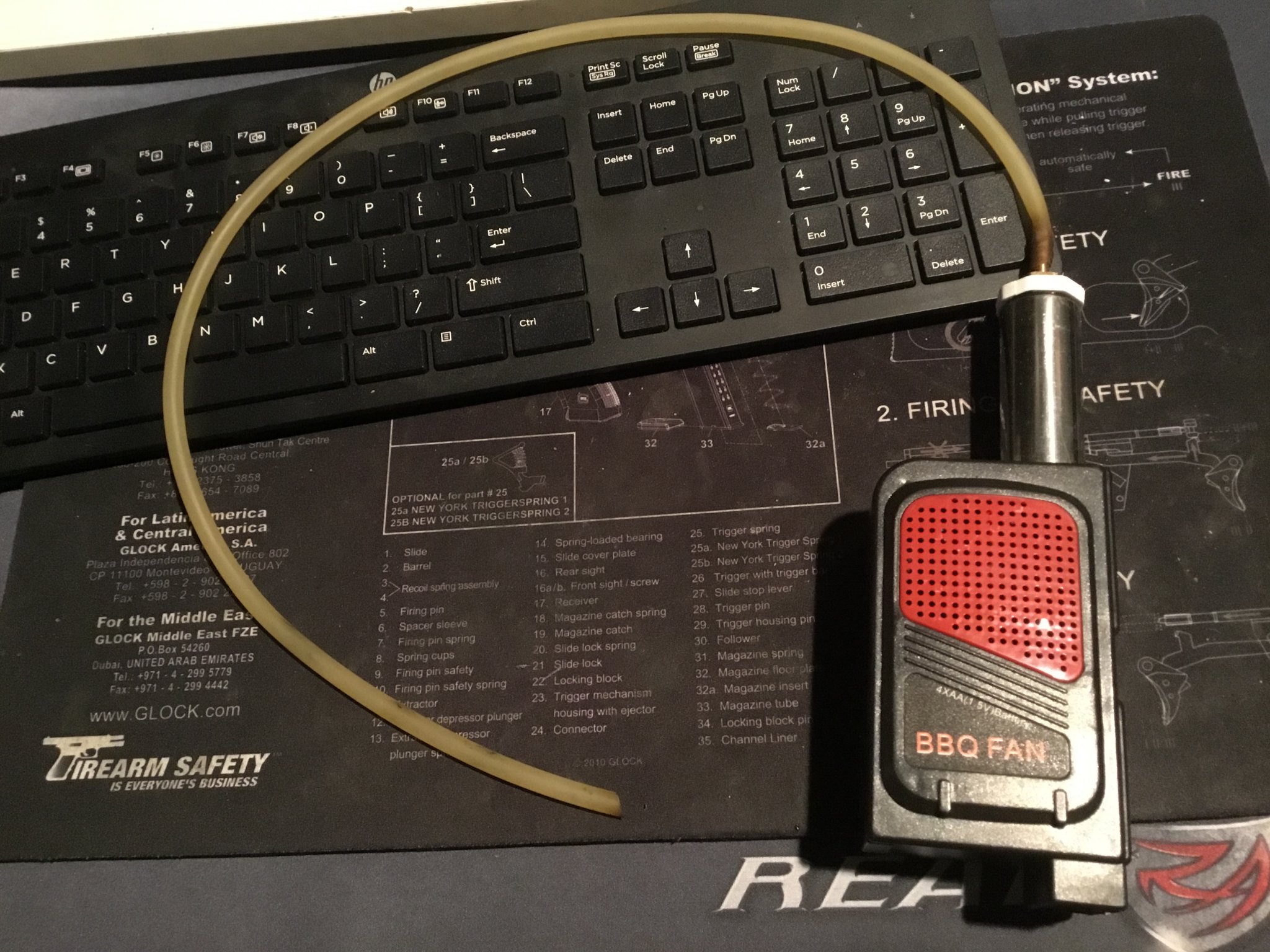

Have been using air mattress inflator for couple years. Long before the purpose built coolers came to market. They do work when it's hot weather. Shortens time for Barrell to cool. Just drains batteries is down side.
I used a leaf blower on idle to jumpstart the coals in the Webber, but I did it in front of acquaintances and it embarrassed my wife (who likes to pretend I’m not a hillbilly). This think showed up in my stocking next Christmas. Two $2 fittings from the plumping aisle, and some surgical tubing (always keep a bunch on hand) and I has a perfect barrel cooler.
I don’t use it that much, but it works great. Probably $10 total.
