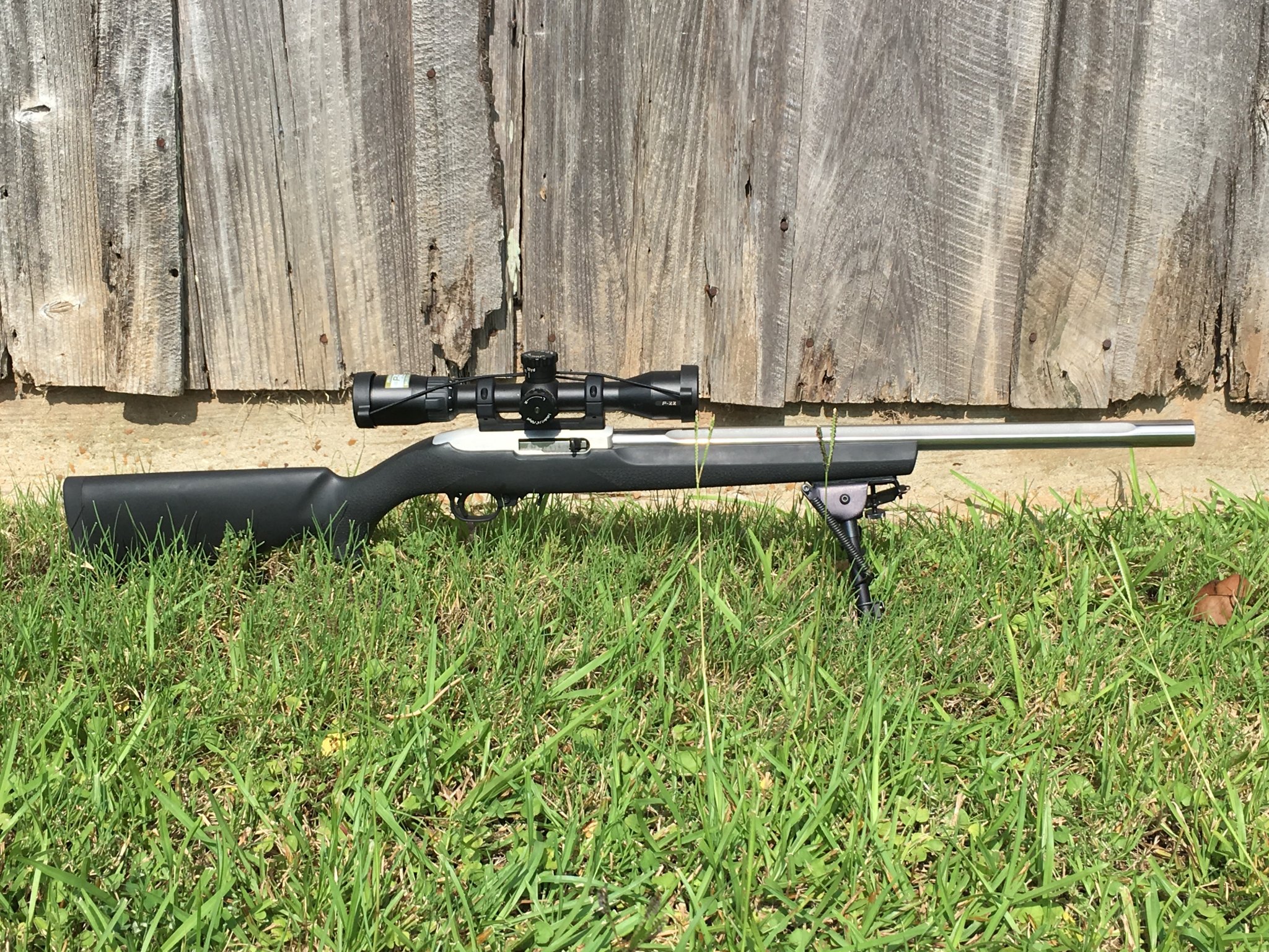

The only fluted barrel I have is on my Clark build 10/22. I would never put them on a larger caliber rifle.
