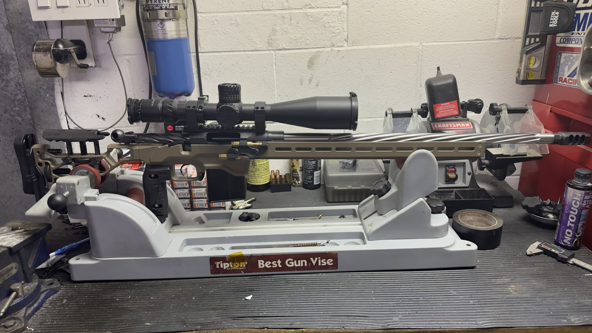

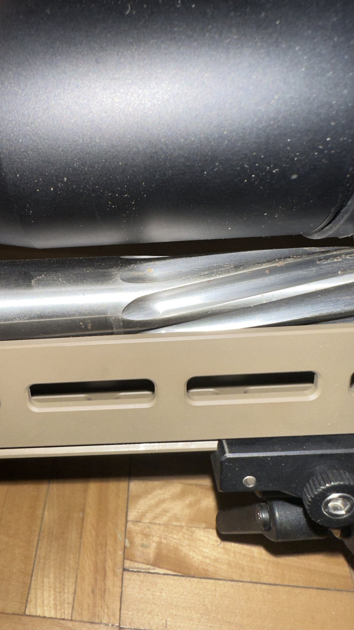

    Are the tool marks usually an extra charge or did I get lucky and get them for free?
    Usually the flutes I see (and the total of two I own) are “cleaner” in the flutes.
    So…should I say something to the shop or just pretend this one is extra special custom?

    Having worked in machine shops basically my entire adult life (42 of my 60 years), and being a ASQ (American Society for quality) certified mechanical inspector I’d call them on it. Those are some heavy duty tool marks. Hell Stevie Wonder would have caught that before it got thru final Inspection. The machinist ( button pusher with modern CNC equipment) should have said something before it got to Final Inspection.

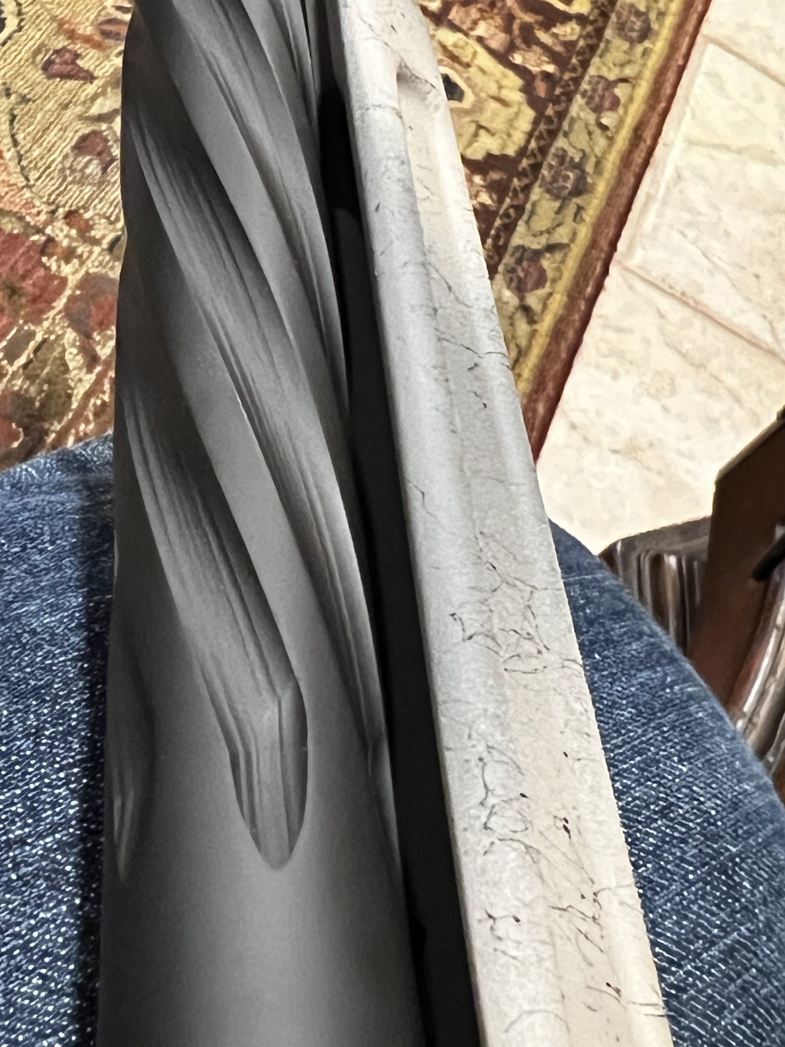

    I like this line. I get more frustrated every time I look at it. I guess I’ll reach out to the shop, but I’m not sure what to ask for since it probably can’t be cleaned up and I don’t really think it is reasonable to demand an entirely new barrel. Maybe a discount on another one? I don’t want flutes again given the work quality here.

    Honestly, I think it looks sorta cool. Are the ridges even in all flutes?
    Yes. That’s why I assumed it was tool marks from a worn tool. It isn’t obnoxious just not what I expected.
    It's the hockey stick starting angle that throws me for a loop.

    Yeah the off angle at the start would bother me more then the flutes.
    Most of the fluting I’ve seen starts straight and then angles. Partially why I’ve never had flutes on barrels except one I had done for my Barrett to try and match the OEM look.

    This is not a Bartlein blank, and I don't think I'll share where it came from because I'm not looking to drag anyone down. I didn't feel like it should have made it out of the door, and things here mostly confirmed that. I'll reach out to the shop to see if we can find some middle ground. It is a button barrel, not cut, so Frank's post doesn't give me tons of warm fuzzies but if it shoots, it shoots.

    The photo on the webpage shows much, much cleaner fluting for both spiral flutes as well as straight flutes.
