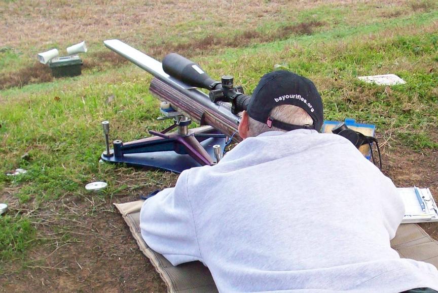

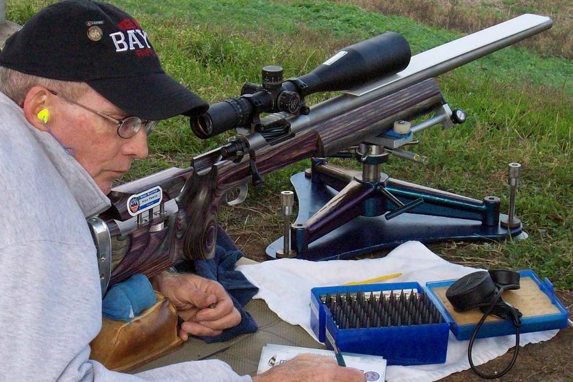

Here are links to a couple different styles commonly used by F-Class shooters. Firing 15-20 shots during a timed match will usually get the barrel hot enough to throw some serious mirage in front of the scope if you don't have one. If your barrel is black and it's sunny, the problem can be intensified. I use the Shotmaster windowblind slat type, but have seen many with the Champion's Choice as well.
Mirage Shields
Champion's Choice - Detail1 - CCMB20 - CHAMPION'S CHOICE BOLT RIFLE MIRAGE BAND (20") - Shooting Equipment - Champion's Choice
