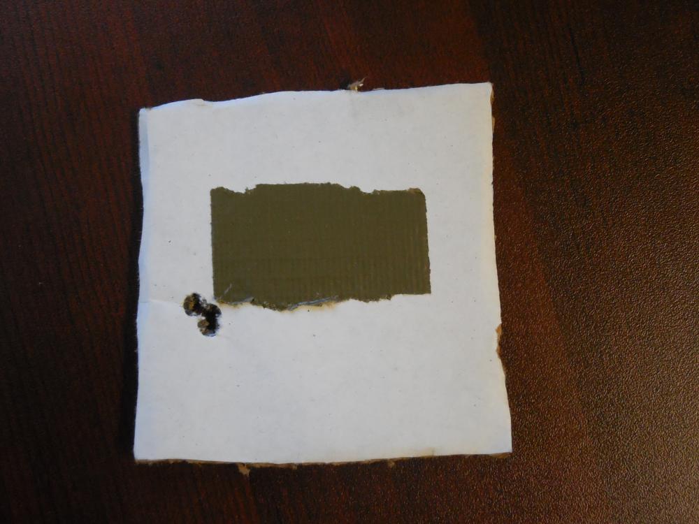

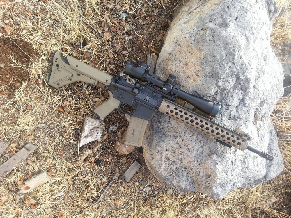

Here's a 3 shot group using Hornady 75 gr BTHP MATCH at 100 yds from the same TSD Tier 1 Recce upper I purchased. The Recce upper has the WOA 16" 1:7 barrel, Young BCG, Troy 13" rail, and BCM CH. Plenty accurate for my needs. This same upper makes easy head shots at 600 yds.
