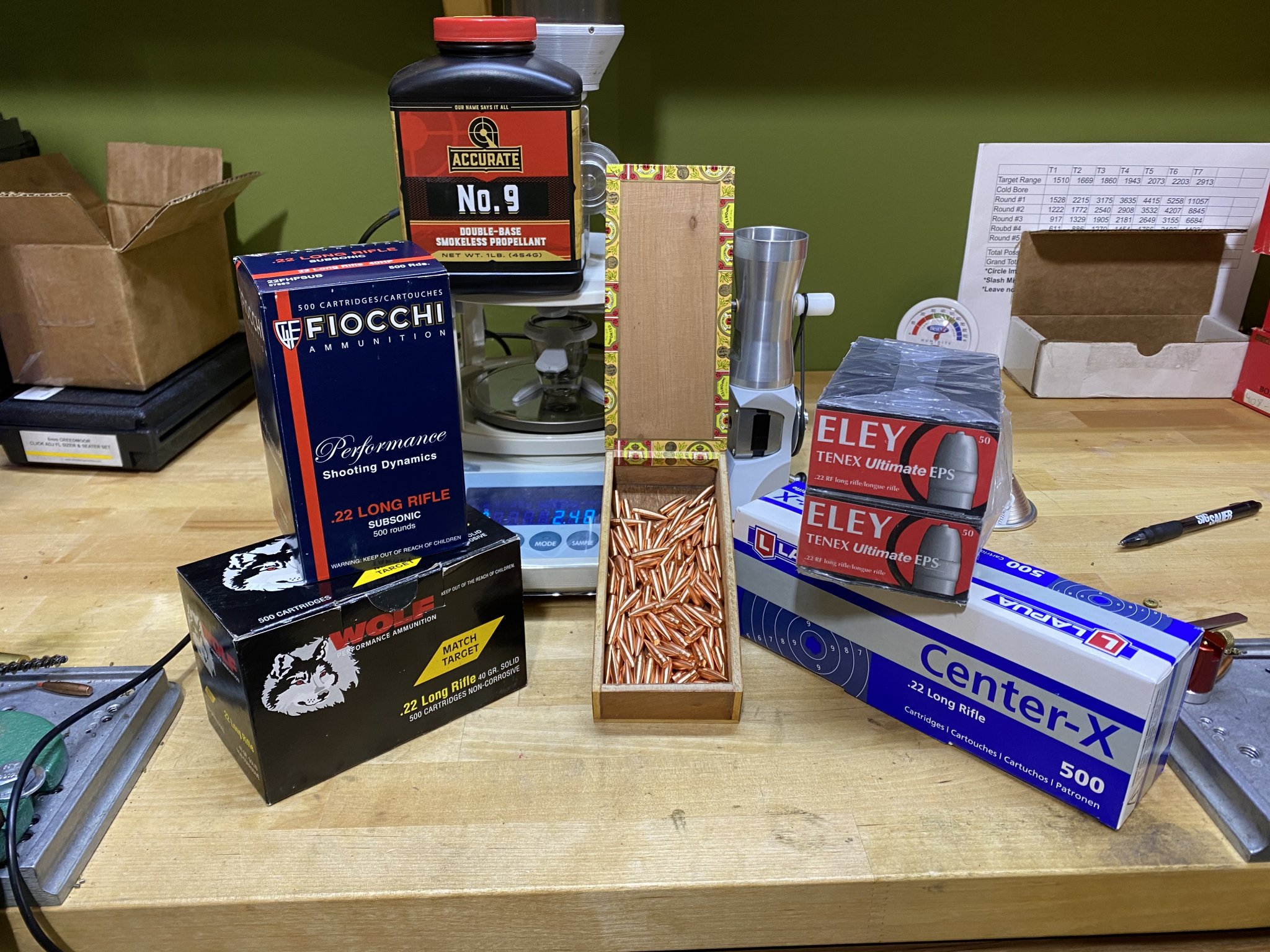

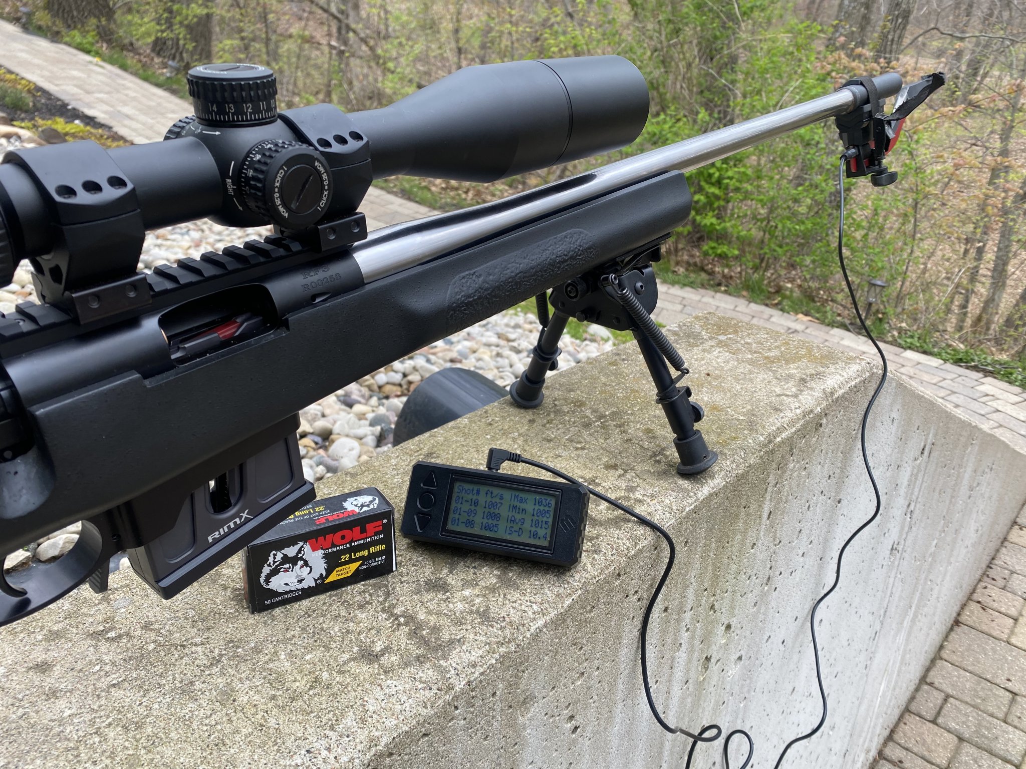

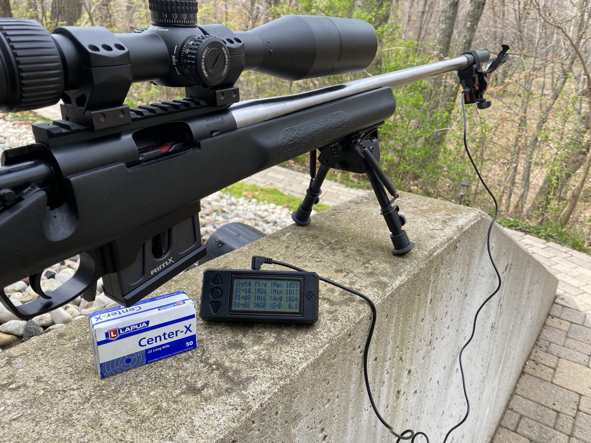

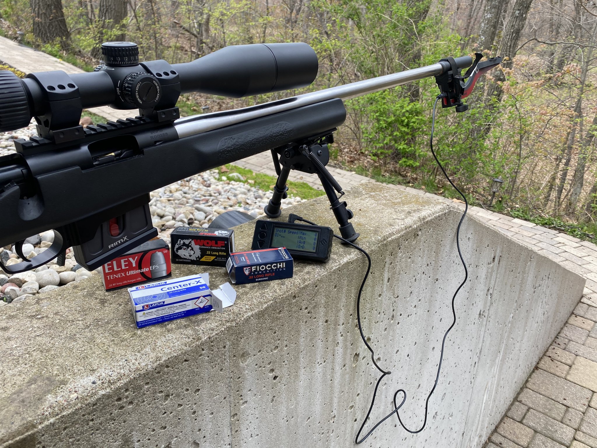

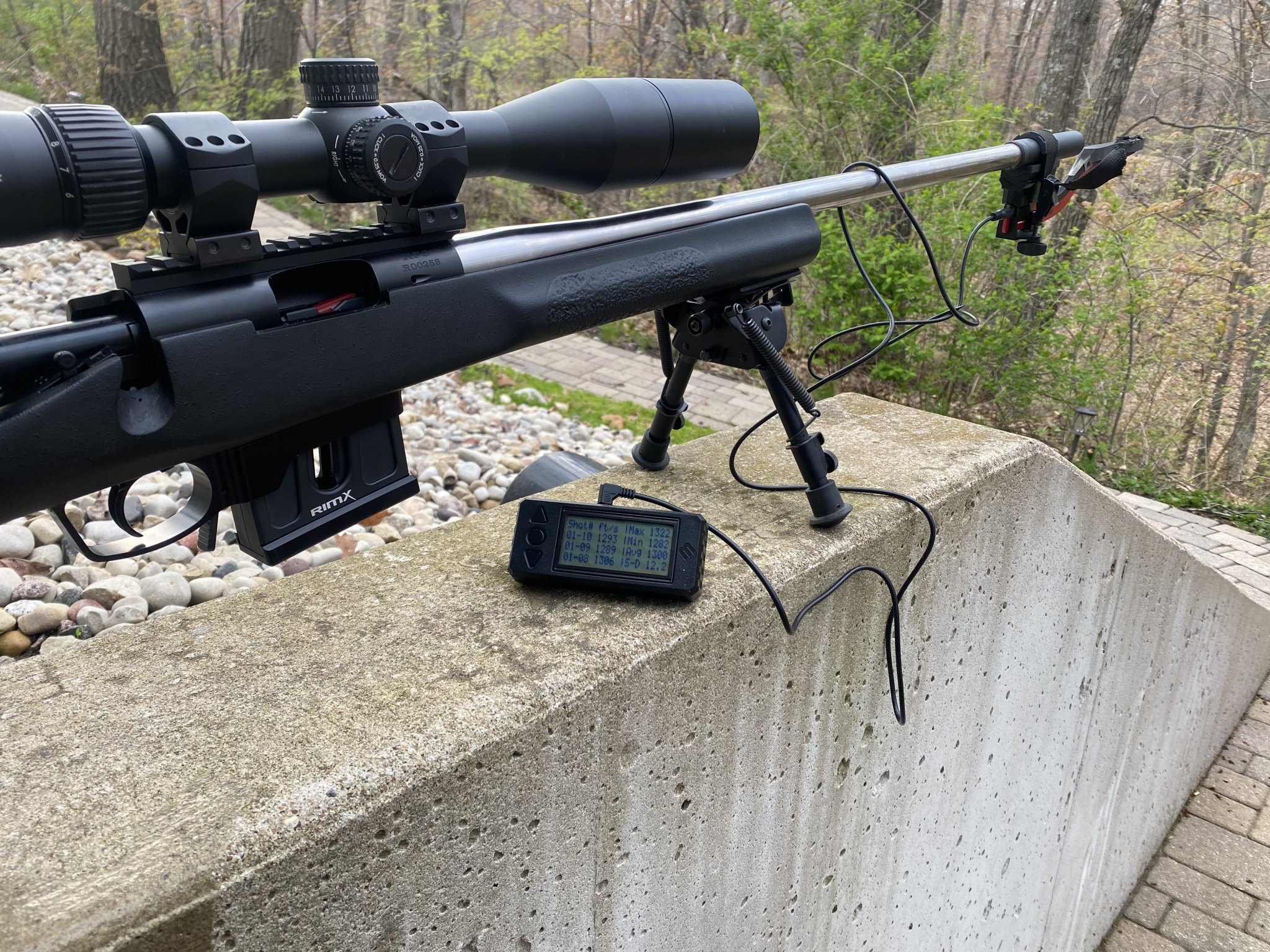

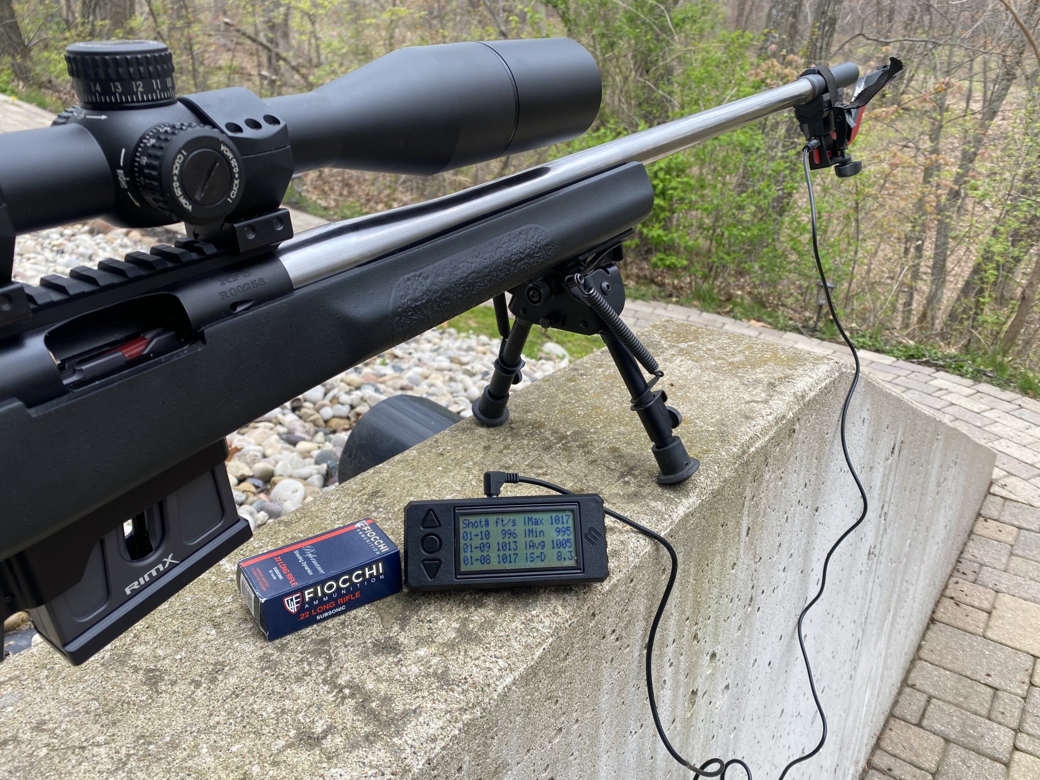

    Figured this is a good place to catalog the progress and information in the testing I’m working on. This is based on my copper solid bullets/load testing, but, figured while I’m at it, I’ll do conventional lead ammo as well. Starting with a 27” .217/.222 1-5.75 twist Bartlein barrel. Going to find a safe load with the copper bullets and run strictly speed testing. I going to chop off an inch at a time and see where the numbers take me. I also have a 23” barrel with the same specs and a 27” .219/.222 1-6.5 from K&P barrels. Plan is to only chop the long Bartlein first. If it’s found that a shorter barrel is better, I’ll possible chop the K&P to that length. Initially I’ll have numbers from the 27” for each though.
    Did the 27” Bartlein last night. Hoping to working K&P tonight or tomorrow and start chopping this weekend

    Looks like velocities down from a shorter barrel.
    My 18” with center x is about 1090-1100fps depending on lot.

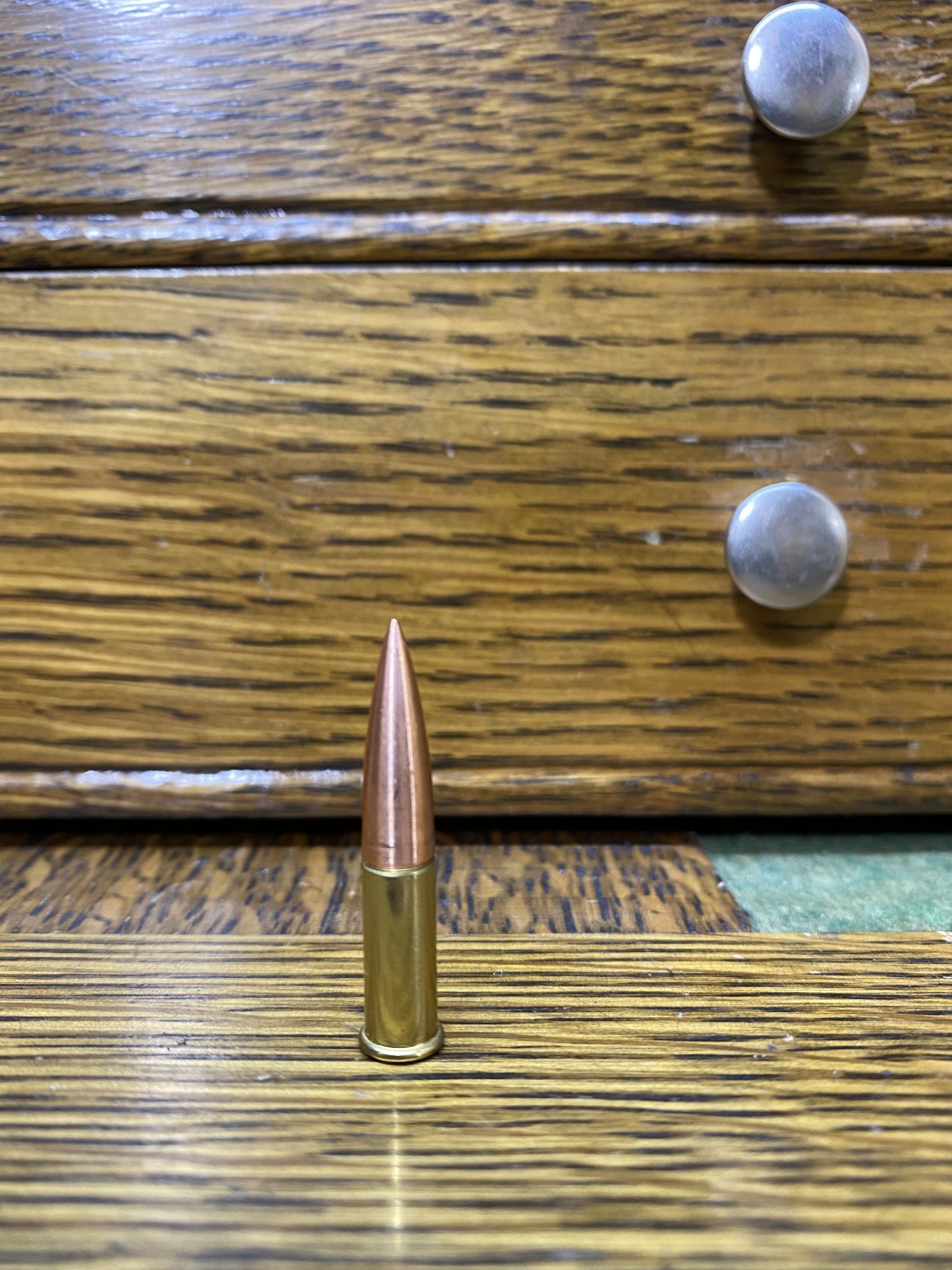

    Holy shit, didn’t figure you guys would get lost. This isn’t about normal lead ammo. Take what you’re thinking about and forget it. The sole purpose of this test is to find out where peak speed is with my handloaded, copper solid bullets. All the other info that will be provided, well, maybe not anymore, is just because I’m running this test for my stuff and is extra. What anyone concludes about it is entirely up to them.
    If you’re not shooting these then you’re not on the same page with what you’ve seen in the past or read on the internet

    I would never load these in a 16 twist. They’re isn’t a chance they would stabilize
