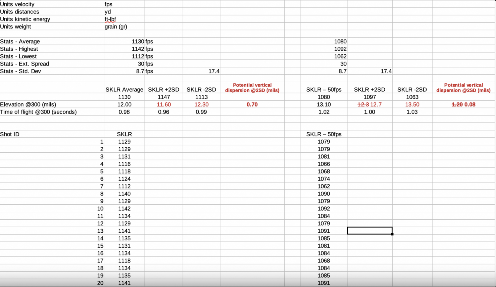

EDIT 04/19/2023: I think the table below demonstrates how it can matter. My original table had an error - see the strikethrough value in corrected table below; I had entered a wrong elevation. While there is a measurable increase in vertical dispersion, it isn't significant. END EDIT
Dropping velocity 50fps and adjusting elevation accordingly isn't the end of it - the lower velocity also increases potential vertical dispersion. It's been 50 years since college statistics. If my conclusion and supporting data are erroneous, I'm open to correction.
I mentioned Hornady centerfire test data earlier [in the thread from which this is copied]. It was correctly pointed out that centerfire and rimfire are two very different worlds. The commentary from Hornady's Jayden Quinlan I had in mind was this: the longer a bullet takes to get to its target, the more time external forces, including gravity, have to act on it.
So I grabbed a recent LabRadar series of 20 rounds of a new lot of SK Long Range Match (I haven't kept any large series of my Center-X, which was tested/purchased three years ago and of which one case remains). I replaced the static values from the CSV files with fomulae and started playing. I think I've shown that lower velocity, combined with standard deviation and distance, introduces wider potential vertical dispersion, and this potential dispersion increases as distance and SD increase.
So, I held distance and SD as constants and looked at vertical dispersion only:
- Shots: 20
- Distance: 300 yards
- Velocity: 1130 | 1080 fps (actual velocity | actual velocity-50fps; please also see note after the table)
- ES/SD of 30 and 8.7 respectively for both velocities (calculated, not assumed)
- Elevation values from StrelokPro for my Vudoo using Lapua drag curve
[Correction: the red text labels below should read "Potential vertical dispersion increase at lower velocity (mils)"
So - same bullet, same everything except velocity difference of 50fps shows a potential 0.5 mil increase in dispersion at 300 yards (1.2 mils vs. 0.7 mils) at 95% confidence level (two standard deviations). That's about five inches - and the potential dispersion increases as velocity drops (going back to Quinlan's comment about gravity over time). Comparing 1080 to 1030 fps - which is close to what I actually observed but did not record with my Center-X in Vudoo vs RimX - shows a .9 mil potential difference(2.1 mils vs. 1.2 mils), or about 9 inches more potential dispersion at a 95% confidence level.
Is that enough to matter to you? [Shrug] Taking the confidence to 99.7%, or three standard deviations, ramps the potential vertical spread even higher.
I think this shows how lower velocity for a .22LR, within the realm of "normal" .22LR match ammo velocities, does indeed translate to measurable increased POTENTIAL vertical dispersion. If my logic is wrong, show me how. The bullets don't lie, but statistics might, or at least confuse (Example: A 95% confidence level may be stated as (mean +/- (SD*2)) - but in my example, with hard data, that translates to (1130 +/- (2*8.7)) = (1130 +/- 17.4) = (1147 highest, 1113 lowest, difference of 34 - which exceeds the ES).

I think the table below demonstrates how it can matter. Dropping velocity 50fps and adjusting elevation accordingly isn't the end of it - the lower velocity also increases potential vertical dispersion. It's been 50 years since college statistics. If my conclusion and supporting data are erroneous, I'm open to correction.
- Shots: 20

Original post edited 04/19/2023 after @littlepod found an error - hypothesis busted.
I think the issues you raise confirm my hypothesis more than contradict it. If I read your words correctly, you're saying my ES of 30 and SD of ~9 are low and you expect higher spreads/SDs as sample size increases.
I agree. But higher ES/SD values add support my hypothesis, which, simply stated, is that a given bullet is statistically more likely to show increased vertical dispersion at a lower mean velocity than a higher mean velocity within the realm of "expected" .22LR match ammo velocities (~1025-1125fps). That likelihood increases with higher SD.
That statement is based on this methodology:
  • Find mean velocity and SD, the larger the sample size the better.
  • Feed the statistically-derived (via SD) highest and lowest velocities into a ballistic calculator and note their elevations.
  • Run the numbers again with a lower/higher average velocity.
  • The lower velocity shows a measurable increase in probable vertical dispersion.
That probability bit me last year. The rimfire matches I most enjoy feature ~1.5MOA targets out to 150 yards and 4-6MOA targets as far out as 400 yards. Last season at a little monthy match, I had cleaned a 100-yard target set - 4 rows of 5 steel targets, smallest was 3" IDPA (1.8" wide), largest was 5" IDPA (3.0" wide) - except for one last 5" IDPA. No wind. Good trigger pull. And I missed. I would have bet $100 in a heartbeat that I would hit that target with that shot - and I missed. I shot that match six times last year and missed 2 targets out of 124 shots (clean score gets a chance at a 2" IDPA bonus; I hit all four of those). There is no doubt the miss was attributable to the rimfire ammo inconsistency you have so ably demonstrated to this community.
Bottom line is, I think I've shown that Center-X or other decent ammo at 1085fps mean velocity has a statistically lower vertical dispersion than the same round at 1035fps, and your main concern - inconsistent rimfire velocity - actually supports my case.

I think your table has some bad data. Your drops are wrong for 1097
I plugged in some data... to say if the SD was slightly better on the longer barrel. Comes out to be the same spread. So it'd be a 24 ES, vs a 32 ES.
Average2SD-2SDSD
Velocity1110112610948
Drop12.4130.6
Velocity1080109210686
1313.60.6
Average2SD-2SDSD
Drop12.4130.6
1313.60.6
You are correct! I appreciate your taking the time to run some data and catch the error. Peer review was a significant part of my daily work, especially early in my career. It's a little embarrassing to submit something with an oversight error like that, but I'm correcting it. The whole thing remains a mildly interesting academic exercise (well, if you're geeky enough).
So, with a corrected value of 12.7 instead of 12.3 (from my solver), the increase in potential vertical dispersion is measurable but pretty much falls into the realm of noise. Hypothesis busted.
Thanks again.
Thanks again.
