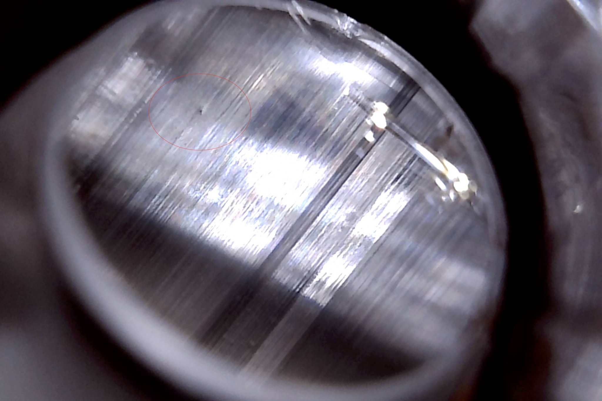

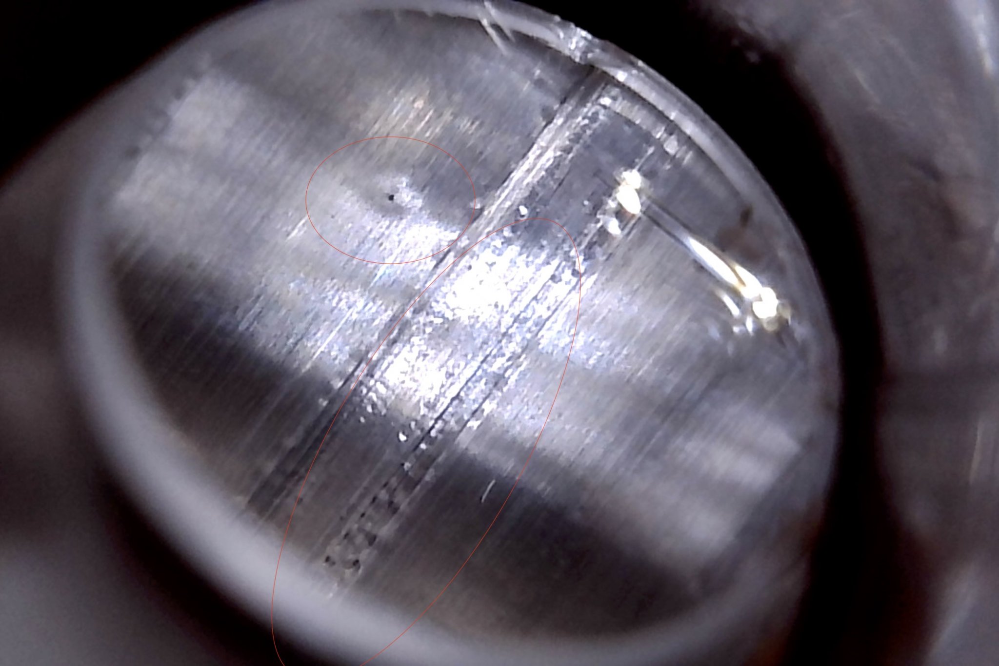

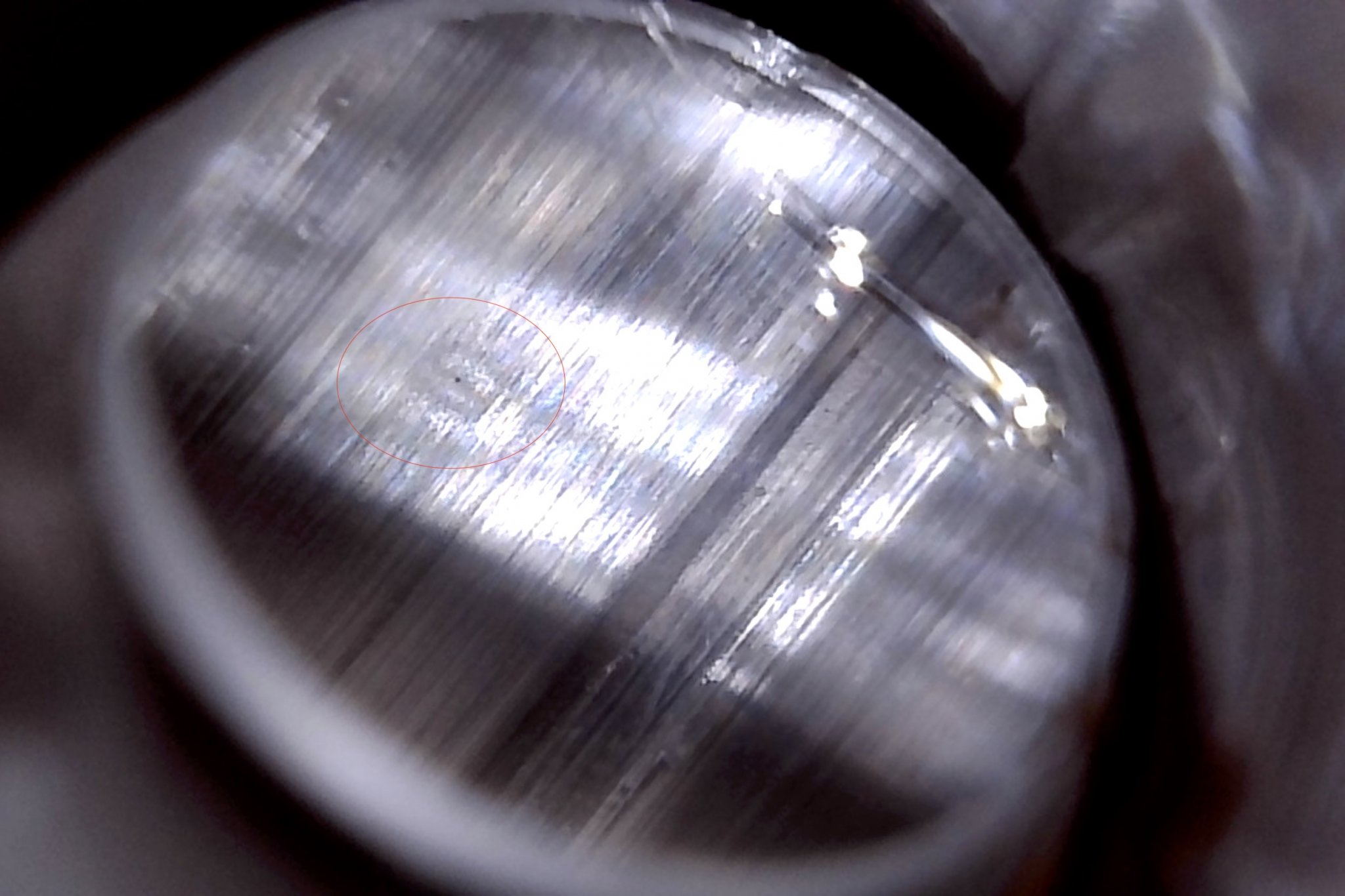

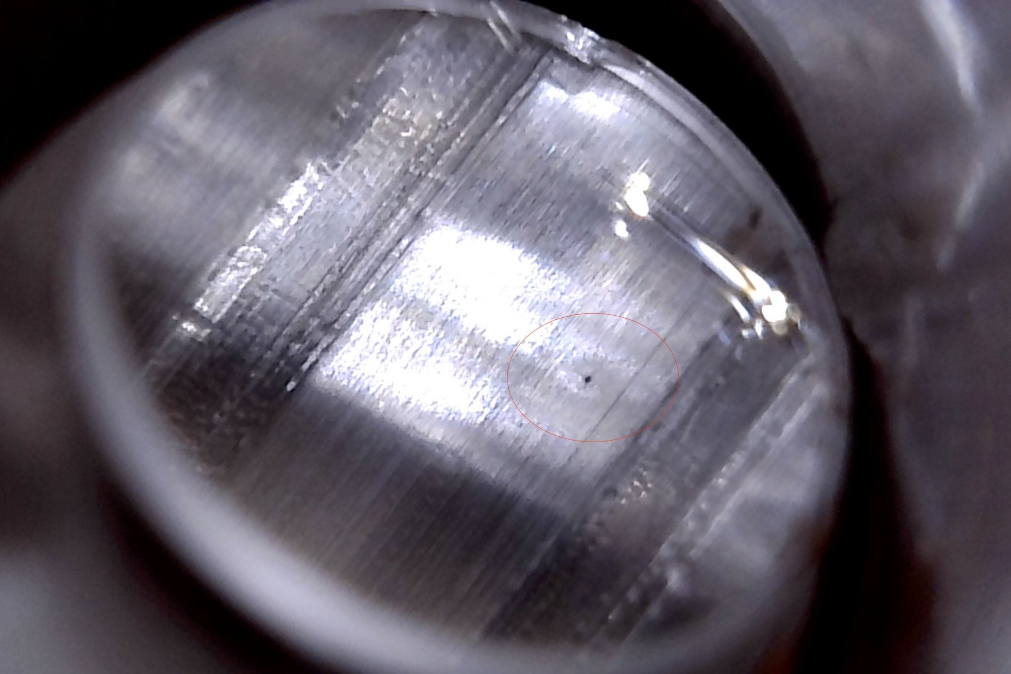

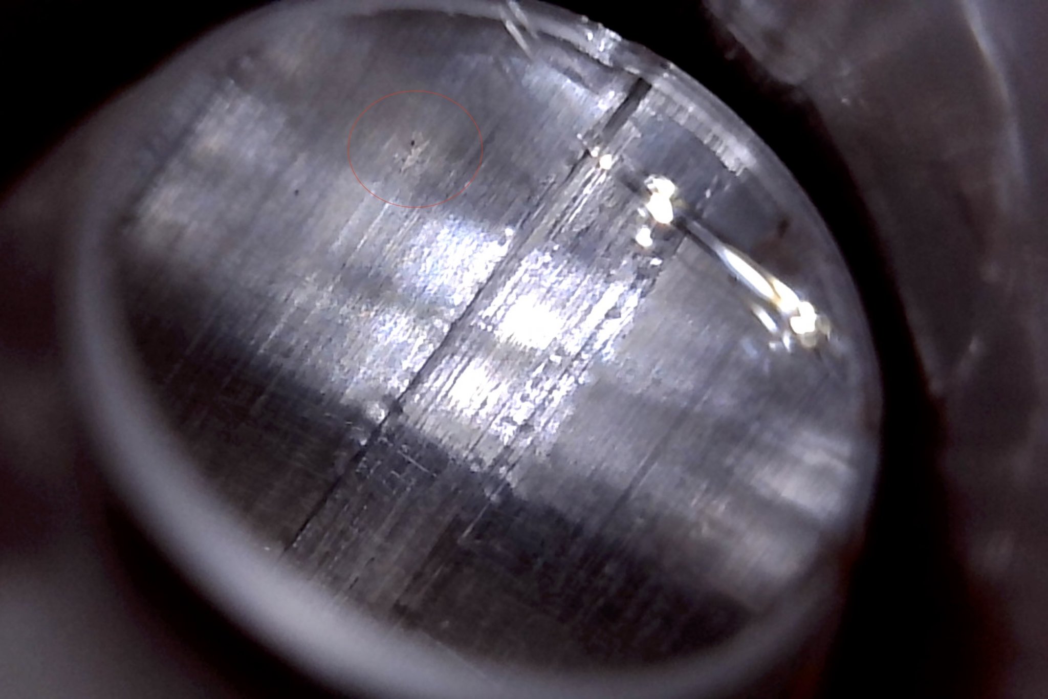

I’ve got a 6.5 Creedmoor barrel with about 1,200 rounds through it. Within the last 200 rounds, I’ve noticed what looks like peening on the edge of the lands in the first few inches of the barrel. I’ve also noticed what appears to be small circular pores or pits that have also recently developed. Any idea what could be causing this? It shoots well, but want to identify the cause regardless.
What chemicals are you using to clean it? Ever used your bore scope to ensure the barrel is completly free of those chemicals after using them?
I think you are just seeing normal wear on the land edges. The little black spots could be metal pulled off the surface. Here is my barrel with 1670 rds through it showing a similar rough edge to the lands. Not the best picture. You are clean the barrel pretty aggressively with a bore paste?
I’ve used CLR, Boretech, Tactical Advantage, Flitz Bore Polish, and Iosso. I clean every 50-100 rounds. I’m pretty good about running several dry patches down after cleaning so solvent isn’t sitting in there.
Sure. I would think that if I were over cleaning the entire barrel would look like that and the crown would be ruined. It’s only the first few inches that look this way.
You didn't lay out your entire procedure, but people who use abrasives are usually getting after the throat more than anything else. It looks to me like youre literally scrubbing the lands out of the throat, and you're doing it at a rate thats faster than the developement of fire cracking that should be there.

That could explain the ‘peening’ on the edges of the lands, but what could be causing the round pits?

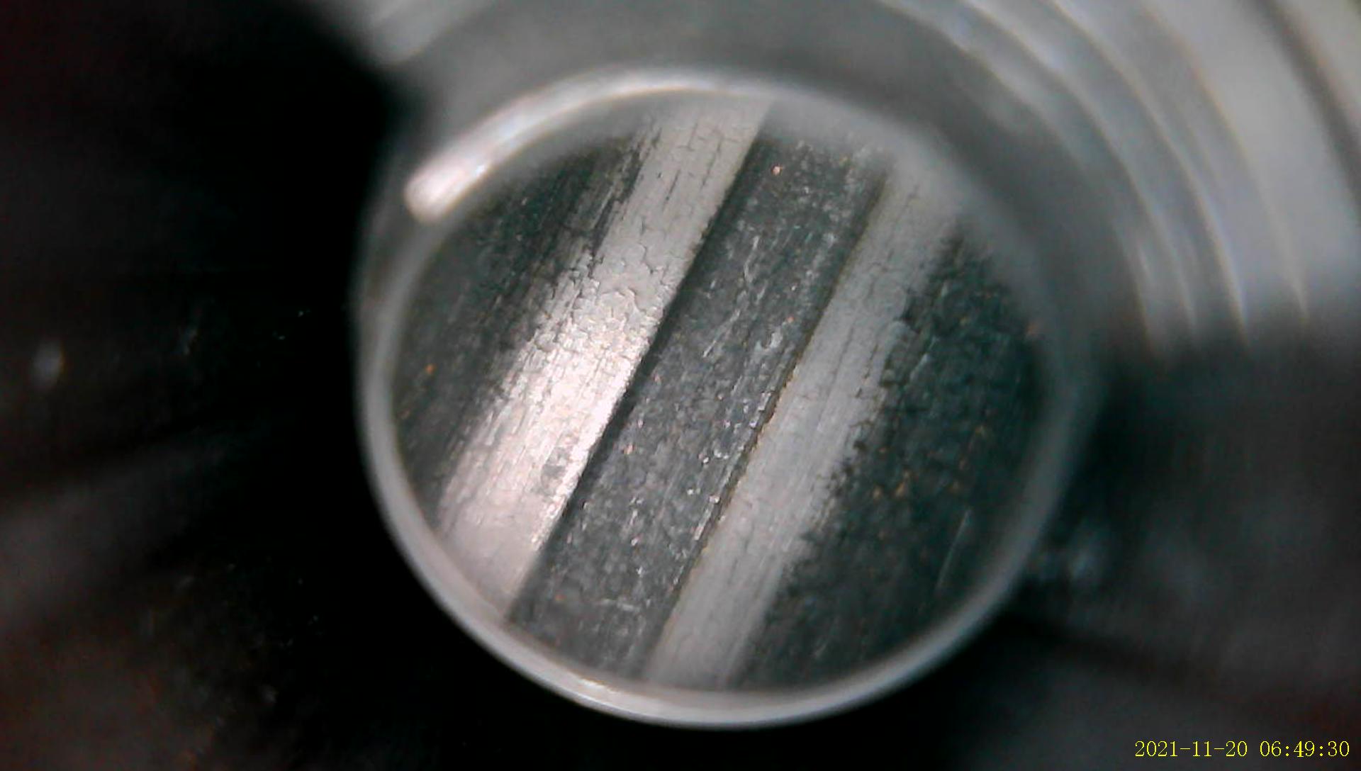

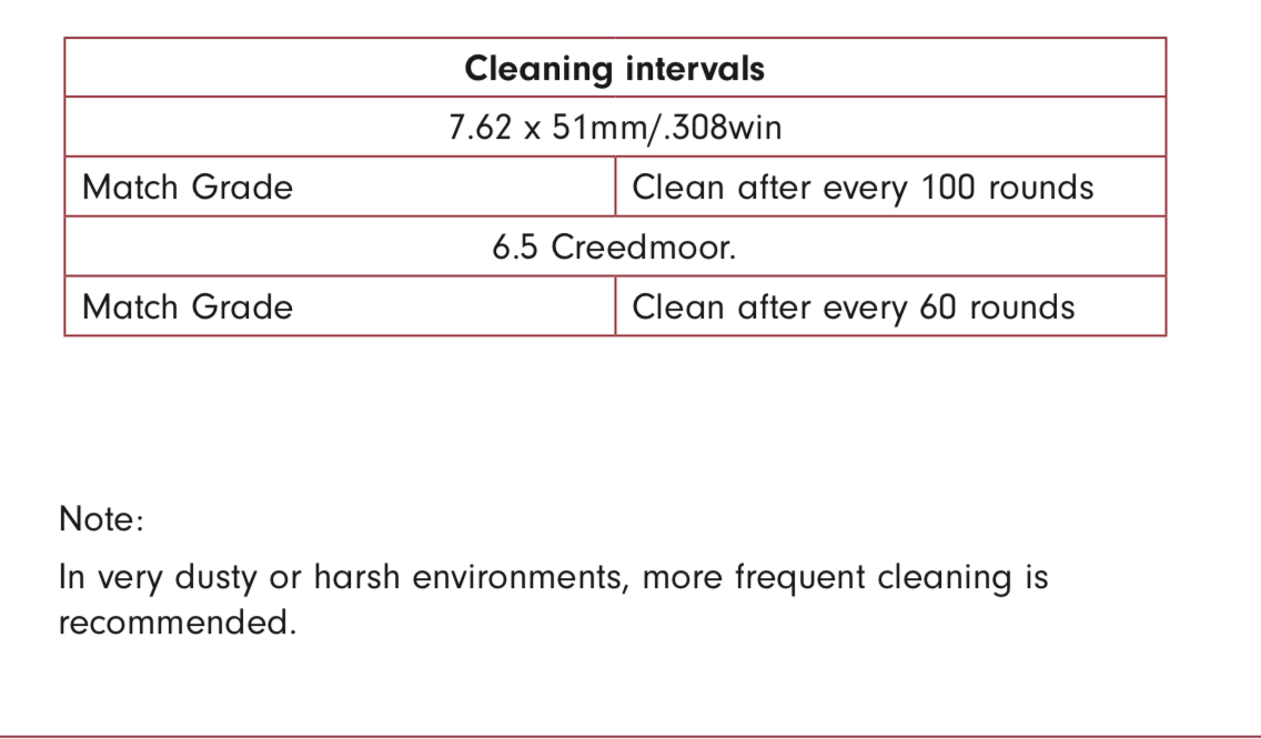

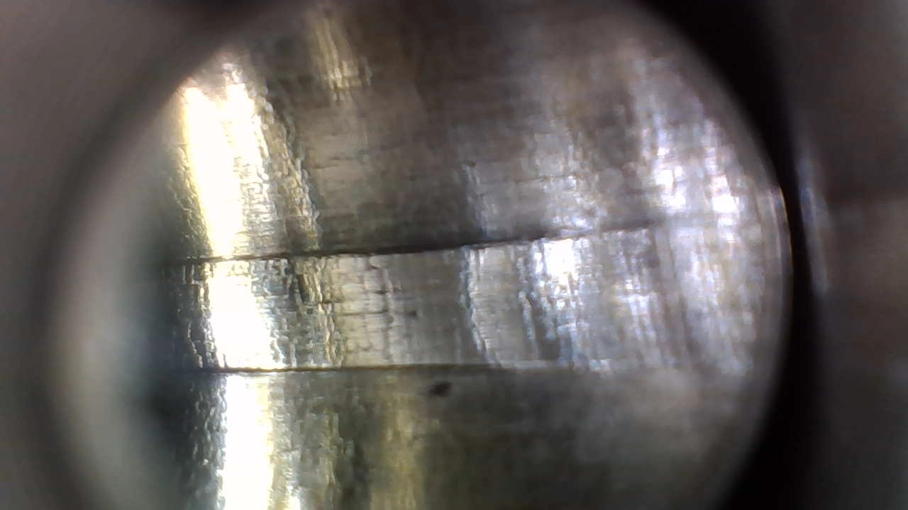

This is right at 1,800 rounds in a Proof SS M24 chambered in 6.5 CM and about where your pic was taken...past the throat itself a few inches
Thats craziness. Did you ask them if that includes abrasives? Im guessing it doesn't. With that short of an interval, a bartlein or krieger takes 3-4 short stroked wets to come out clean using a quality solvent.
Who recommends that cleaning interval? That is just crazy?
It probably does not include abrasives.
That’s just insane. When you get a new barrel please don’t do that again and lose most of those cleaning products. A good solvent and an oil are all that’s needed. I use Butch’s Bore Shine and then when done some Kroil to flush out and a few dry patches and done. No need for abrasives.

-Don't be concerned about the appearance of the edges of your lands, they will break down from normal wear and use
-I don't think you need to clean as often as you are, but I also don't think it's harmful to the barrel
-if you were overcleaning, with a paste for example, your edges of the rifling would be more polished or rounded looking. I don't see that
-regarding your black specks, this is the unknown. Generally corrosion from chemicals will result in larger freckle shaped pits, or a snail trail of corrosion. That's not what I'm seeing here. Get your light right and see if there's a depression surrounding the black specks. Could be small voids in the steel- but Iwould also think that such voids would have collapsed by now and be more apparent. Even if it is corrosion or a void, it means nothing until it starts to create excessive or unusual fouling. Filling with copper or copper streaks down steam for example
The black specs in the barrel appear to be slightly depressed around the edges. The black spots in the neck and shoulder look more like small hollowed out spots without having the surrounding material 'pressed' in. Curious to hear more of your thoughts.

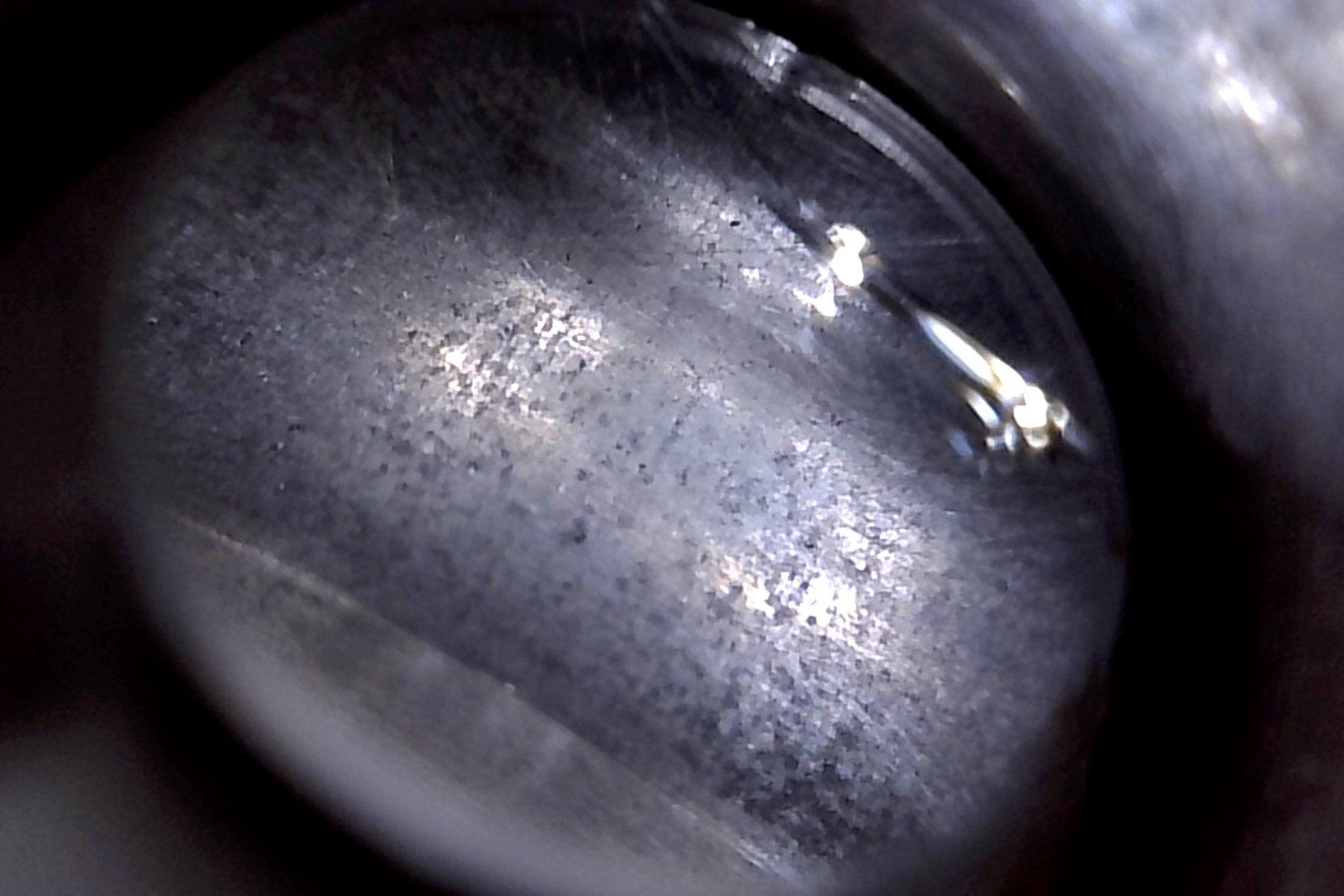

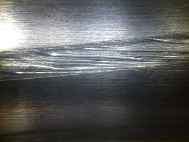

In response to your question....any abrasive period and you use a brush with it....you are going to damage the barrel. My favorite pic is attached. The lands stick up and take the brunt of the beating. Also the guy polished a full .002" out of the bore and a .0015" out of the grooves. Search the forums you will find in depth discussion about this.
I've seen this damage with KG2 Borepast, Iosso, Witch's brew etc...again any abrasive cleaner with a brush at the same time = Damage.
Also how aggressive a guy is factors in. I've seen guys cleaning they're barrels like they are working on a clogged kitchen sink! I should probably say a plugged up toilet! LOL!
I do believe there does come a point in time that you do have to resort to something. I prefer either JB borecompound (blue label) and not the borebrite (red label) or using Remington 40x cleaner. Years ago that use to be called Gold Medallion before Remmy bought them out. Patch only and use the JB borecompond or the 40x cleaner. After I clean the bore with solvent and get it as clean as I can...I will follow up with a patch with JB or 40x. I'll full stroke the bore 10x and short stroke the throat area several more times with the same patch. I might do this depending on caliber after every 300ish or so rounds. Especially after the barrel has a lot of rounds on it and or after I clean the barrel with Sweets 7.62 solvent as I feel it works better (the JB or 40x cleaner) on the carbon build up. After I dry patch it out I follow up with a light coat of Hoppes and just dry patch the Hoppes out the next morning before I start shooting again. This is where the gun is getting 60 or more rounds on it in a single day during big matches. The throat area will build up with carbon the worse and it will be in like the first 6" to 8" of barrel length. This is caliber dependent. A 308win. barrel won't build up as fast or as much as a 300WM or a 300 Norma barrel will. Same if you stay with a 308 case capacity and turn it into a 243win. type chamber. Same case capacity but by reducing the bore size you have now turned it into a magnum round!

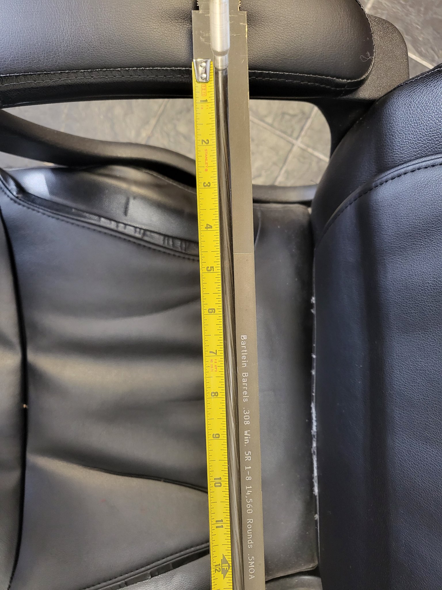

Picture attached is a accuracy test barrel I got back from Sierra after it would no longer hold .5moa or better. 308win. chamber. Other than running a dry patch down the bore before I had the barrel wire edm cut in half the is as I received it from Sierra and they have a strict cleaning procedure and number of rounds they fire in between cleanings that they follow. Look at the first say 6" of the bore from chamber towards the muzzle. See how black it is....that's the carbon you are seeing. Yes that's not a engraving typo. That barrel got 14,560 rounds on it and up to that point was still holding .5moa or better.
I've seen guys wreck barrels in as little as a 100 rounds with using an abrasive and a brush at the same time. Took out a full .001" out of the bore of the barrel. Rifling damage to the lands was already starting to show like in the first pic. One guy I replaced three barrels in the course of 6 months. I got fed up. I told him unless you change your cleaning procedure as you are wrecking the barrels. I'm done. I'm not replacing another one. I helped him the best I could! A few months later then he was complaining to a bullet maker they're bullets where bad and where blowing up. I'll guarantee it was damage to the bore from poor cleaning technique and not a bullet fault. A bullet that hits rifling like in the attached pic....plan on it coming a part!
Later, Frank
