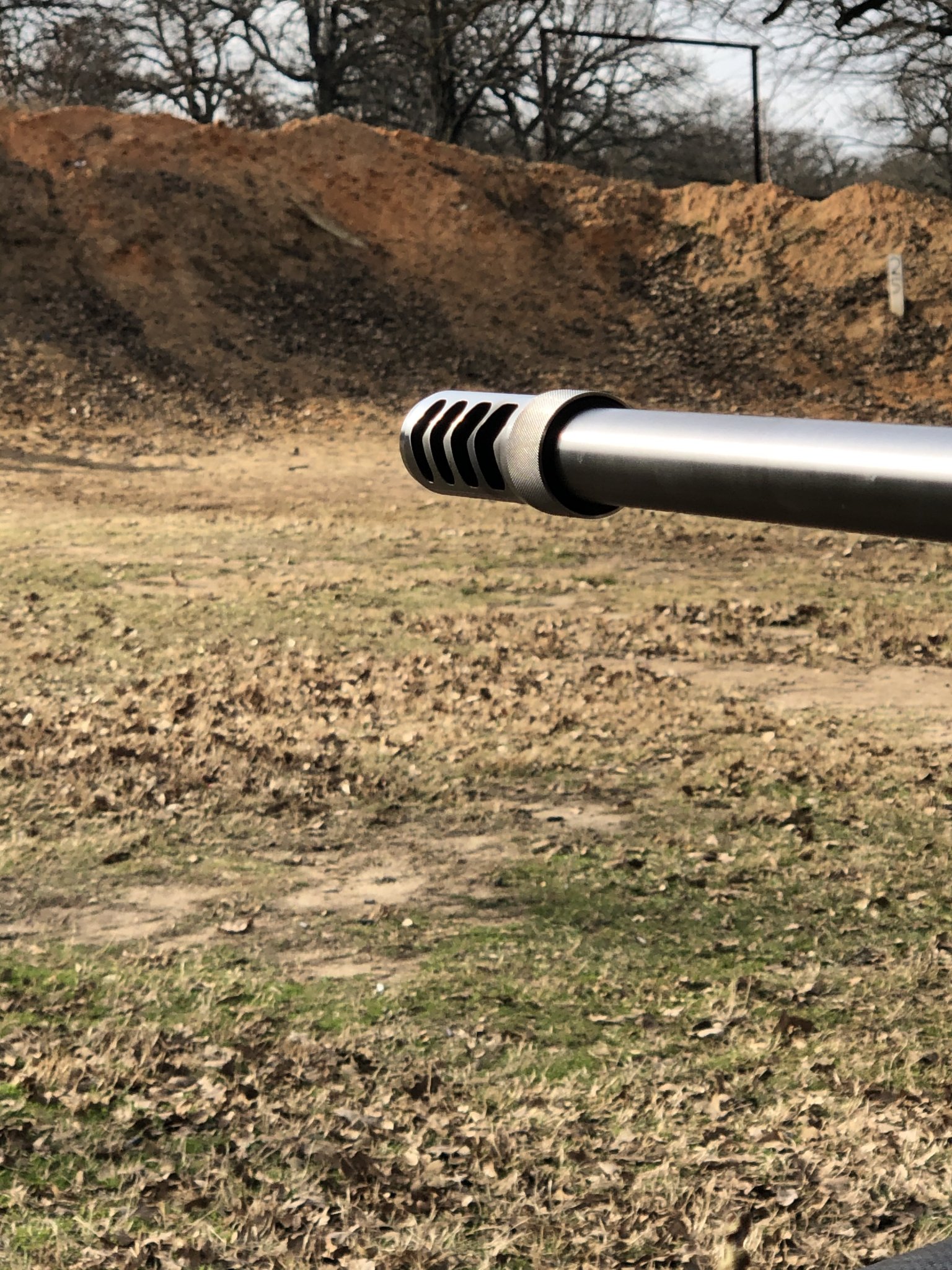

i've run A419 Sidewinder brakes on a 1.25" straight and it's fine. a hellfire match would be fine as well
i have a 3 port Heathen on a proof comp contour and 25" HV and it's fine as well on both
any of the bigger 4 port brakes should be no issue

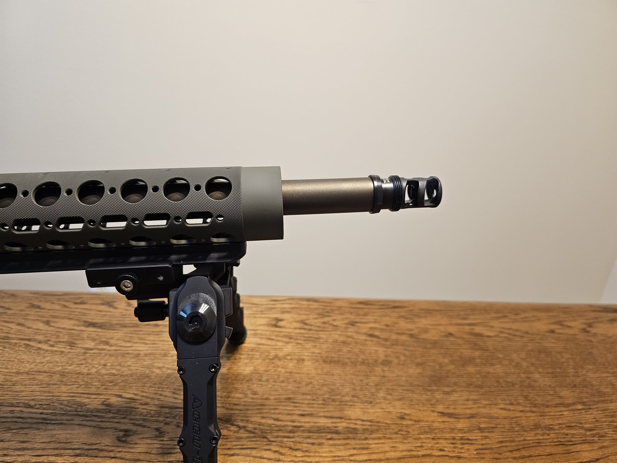

You're right. I didn't mean to imply that those devices are any larger. I just figured if someone was going to have a barrel that thick and heavy, why would they cut down the part that supports the crown to where there's only about .180ish thickness there. May not make a difference on a cut rifled barrel, but if we're going with the more is better theory, why not go all the way to the end of the barrel. Pic of the Griffin Palladin on .945 muzzle

Bartlien #4 24” hellfire match
Proof 22”, 1” at muzzle, sidewinder
