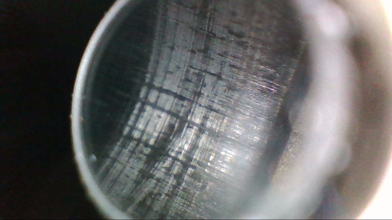

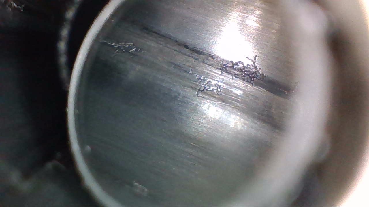

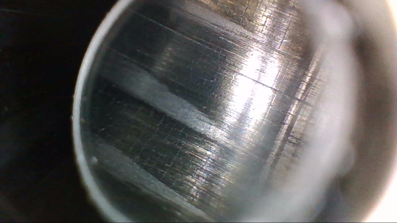

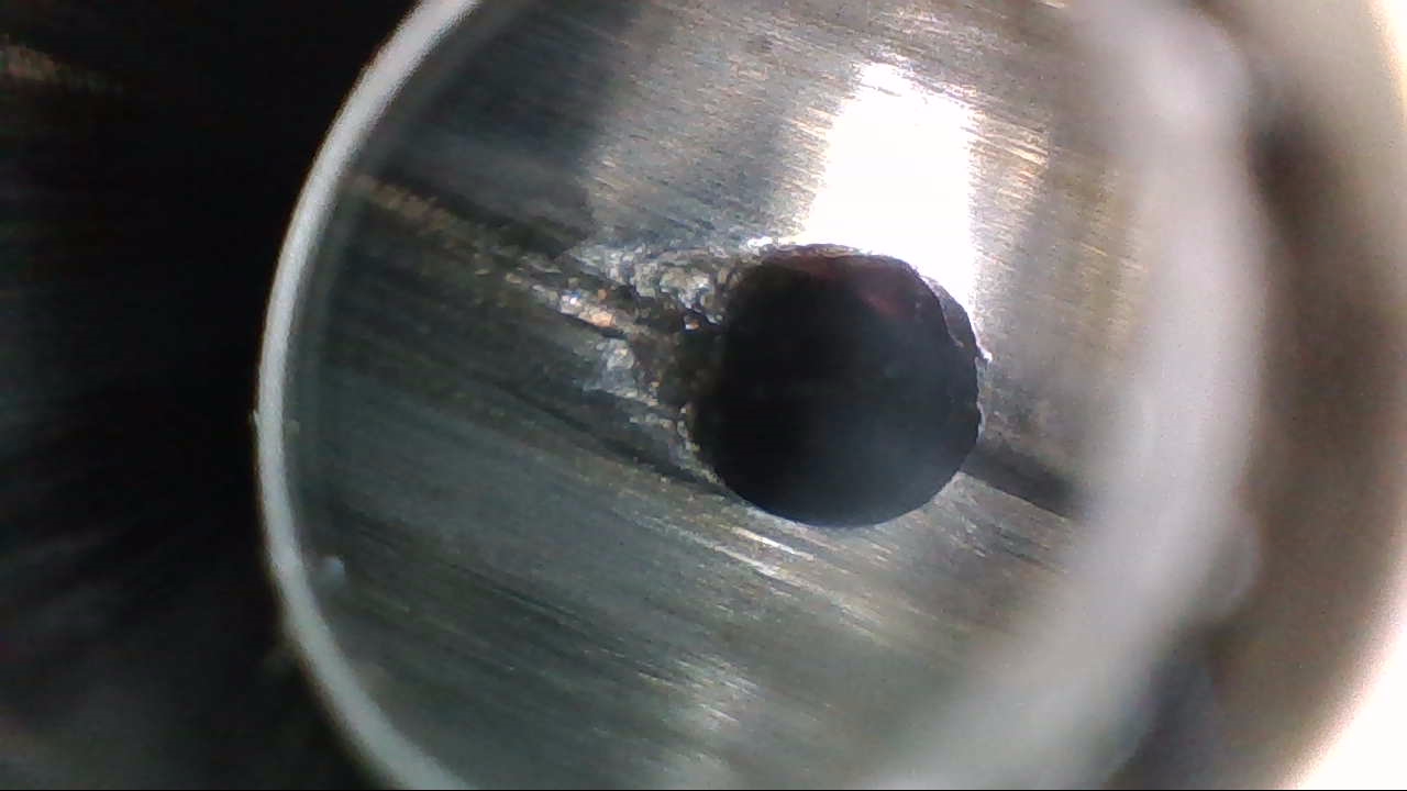

    Noveske 308 barrel converted to run in a LMT. I got it used but initially it was a reliable 3/4moa or better barrel with fgmm or similar and in load development with 175smk and 168 it was less than 2moa for basically every combo. I had a random baffle strike with a socom 762 on it and after thinking about it it's never really been the same since. Now fgmm is 2moa and completely random patterns. I'm not sure how many rounds are down the barrel beyond the 1500-2k I've put through it. I removed the muzzle device and the crown was clean and looks fine.
    first pic is the gas port, 2nd is some weird etching on top of and on the edges of the lands near the muzzle and then the throat and leade.
    I haven't shot it in a while and I was attempting to rezero after switching to one of the 15.5" socom uppers and it was terrible. Threw the creedmoor barrel in after for a sanity check and it's 3/4moa or so like normal.
    Tired of pulling my hair out. Anything specific I should look at?

    Ist is make sure nothing is touching the outside of the barrel which I'm sure that you've done. 2nd is I personally would chop off the barrel and recrown it. Making sure to eliminate pic 2. Don't know if that's actually the issue but it's the 1st logical step.
