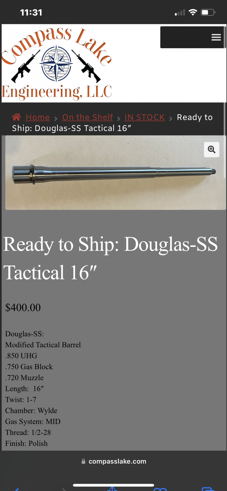

Compass Lake Engineering should be able to set you up . I know this isn’t exactly what you’re looking for but it’s ready to ship and it’s 16”.

I would buy the CLE. Douglas myself.
