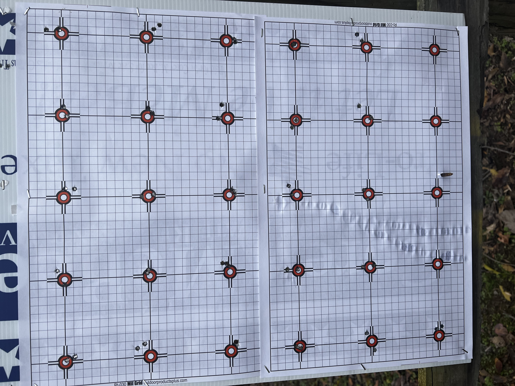

I’ll comment on question #2. I went through this scenario with my b14r this summer and had similar concerns about 50 and 100. My range has 60 and 77 yd markers as well as 50 and 100. I couldn’t find the 77 yd holes that day so used the 60 with success.

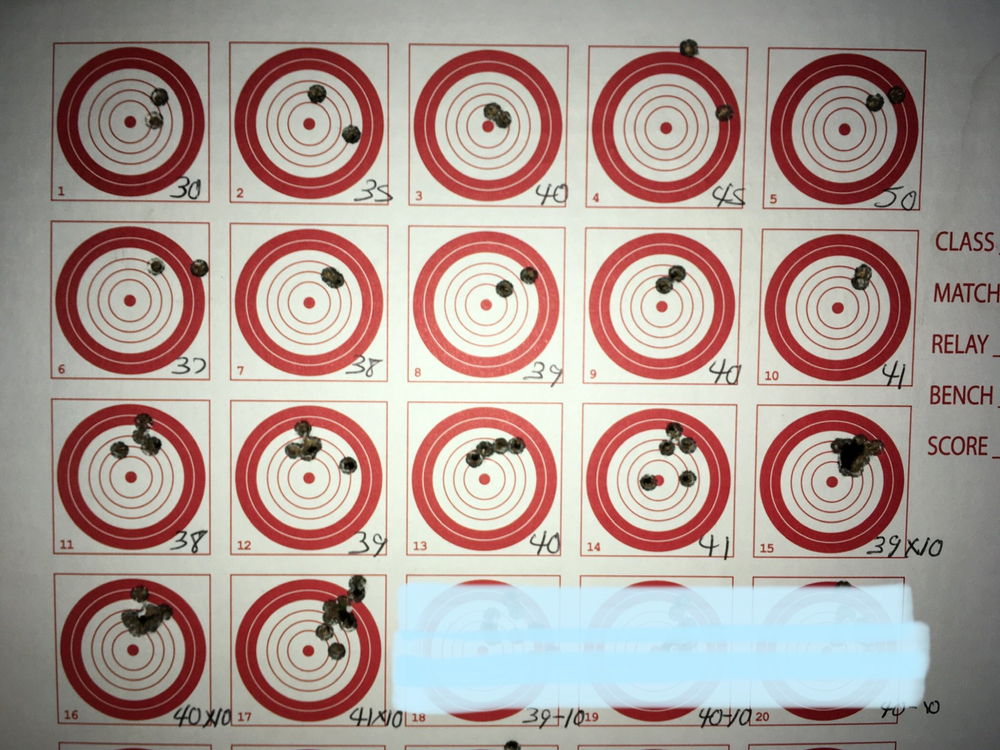

A few more thoughts on tunning which I hope will help! These are mine and surely not etched in stone but they are based on years of experience. I only compete at 100 and 200yds but I always tune at 50 and sometimes even less. Simply because I'm a better shot at 50 than I am at 100 or more and outdoor conditions have less effect at closer ranges. Indoor is the way to go if you have ascess. I tune on a standard PSL target using the Hopewell method. Some barrels don"t respond well to tuners, espically short "less than 22in" heavy conture barrels. .850 to .90, 24 in barrels are the easiest for me to tune. I'm one of those that believes a tuned barrel is a tuned barrel no matter what range you shoot. If tunning is attempting to get the bullet to exit the barrel on a signwave node where the barrel is neither in a upward or downward movement then range has absolutely no effect on tunning a barrel. I do believe that bullet speed can effect a tune but the difference between say 1073 speed and 1060 is not worth the trouble.
And if tuning is attempting to get the bullet to exit the barrel on a rising slope of the sine wave where the barrel is in an upward movement then range has everything to do with tuning a barrel. In this case the goal is to achieve positive compensation which is when the fast round exits on a lower trajectory and the slow round is 'lobbed' at a higher trajectory and their POI is coincident. As littlesister chooses to tune there is no mechanism shrinking vertical but the tune is not range sensitive.
Both methods work in theory.

My rationale for shooting at 85 yards rather than at 50, is that since the objective is to identify the settings that produce the smallest vertical spread, then vertical spread would be more pronounced further out. I would expect more vertical spread at 85 yards that 50 yards; so the tightest vertical groups will be easier to find.

I tune at 50 yds for my first test. I will pick out the best numbers and re test those at 100 yds. I will shoot 2 round groups and move after each shot group. The picture is of my Di Precision with EC Tuner. Picture is sideways. Making Bottom Left corner as it is pictured 00 on tune start.

When I tuned my Holeshot tuner I shot a couple 5 shot groups at each setting unless they were really bad and then I only shot one. Two shots doesn’t do it for me.

OP, I appreciate this thread as it caused me to research the Hopewell method and apply it to action screw tuning on my B-14R (I don’t have a tuner yet).
I had quartering 5+mph wind at 2:00 and rain at one stage of testing, temps 62-68F
I have swapped the steel barreled action over to Bergara’s BMP chassis, and noticed my groups were horrible at 45 in/lbs at the last match. I have to do this test again in better conditions and see if it’s the same or different for another type of ammo.
