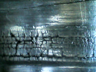

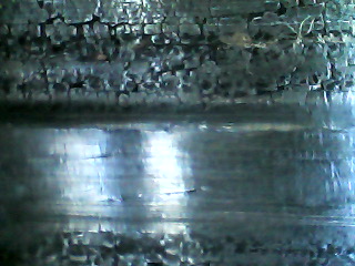

This is what a 2200 round, moderately loaded 6.5 Bartlein barrel looked like at 2200 rounds. I swapped it out at 2500 not so much for accuracy, but because it was like cleaning a cheese grater. The cratering literally scraped the copper off the jackets.
View attachment 7016439View attachment 7016440
I'm noticing some similar stuff to this in a .204 Ruger barrel (though mine seems to be less severe than the above pics), and am wondering if it makes sense to leave the copper in place (rather than chemically stripping it) and smooth out the "alligatored" area with some bore polish. The theory being that the copper fills in the low spots while the bore polish knocks off the high spots and blends the copper to the steel for a smooth transition between the two metals (kind of like sanding a bondo'd spot on a car body to blend it to the surrounding steel).

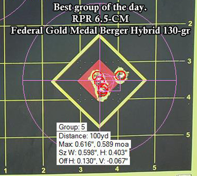

Went to the range today. With a bit over 2,200 rounds through my factory barrel (Ruger Precision Rifle 6.5CM), I turned in this best group for the day. It happened to be my last group of the day, too. Five shots. Not bad. Without the "flyer," which I knew I pushed, it was sub-1/2-MOA (0.387-MOA). It's always that fifth shot! :) But, I counted the fifth shot in the group measurement. Still pretty good at 0.589-MOA.

Went to the range today. With a bit over 2,200 rounds through my factory barrel (Ruger Precision Rifle 6.5CM), I turned in this best group for the day. It happened to be my last group of the day, too. Five shots. Not bad. Without the "flyer," which I knew I pushed, it was sub-1/2-MOA. It's always that fifth shot! :) But, I counted the fifth shot in the group measurement. Still pretty good at 0.589-MOA.
Nice!
What ammo and Bullet performance nice Group
