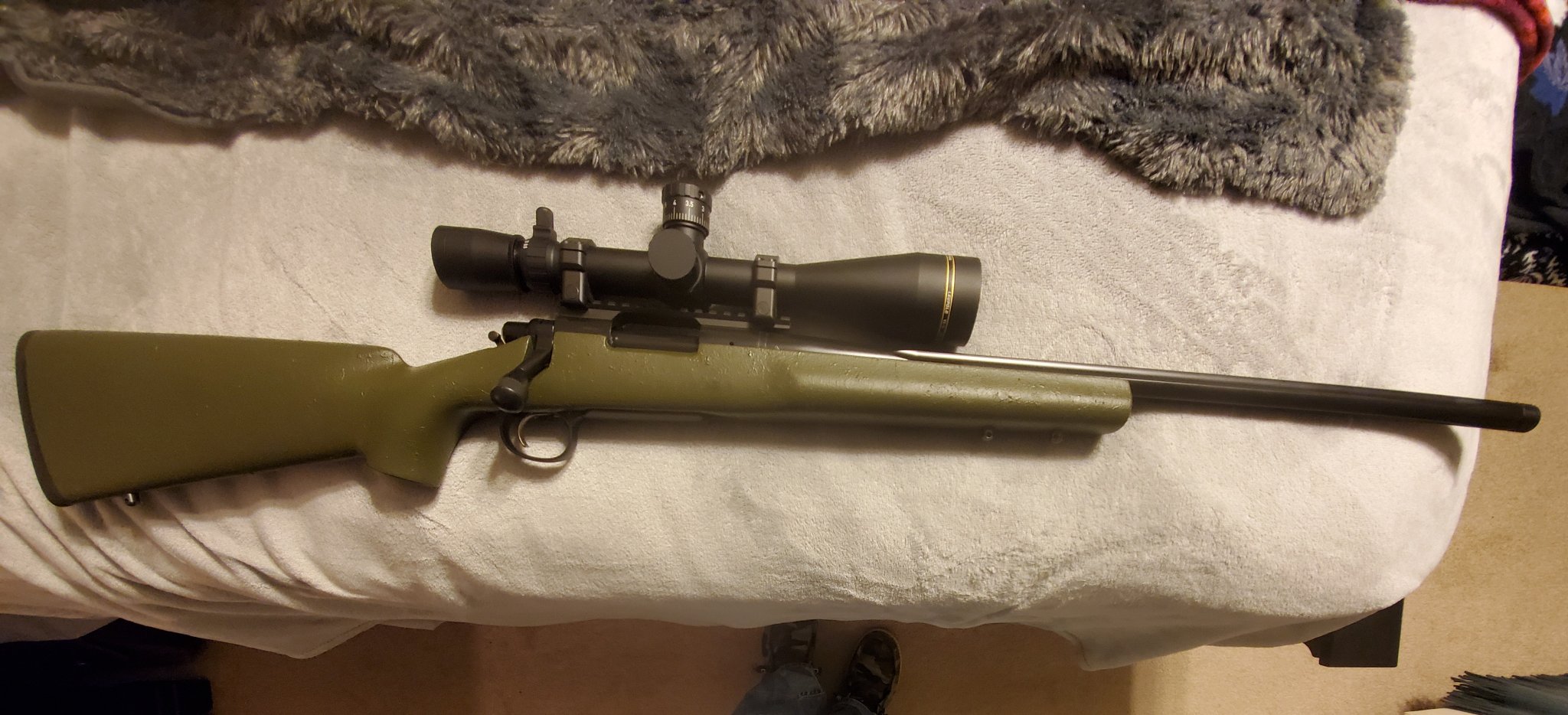

Ok guys I'm coming to all of you for help. I put this together a few years back. Remington 700 Gen 2. Love this rifle. Put a Leupold LRT 8.5 X 25 on it. .308 of course..... I purchased this to hunt with, it is not a bench rest range only gun. Well... it's a bit heavy to lug around the mountains of PA. I know a big chunk of the weight is the barrel. It even seems a bit front end heavy. I got the model with a 24" barrel. I'm just not a short barrel guy. No offense. It has a beautiful 5R barrel on it and it is beefy. I mean this thing looks awesome especially with the flutes that are in it. It looks like a barrel on steroids. Unfortunately it adds weight. The gun is very accurate.

I think it's coming in a little over 11lbs right now. Not extreme heavy but after a day of climbing it wears on you. I wouldn't mind trimming 2 lbs.

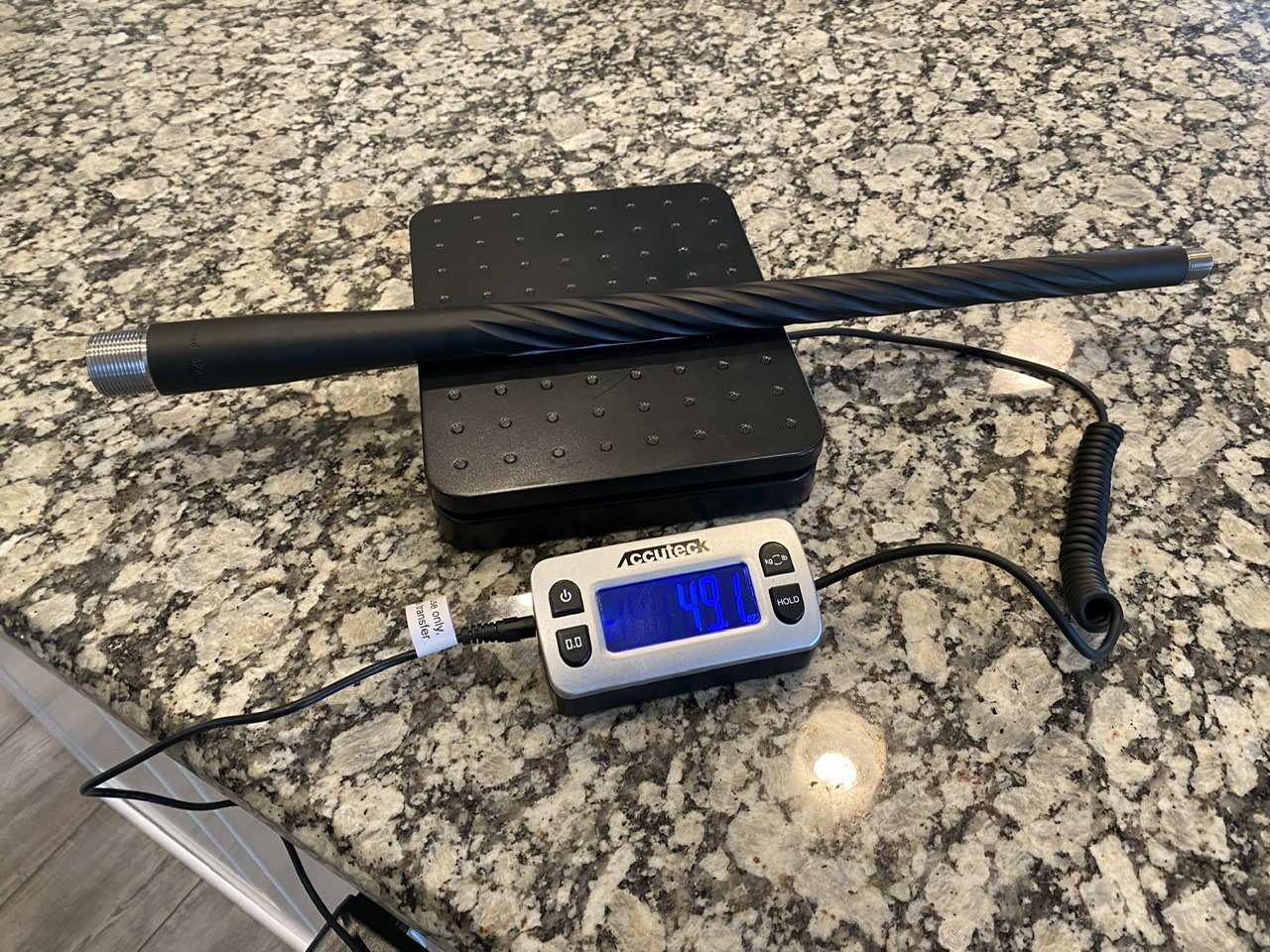

You just need to get over your whole adversity to short barrels if you want to cut weight. CF barrels are just fine, and help, but the biggest favor you can do yourself is to get a 20” barrel. Go with a lighter profile (but not pencil thin) like a Bartlein 3B and flute it if you want to stay steel, and you’ll still be able to pull off five shot strings without issue, but cut some weight. I have one done that way in 6.5 CM and it’s 49.1oz.
That's a sexy looking barrel right there!
