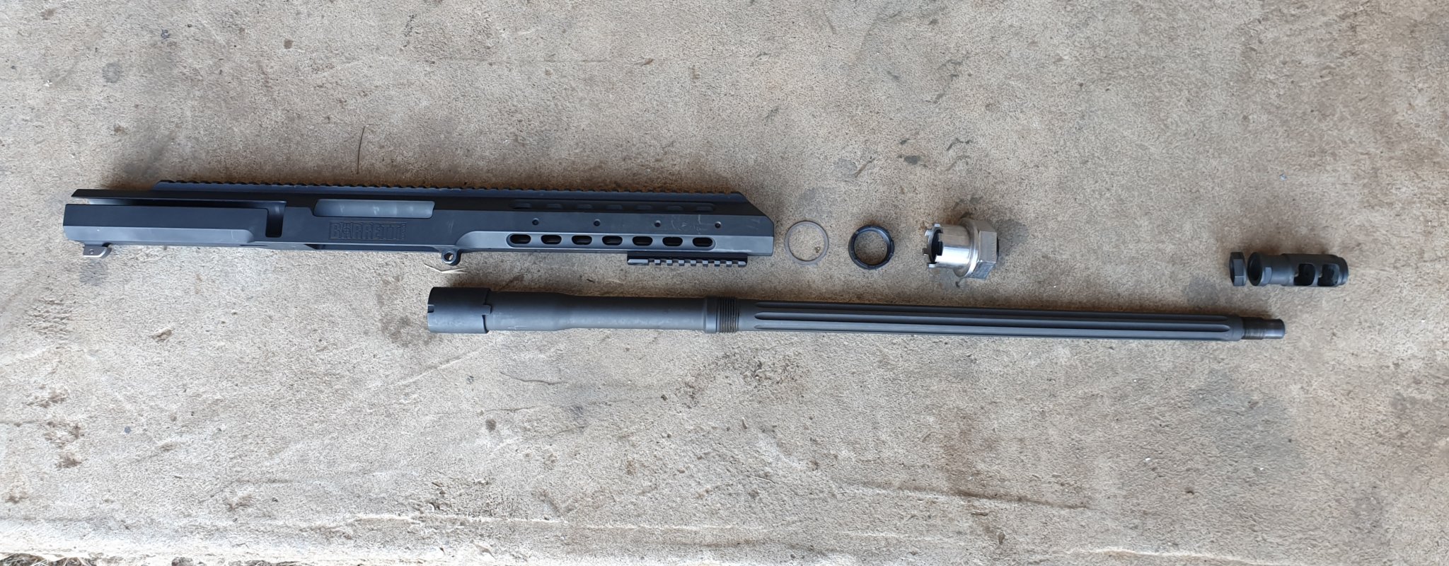

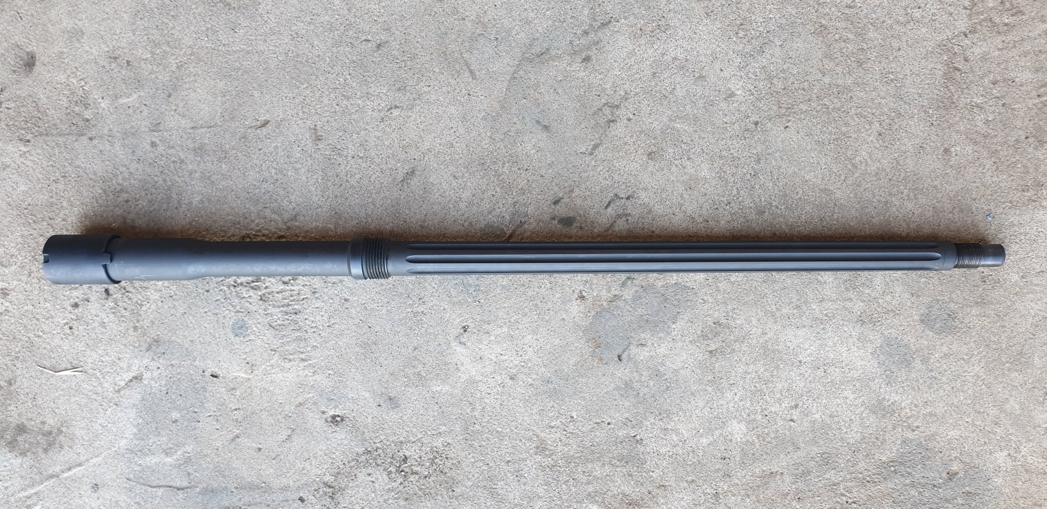

Ive since moved on from my Barrett, but here's some photos of the barrel and stripped upper. I couldn't buy the removal tool here in Australia so I machined one up myself.
