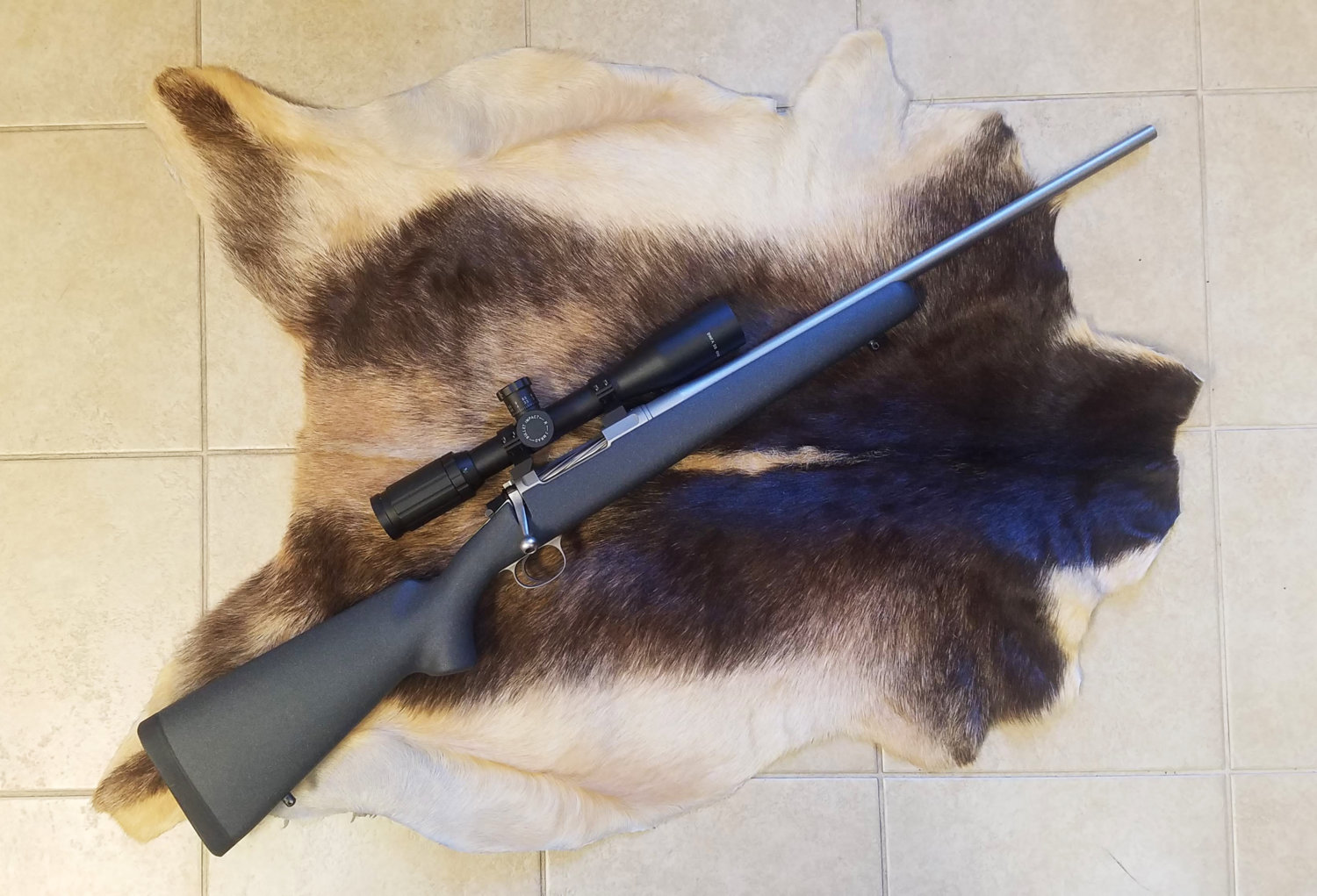

So, after becoming aware of the Barrett Fieldcraft rifles awhile back in a discussion here on the Hide, I started looking into them and decided that I wanted one. As it happened, I had some other guns for which I had no real use, and traded them off for a Fieldcraft chambered in 7mm-08. Mine is the 18" threaded barrel model, and I picked it up last night. Here are my observations to this point (in no particular order):
  • The trigger (a Timney) was factory adjusted to a crisp 4 pound break. It was reinforced to me how much of a trigger snob I have become since I estimated it at 5-6 pounds prior to breaking out the Lyman trigger pull gauge.
  • Removing the rifle from the stock was easy enough, even if it took two different size allen bits, and adjusting the trigger to the same crisp break at ~1.75 pounds was as easy as fiddling with the lower of the two allen screws on the front of the trigger pack.
  • As is mentioned elsewhere, action screw torque is 80 in/lb for the front and 36 in/lb for the rear per the factory manual.
  • All of the published information that I can find on the Fieldcraft states that the twist rate for the 7mm-08 is 1-in-8, but my barrel is marked as having a 1-in-8.5 twist rate. This is far from a deal killer for me, since I intend to shoot projectiles in the 150-162 gr range, for which the 8.5 twist is more than adequate.
  • The action is not as smooth as I had hoped it would be, but maybe that will change with some break-in. Further, it's also possible that I've been spoiled by my Tikkas and Howas.
  • The bolt is a tiny little thing, being pretty damned close to the size of the bolt in a Howa mini action. The difference is that the Howa mini action is intended to work with cartridges that will fit into an AR15 magazine (.223 rem, 7.62x39, 6.5 Grendel, etc...) while (this model of) the Fieldcraft is intended to work with cartridges that will fit into an AR10 magazine (.243 win, .308 win., 7mm-08, etc...).
  • The (flared) barrel shoulder diameter is .748" per my calipers.
  • It's possible to load this rifle to 4+1 capacity, but it didn't seem particularly happy about it... depressing the four rounds in the (internal blind) magazine was easy enough, but it really didn't seem to like dragging the bolt over the rounds in the mag to chamber the 5th round.
  • The (5/8-24) muzzle threads are quite long; from the face of the muzzle to the (flared) shoulder on the barrel is ~.670" (approximating since I have already installed a muzzle device and I'm not going to remove it so that I can get an accurate measurement).
  • I was fortunate to be able to clock a TBAC CB mount with only .013" worth of shims to get the top face to ~11 o'clock when hand tight; a smear of high temp red loc-tite and maybe 8-10 ft/lb got it installed where I want it, and I suspect that it will stay there indefinitely.
  • The rings that Talley makes for these rifles are pretty nice; the one with the beveled base is the rear mount/ring (otherwise, the base would overhang the ejection port). Ring clamping torque per Talley is 17-20 in/lb.
  • I have no idea what the ring/base-to-action torque should be, but given that Barrett bored the screw holes to accept #8 screws, I feel pretty safe with a dab of blue loc-tite and 25 in/lb.

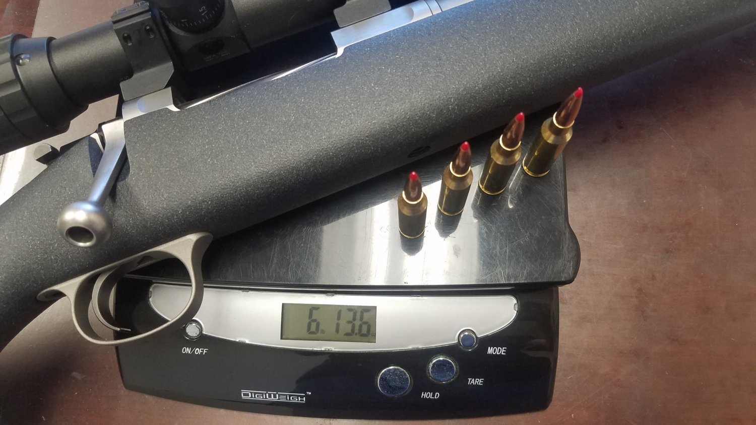

  • The best part: light rifle is light. In complete, ready-to-go-hunting trim including the complete rifle, TBAC CB mount, Talley low rings, a Bushnell 4.5-18 LRHSi scope and five rounds of Hornady 150 gr Precision Hunter ammo, the rifle weighed 7.3 pounds on my kitchen scale. I have not weighed it with the (Ultra 7) can on it, but it'll still be well under 10 pounds even then.
I have not gotten a chance to shoot it yet, but hope to get to the range towards the end of the week. I'll reply to this thread with any thoughts/results that I gather. If anyone has any questions, feel free to ask away... non-magazine/website reviewer info on these rifles seems to be kind of scarce, so I figure that putting some info out there might help the community as a whole.

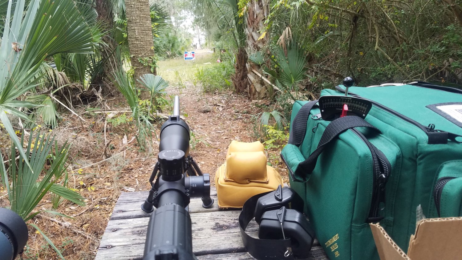

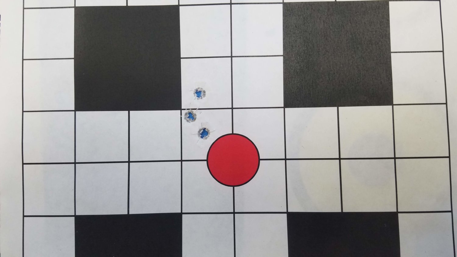

Finally made it to the range with the Fieldcraft today, but didn't get the results I was hoping for... five rounds formed more of a "pattern" than a "group". If I had to guess, I'd say probably 3 MOA or so. That said, there were a few factors for consideration:
  • I only took one box (20 rounds) of one type of ammo (Hornady Precision Hunter - 150 gr ELD-X) with me
  • Given that this was the first outing, I had to actually get the thing sighted in
    • Spotting my initial POI was made more challenging by the dingus two bays over who kept shooting my target ("Hey, are you sure you're shooting the correct target? I've only fired five rounds, and I just counted 11 holes in my target.""Yep, I'm only shooting mine.""Then where did the other six holes come from?""...?""Must be magic.")
  • Rounds 11-15 and 16-20 went into two, ~3" groups at 100 yards (rifle was allowed to cool between groups)
  • Some of the accuracy (or lack thereof) may be due to poor recoil management on my part (no one would call 7mm-08 a thumper in terms of recoil, but it is a pretty light gun)
  • Interesting to note that across the entire 20 rounds, that ammo ran an average of just shy of 2650 FPS in my rifle at an ambient temp of 64 degrees
In any event, the plan for now is to clean it and start load development. I have three different projectiles to try (150 ELD-X, 162 ELD-X, and 168 ABLR) and a bunch of different powders. I'm also debating doing some action screw torque tuning, as I have read (on the Internet, so you know it's true) that some Fieldcraft owners have had some success with that approach.

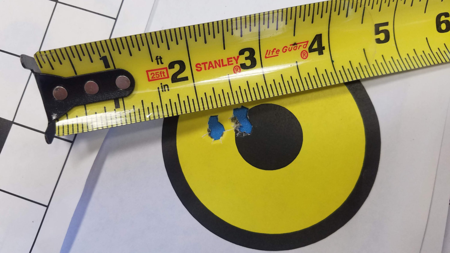

I shot my new 6.5 CM 21" barrel for the first time last week before work. Best groups were 0.4 MOA (Hornady 140 ELDM) and 0.6 MOA (Federal Premium 140 accubond). I sighted in with the Federal ammo at 25 yards and then shot the 3-round "group" in the first photo. Shot a couple more 3-shot groups, then shot the yellow target group with the ELDM. It's only 3-shot groups, so not a great test. But using a fixed 6x scope, I am very happy.
Only thing I did for prep was clean and lube the rifle. Shot it hot without any rest between shots to cool the barrel. All up she is 6.85 pounds with an SWFA 6x42, full mag, and Talley low/light mounts. Love this little gun so far. Feels so strange in a padded case (Who put this toy gun in here?). :love:
