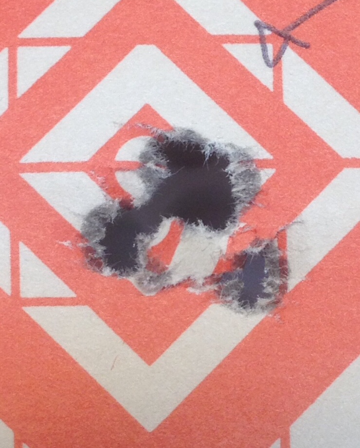

Ok, so it only took me 37 rounds to find a excellent load in 300 win mag.
This load is above max but with no pressure in my rifle, so start at lot lower.
Barrett MRAD only
24" barrel 1-10 twist
300 win mag
230gr OTM Berger
Winchester case
76.6gr H1000
2828 OAL from Ogive
Velocity at 2750fps
1/2 MOA
Going to stretch it to 1,000 next weekend.
Sent from my iPhone using Tapatalk

ImageUploadedByTapatalk1410788876.931530.jpg forgot to add a photo of the target...
