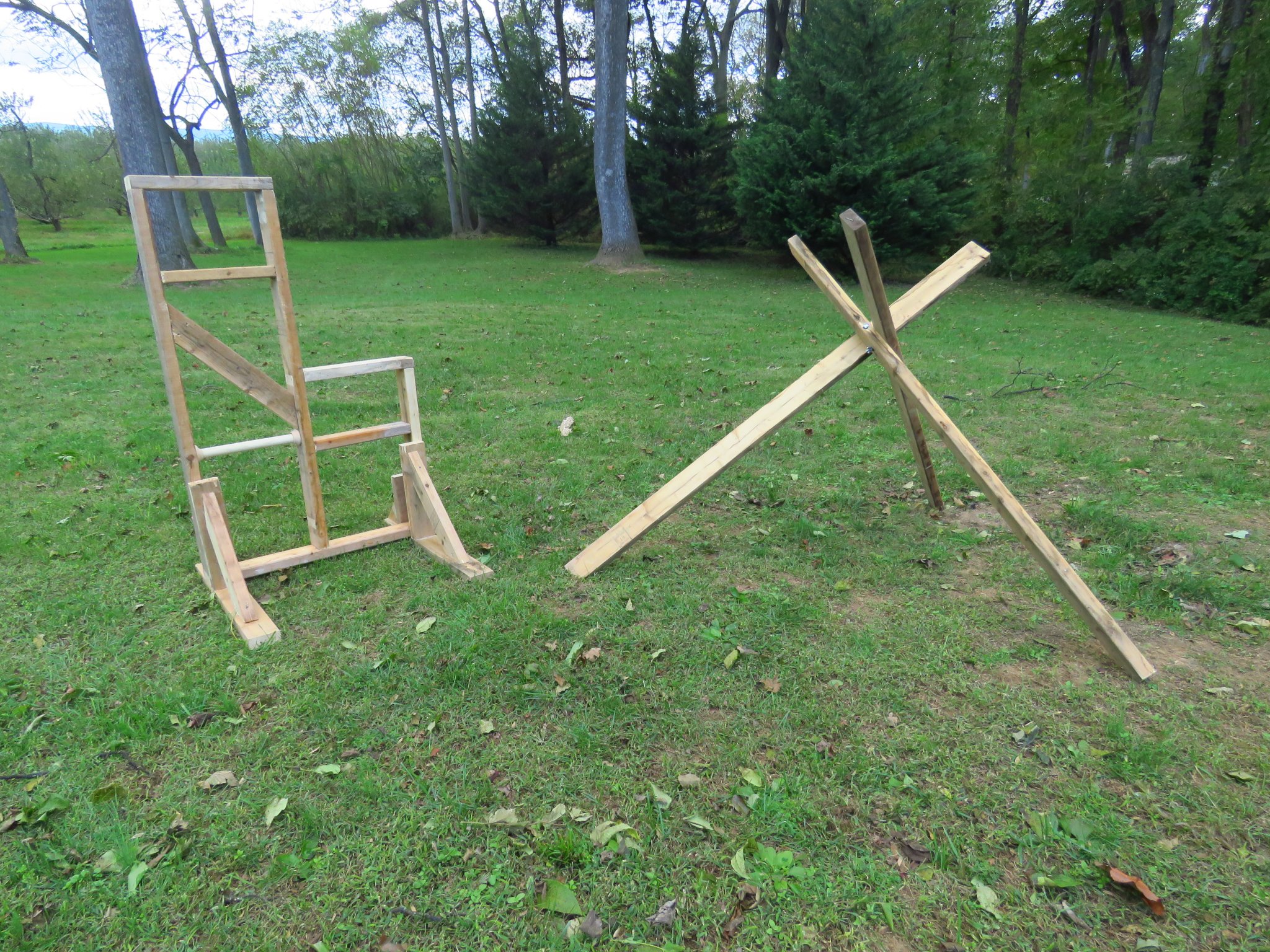

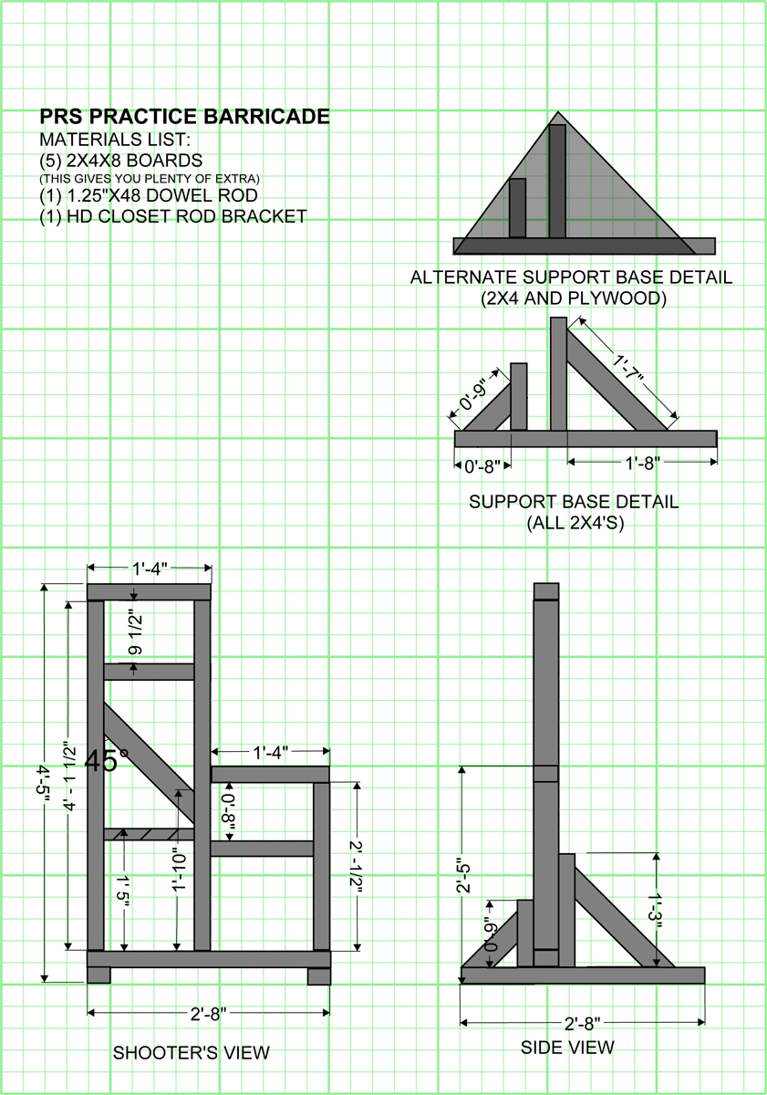

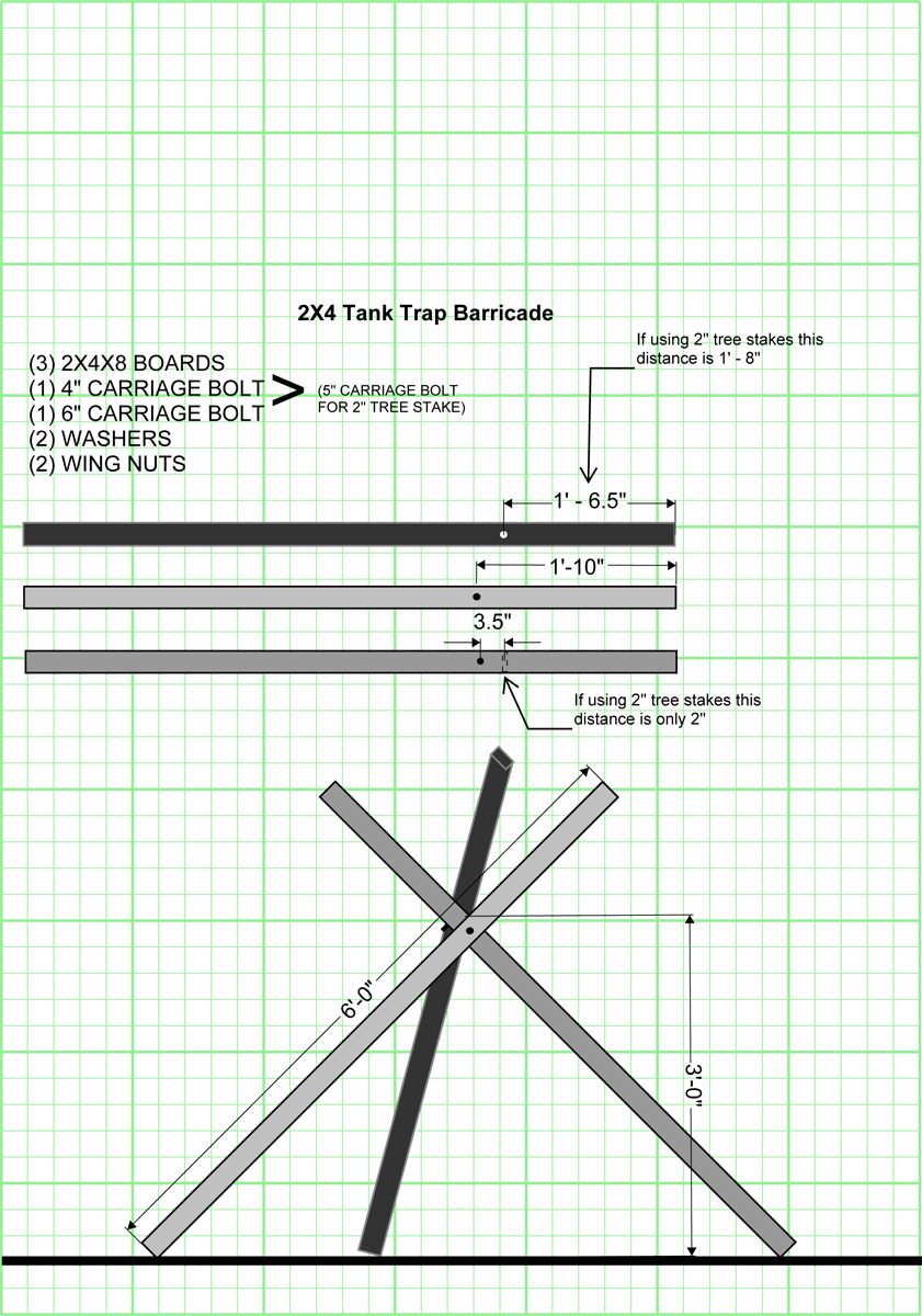

    I just built some barricades for range and practice use so I thought I'd share the plans that I made after I worked out a few kinks.
    Step-type Barricade
    Tank Trap

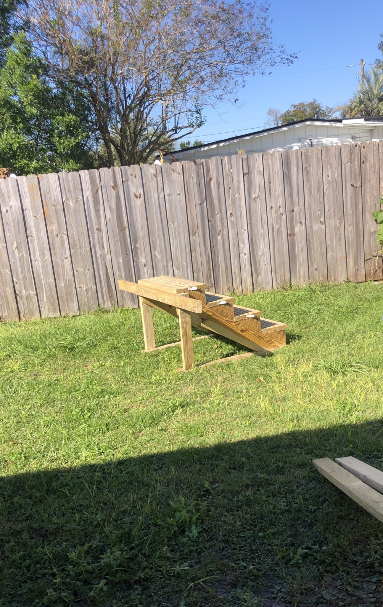

    They break down so they can fit in my Wrangler or the Camry and get set up by just me.

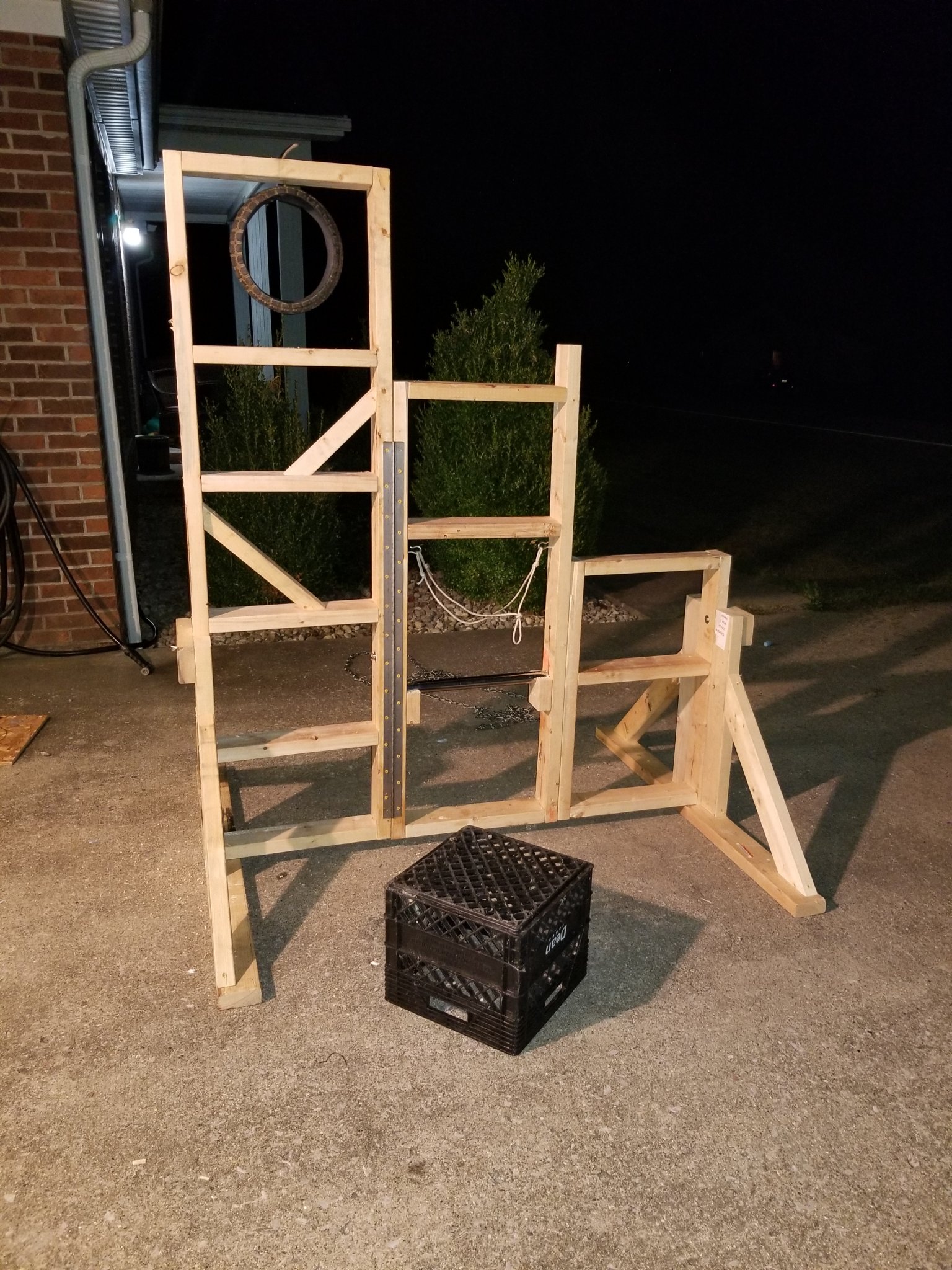

    This is my practice setup so far. I'll be adding a tank trap and rooftop barricade soon.

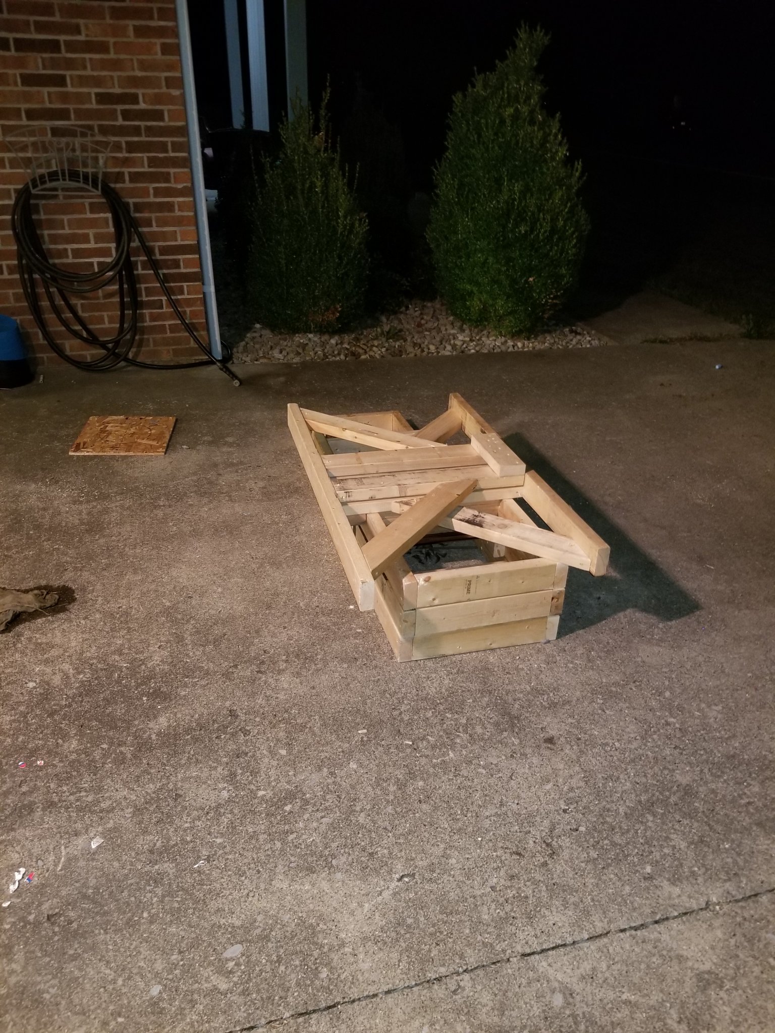

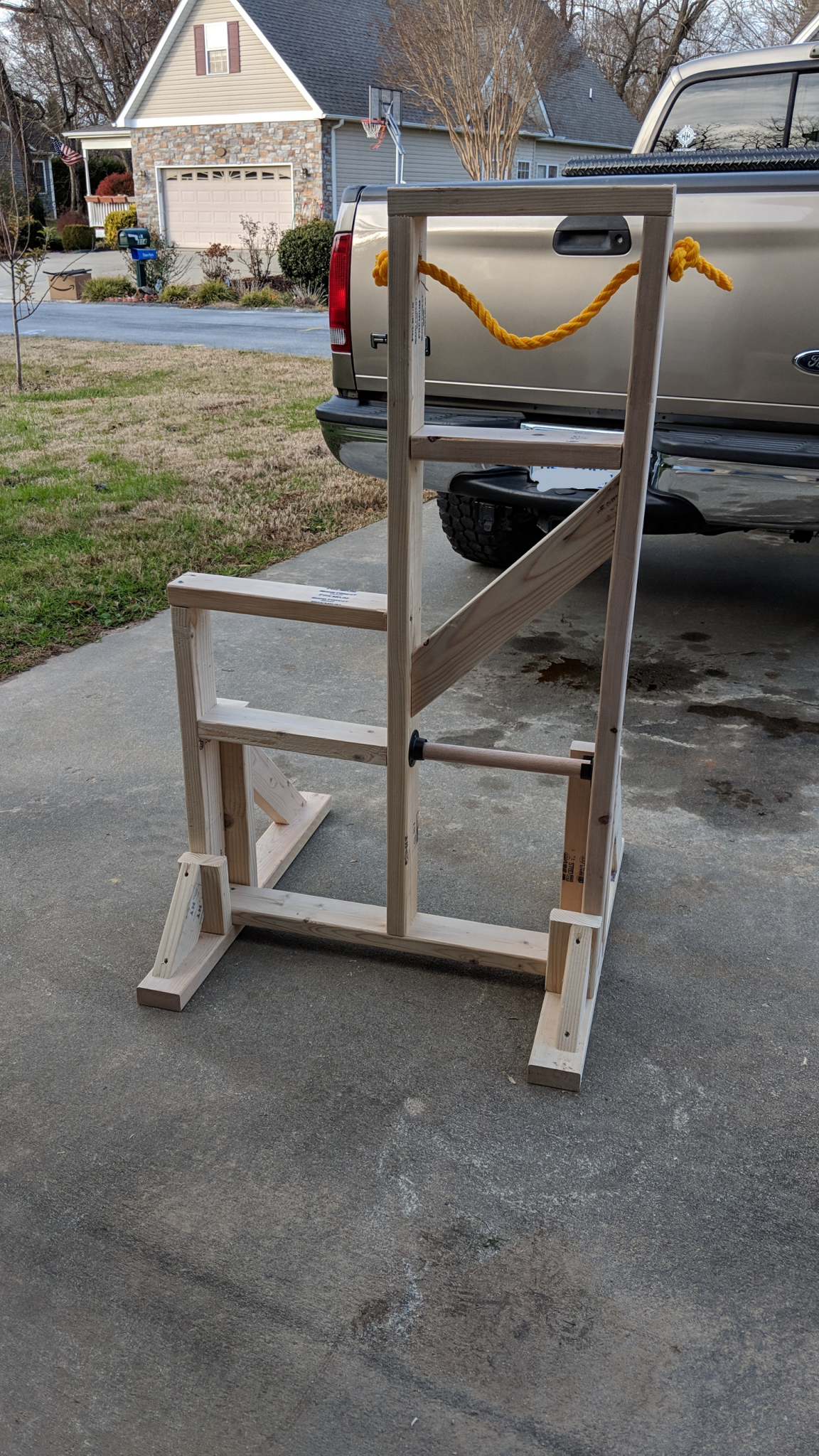

    Great plans may have to try out the tank trap
    Your plans worked great!

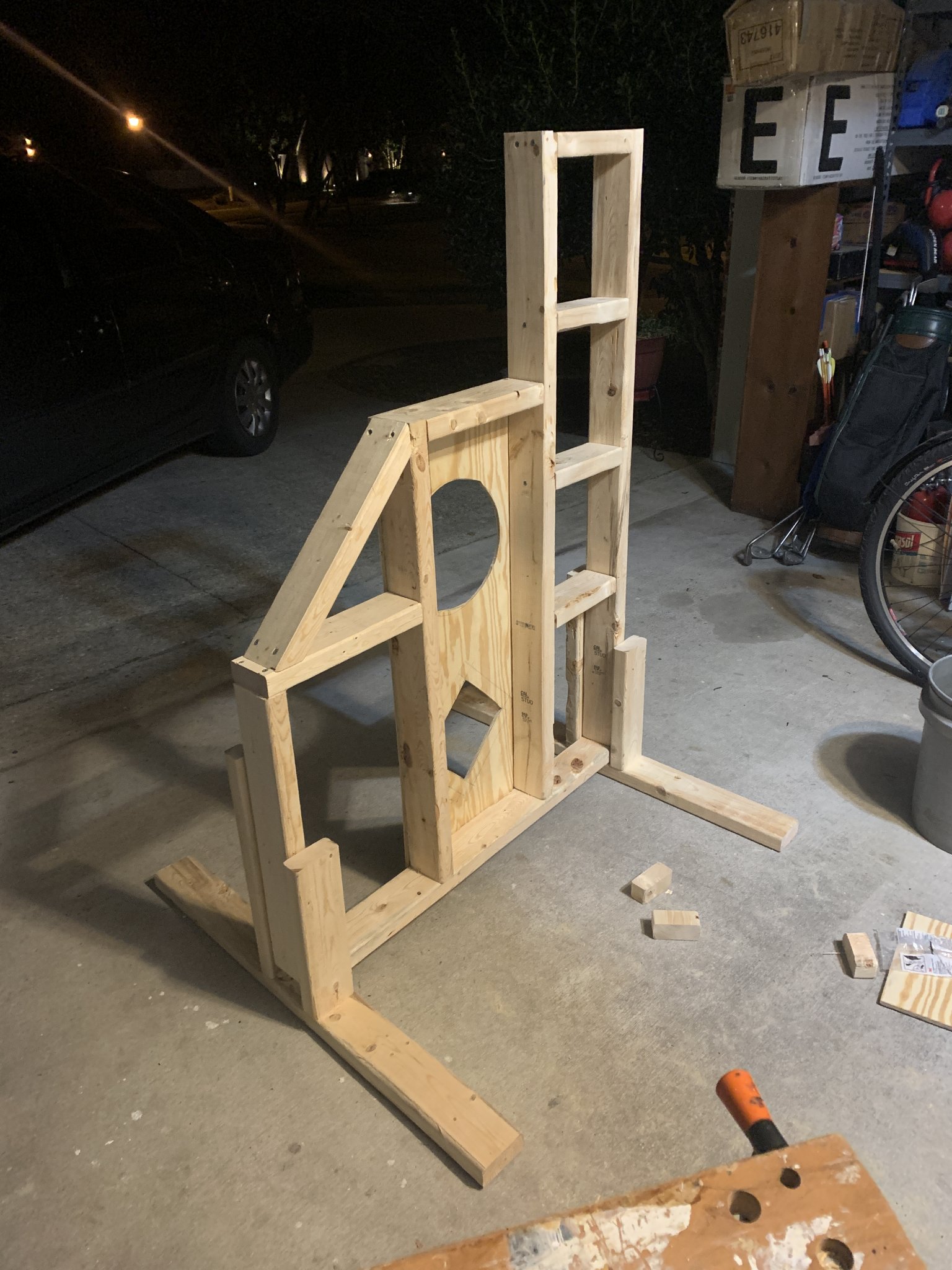

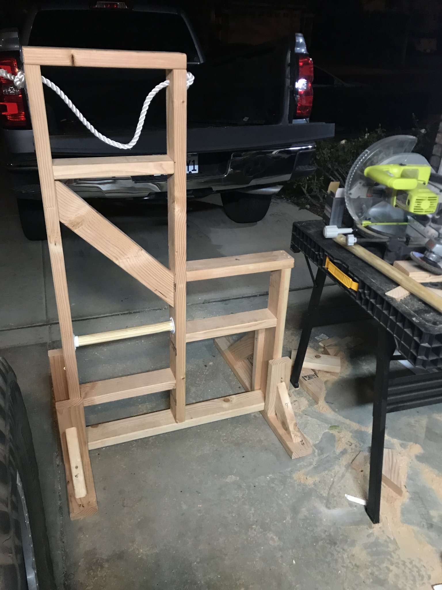

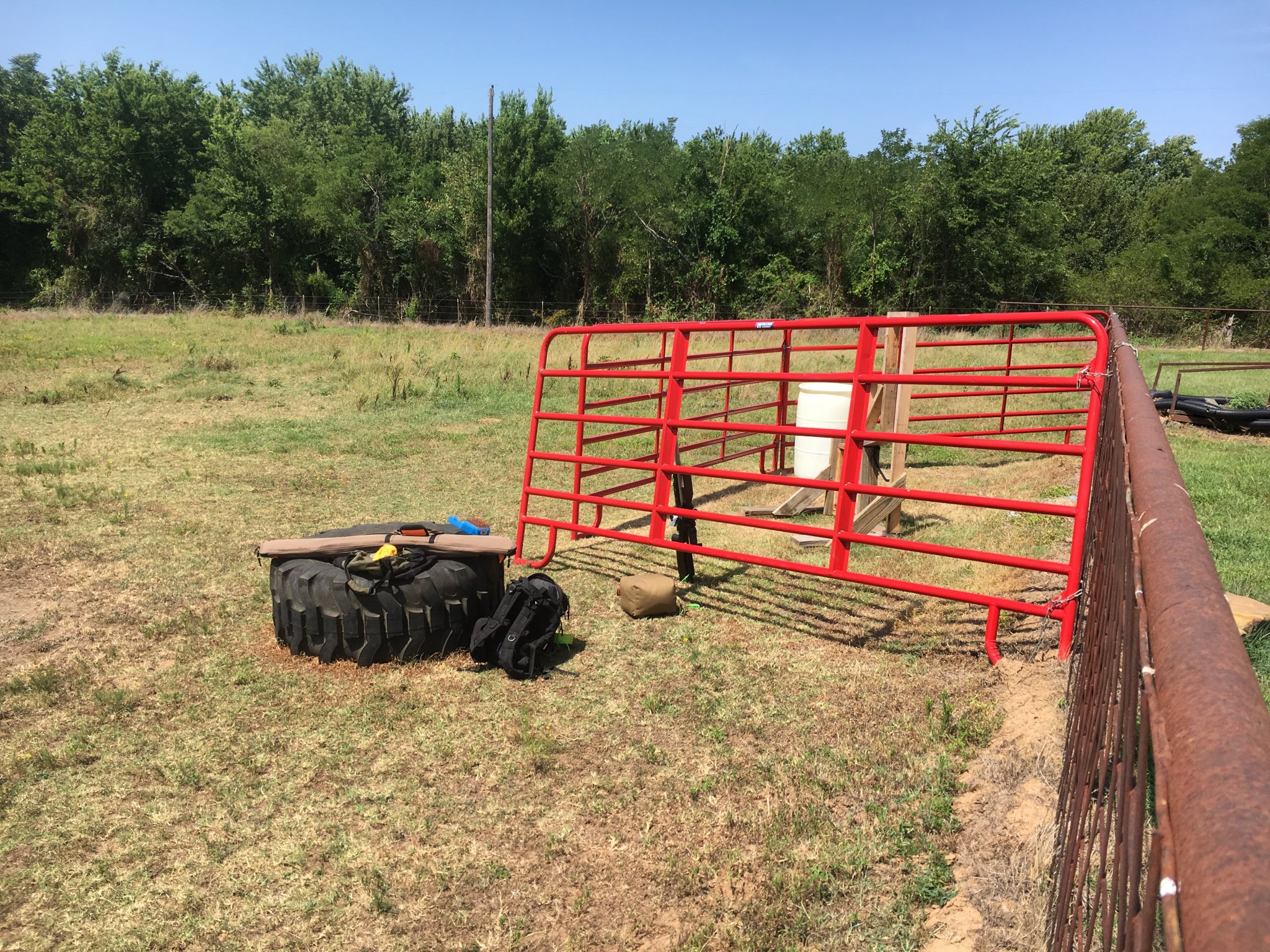

    Tires are a good addition too! Thanks for the plans on the tank traps that’s what I need to add to my setup.

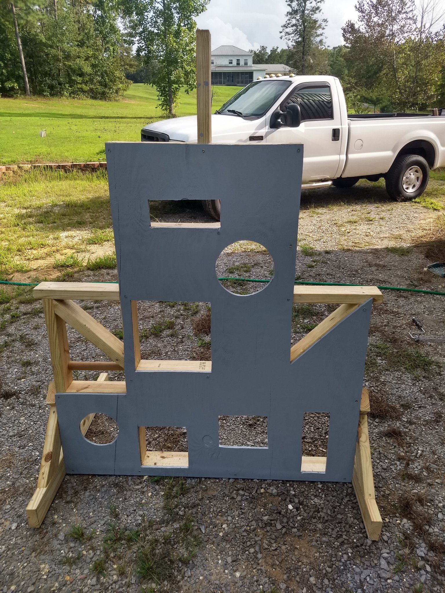

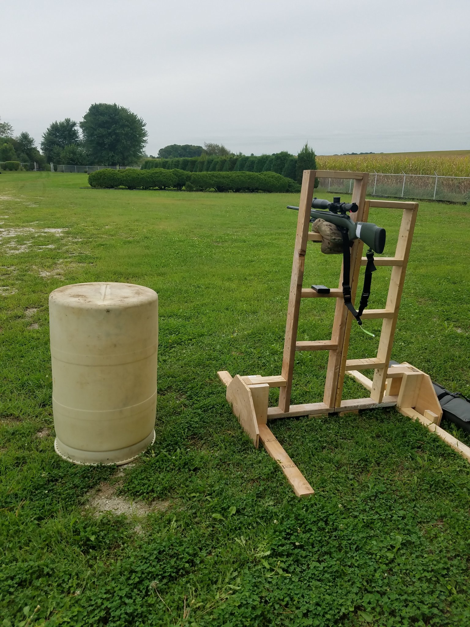

    Added a little color. Works good enough lol

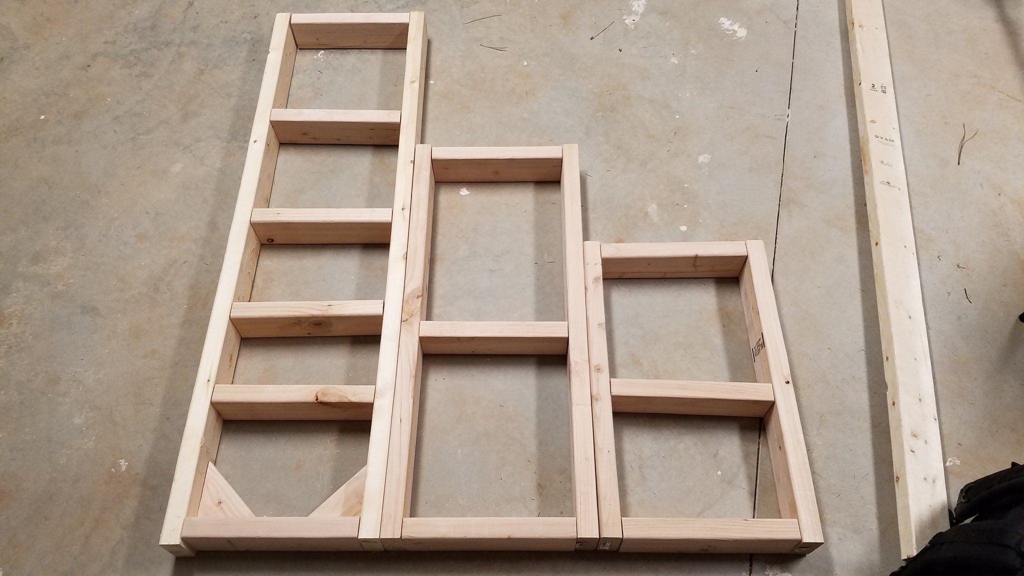

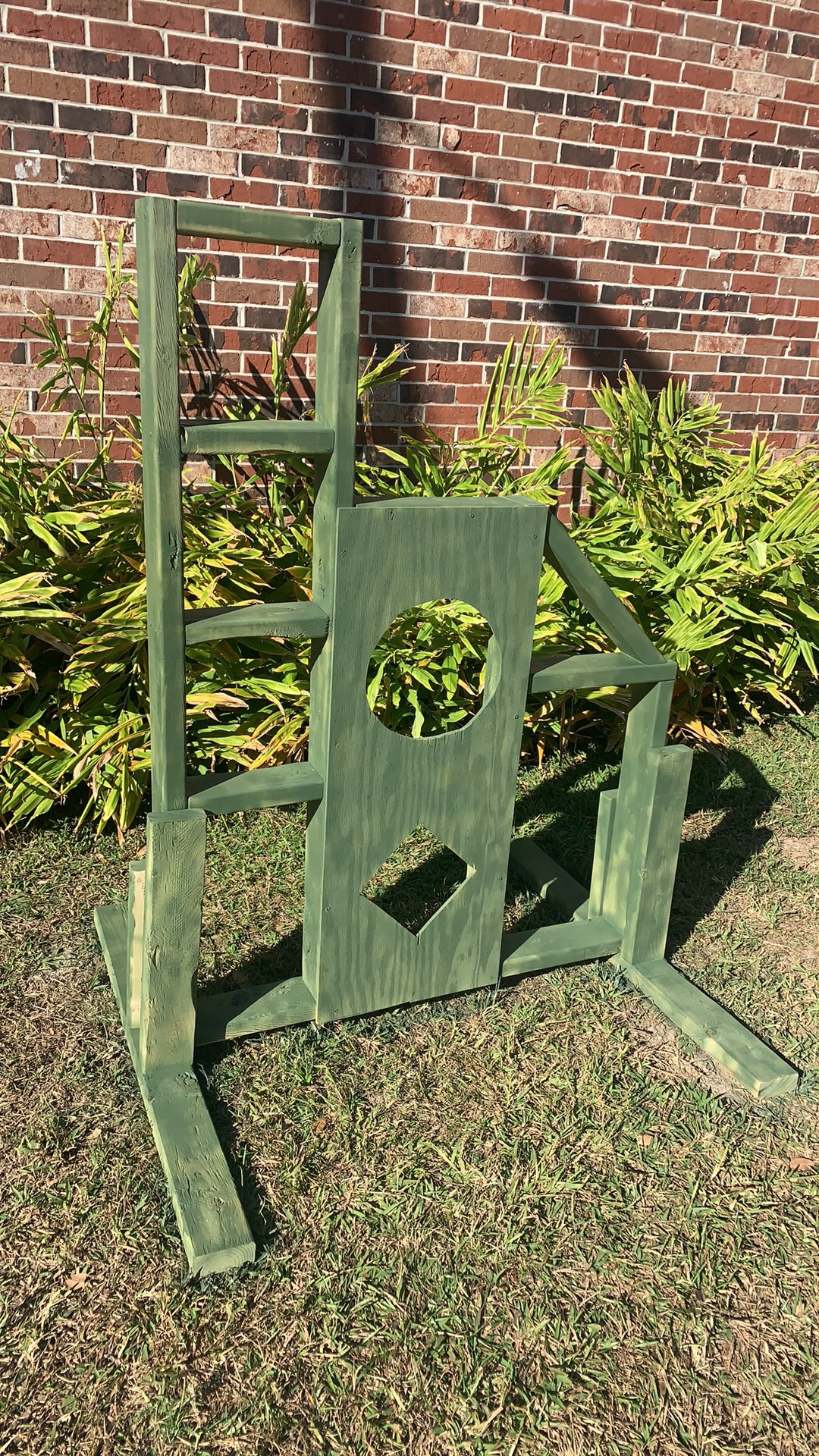

    Got tired of getting my ass handed to me on these at matches so i built some for backyard dryfire practice

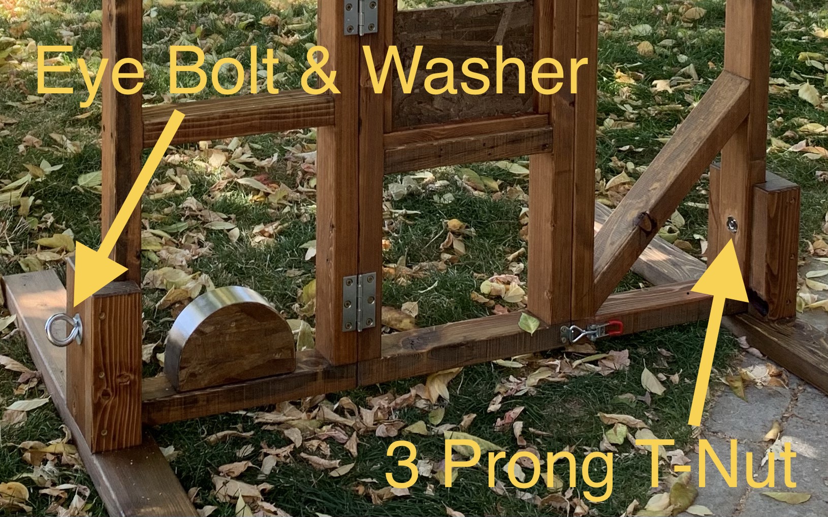

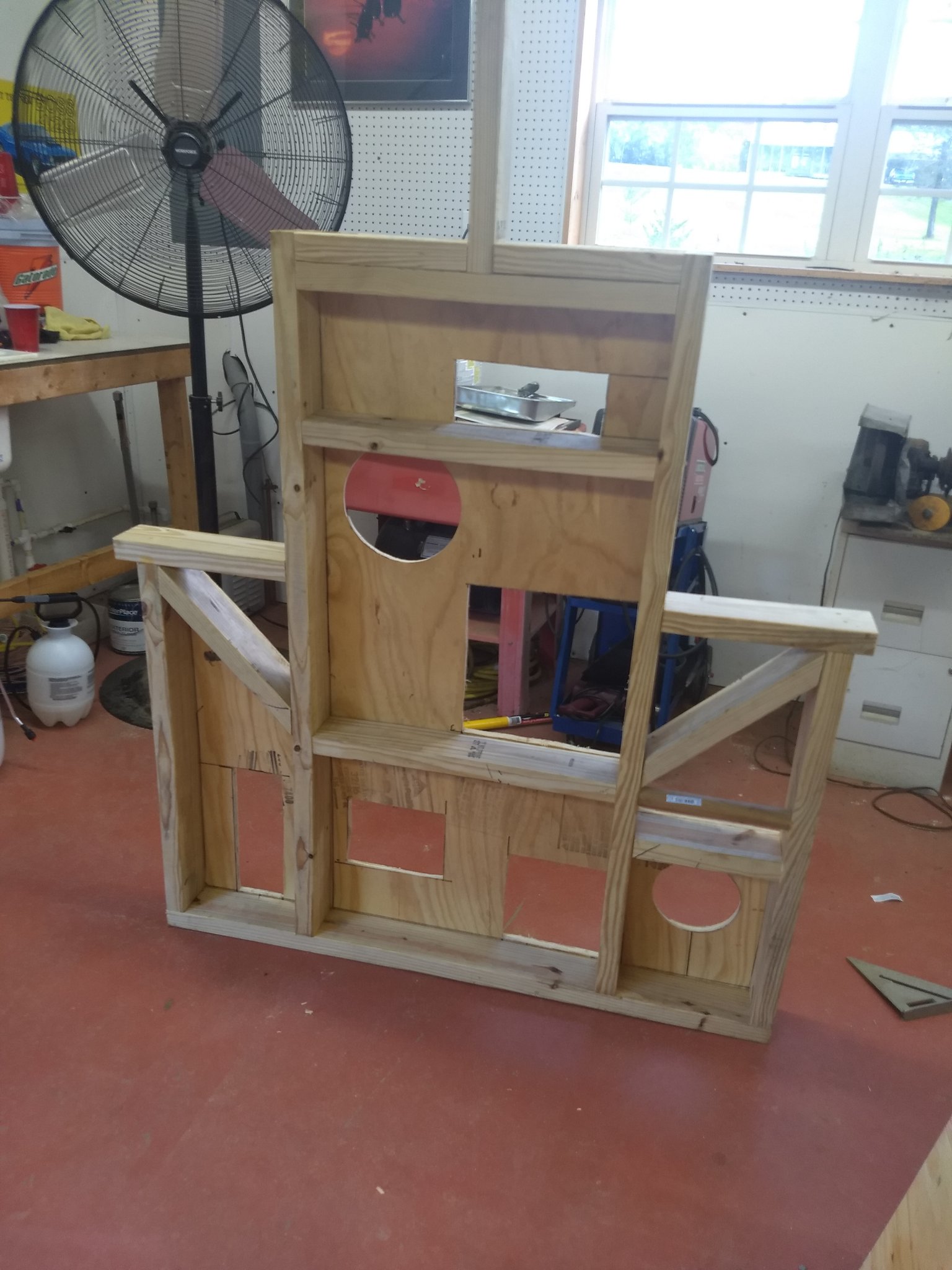

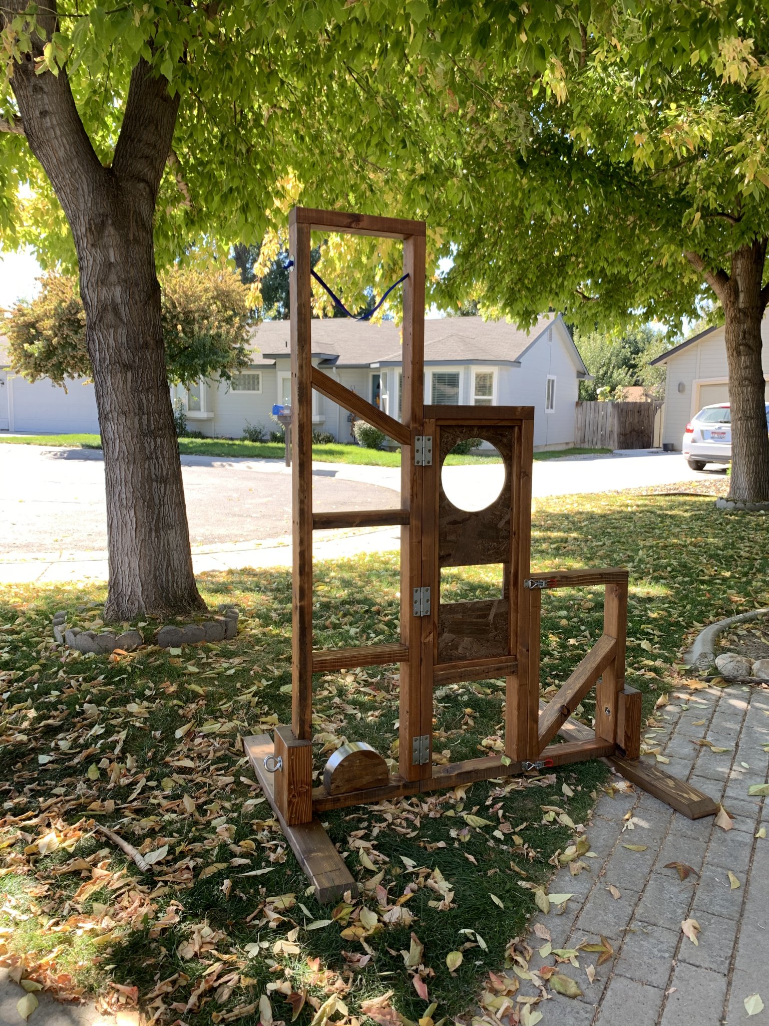

    This looks great. I have some questions as this is out of my league.
    Did you make the legs removable?
    What are the clasps on the right side?
    Are there hinges on the other side of the clasps?
    The legs are removable. I used a 3/8” 3 prong T-Nut on the inside of the frame and a Eye Bolt on the outside of the legs. This allows you to easily assemble and disassemble for transportation. The latches are known as toggle or draw latches. The ones available local to me were crap so I ordered theses off Amazon.
