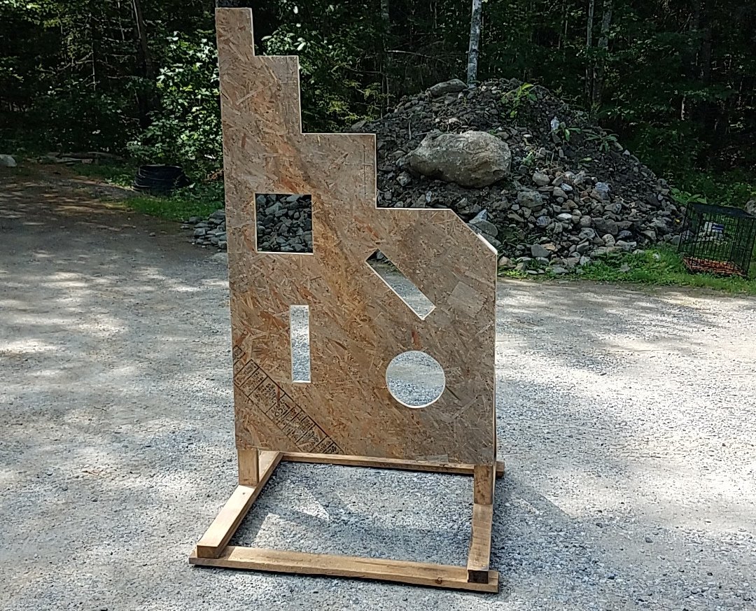

Read this thread last night, and it led to this, this morning.....
Had some stuff laying around and had to try for myself. I've used the ladder, a barrel, chairs, coolers, truck beds, the whole lot. I'll be the first to admit, this was more difficult to shoot from than any of the others. Once I calmed down, and stopped overthinking it, my process was similar to what @Sheldon N Sheldposted above. Light pressure, steady form, follow through. I'll be using this barricade every time I range trip now.

A sturdy baracade can do with some loading and your hand supporting (pushing into the baracade and somewhat downward) ontop of the scope. A rickety ass baracade needs free recoil technique IMO. You can make it worse trying to load into it.
