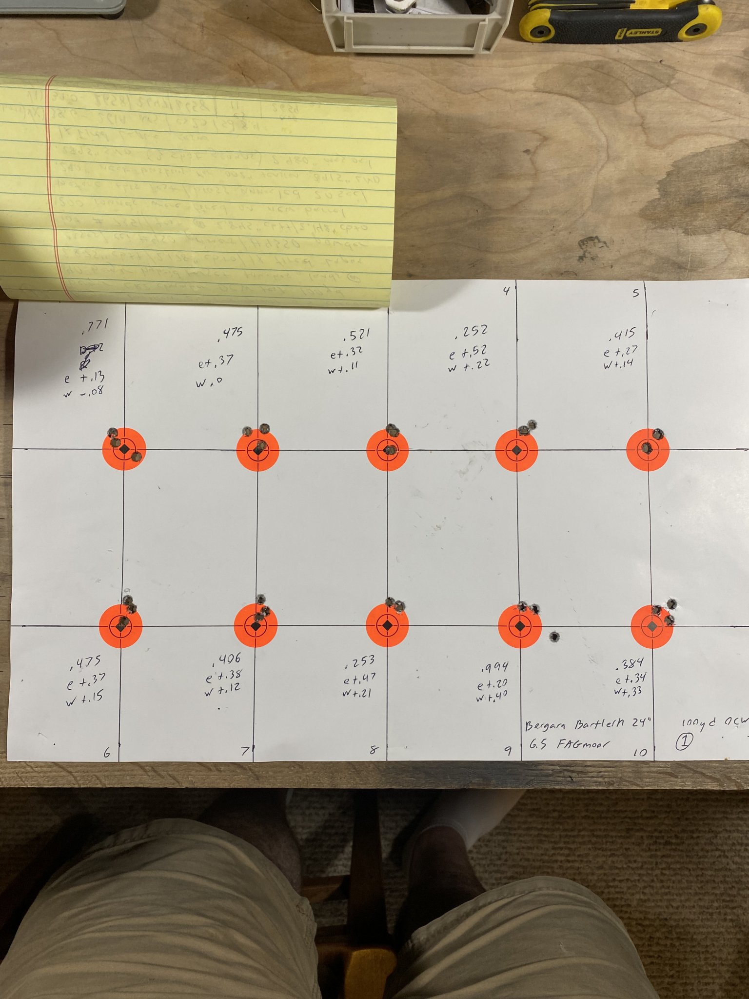

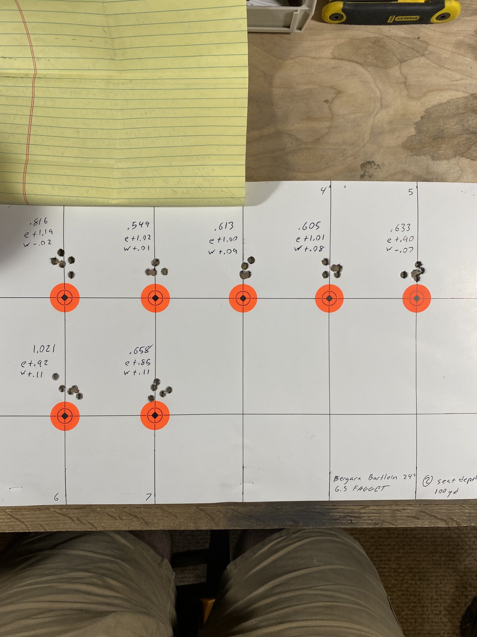

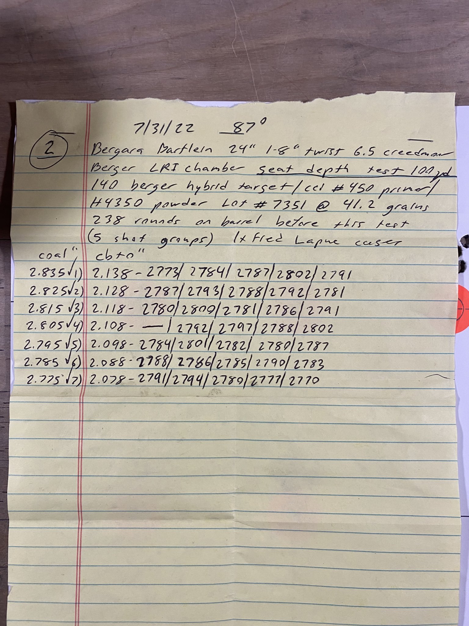

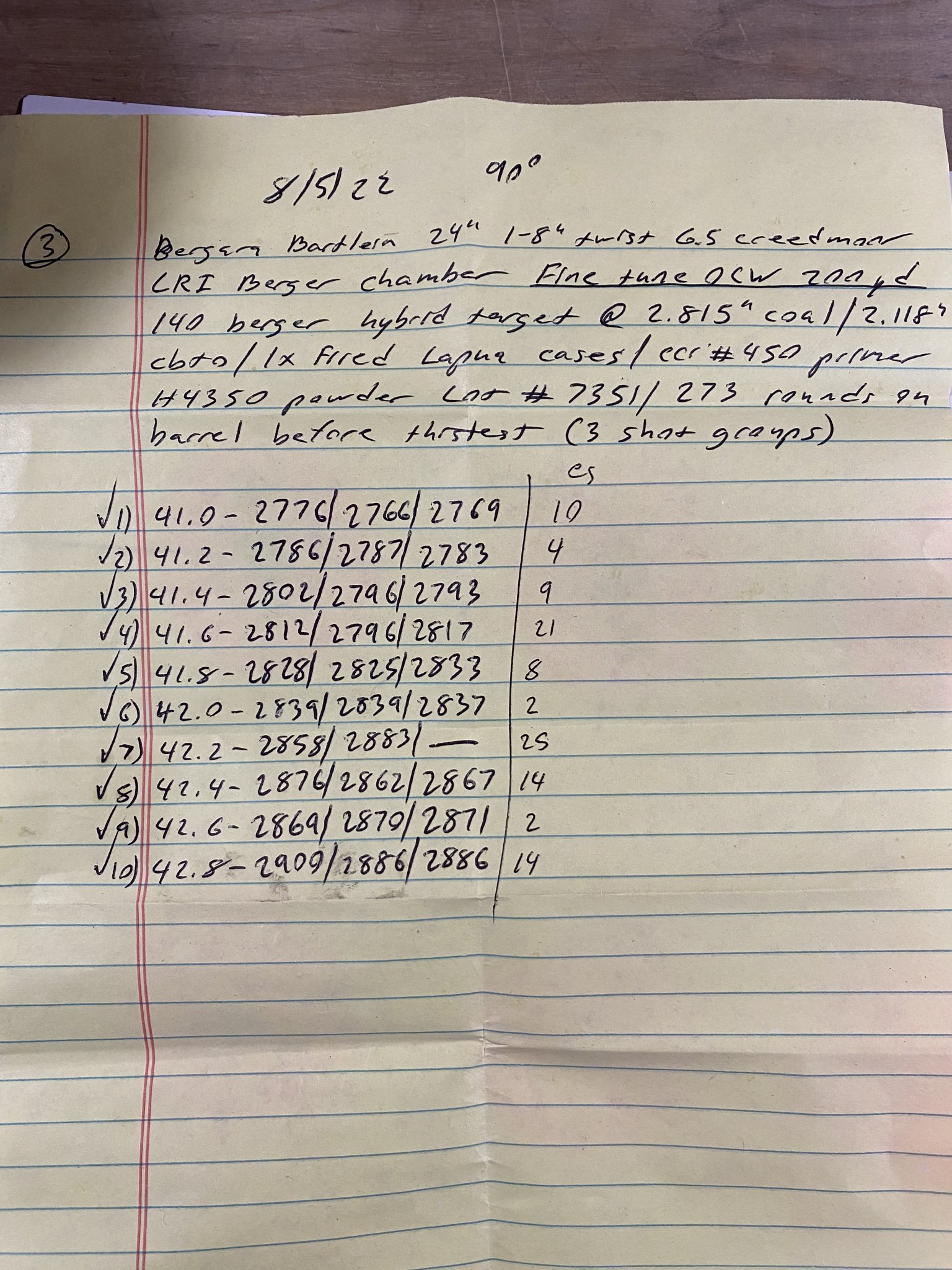

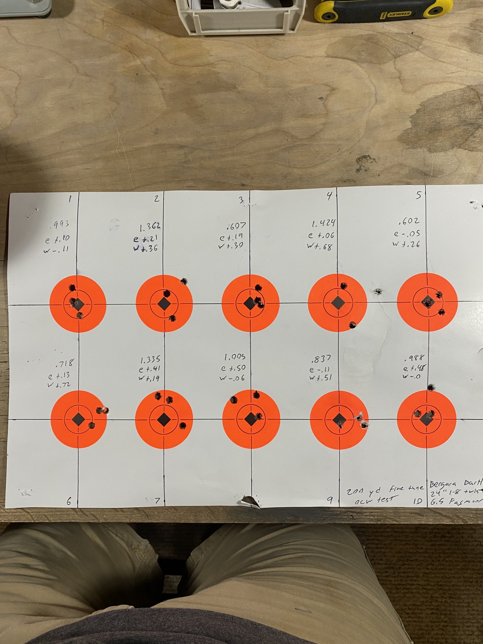

I’m kind of stumped at ocw results. Shot the first time at 100 yards then did a seat depth test then tried to fine tune the ocw at 200 yards. I find ocw is GREAT on smaller profiled barrels on hunting rifles but seems like I always have trouble reading the results when I try it on a heavier barreled rifle.
Bergara premier action
Bartlein 5r 6.5 creedmoor chambered by LRI
140 Berger hybrid
Lapua srp
Cci450

I would say 41.8 is your charge weight and 2.128 bto your seating depth. I would move that combo to long range testing and see how it tracks to begin building a ballistic profile. Overall it looks quite forgiving and shoots most combinations really well for a precision field rifle.
