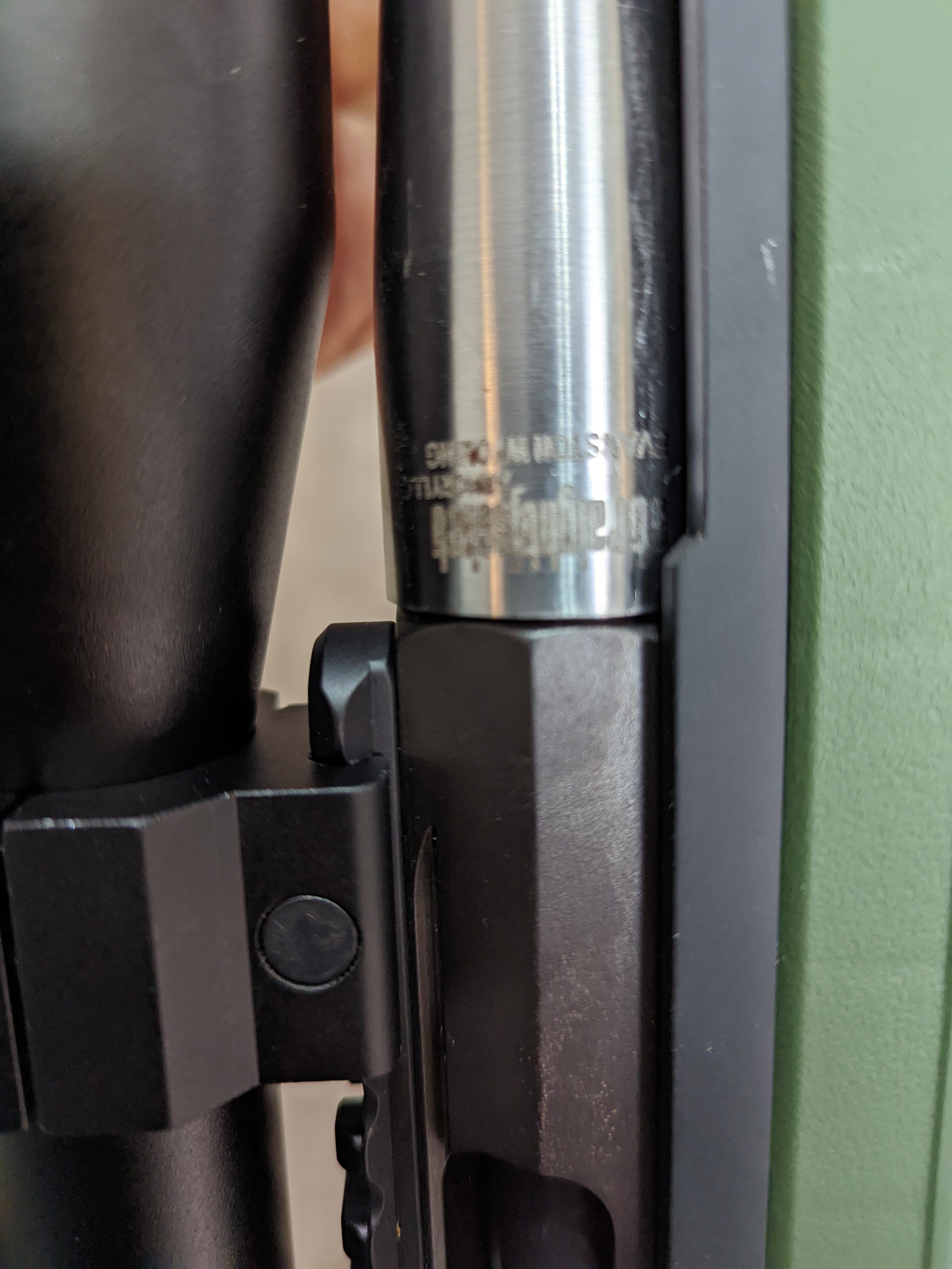

Gotta be careful ordering a fat bart for a Tikka.
Some folks think it's acceptable to send you something like this-
Needless to say, I don't like giving a gunsmith special instructions on how to do his job, so I order Tikka prefits from @bohem now exclusively.
Oh by the way, that was after waiting nine months and calling me twice to talk about ice cream and how he was too busy with phone calls to do his job ☝️
I mean this isn’t a Bart issue, this is #justSJAthings

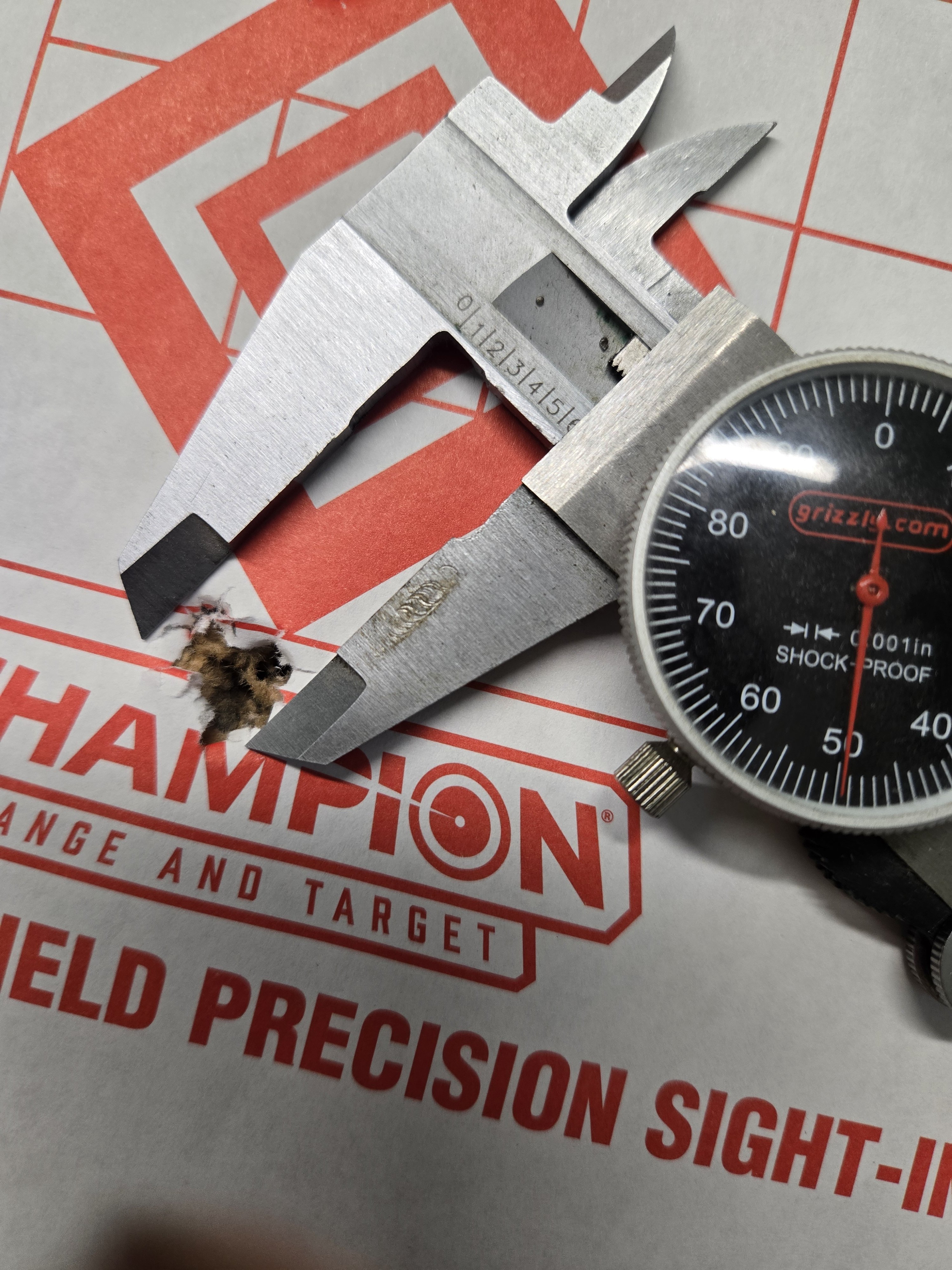

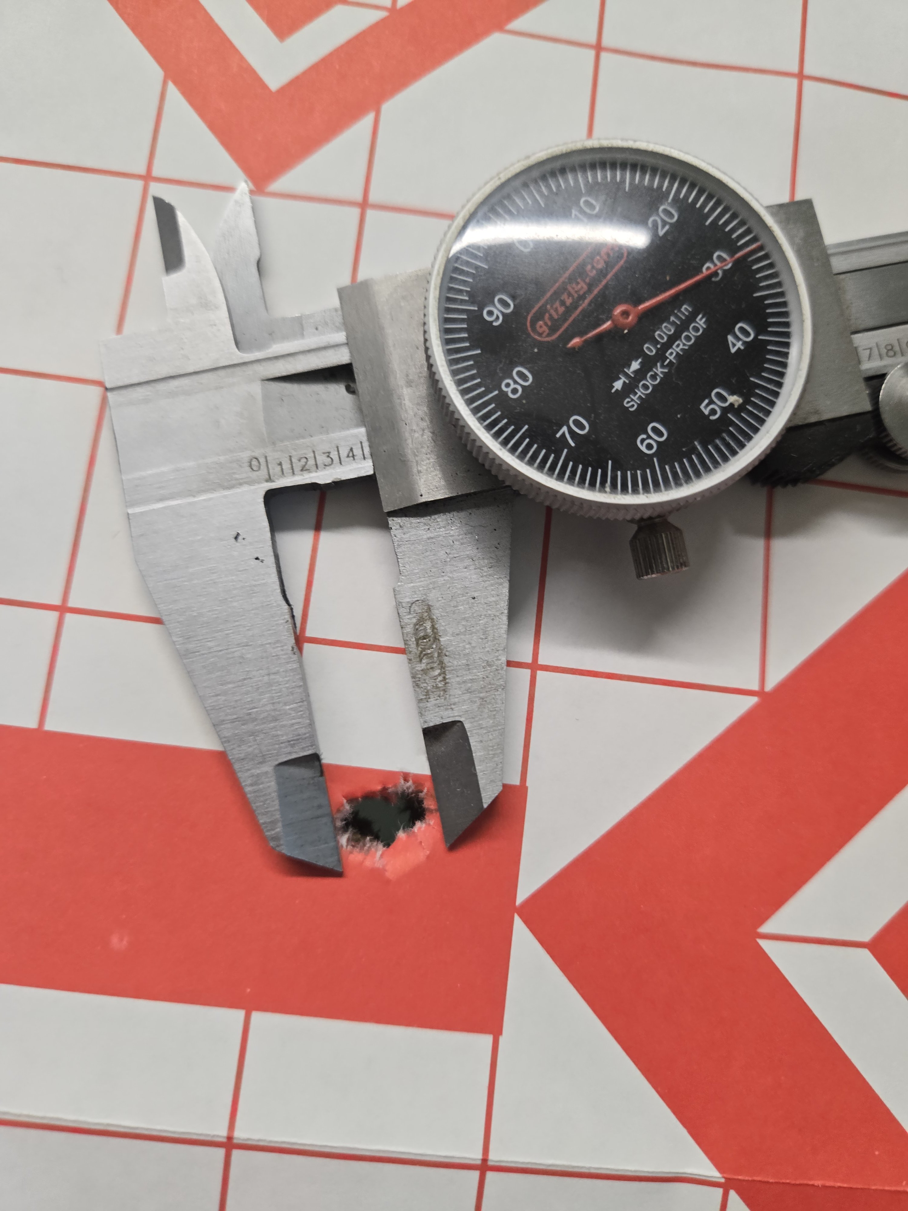

I have had PVA do prefits on Bartlein they were great. I have a couple of there Osprey carbon prefits and they are great also. hear are a couple of groups from the carbon Ospreys with there Cayuga hunting bullets during load development. the one is a 3 round group with 6.5 4S and the other is a 7 round group with 6.5 Creedmoor. They both shoot excellent.
I think there’s a reason you see the same barrels routinely show up on the firing line at f class and benchrest lines: bartlein, kreiger, brux.
If you personally can shoot the difference you’ll have to decide but these are in a league of their own when in the hands of a great gunsmith.

That kind of performance is borderline unheard-of (7 shots) in the carbon blank industry. Excellent shooting for sure! Nicely done.
