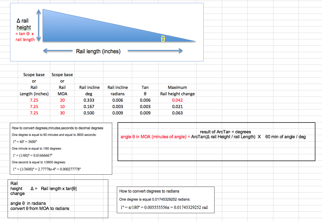

Lines up almost perfectly with your measurement using both formulas.
Looks like yours is spot on for a 20 MOA.
