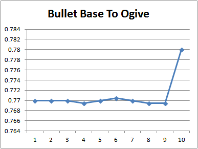

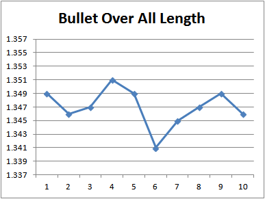

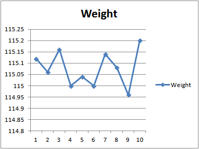

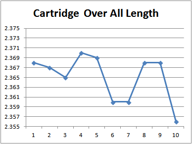

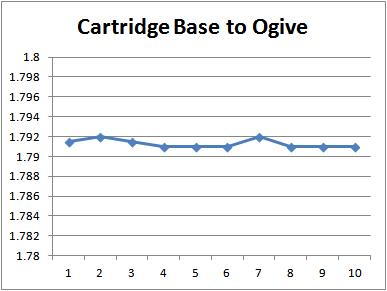

I posted this in my dasher 115 rdf thread but I took a sample of 10 and measured them along the way and these were the results
Bullet #Bullet Over All LengthBullet Base To OgiveCartridge Over All LengthCartridge Base to OgiveWeight
11.3490.772.3681.7915115.12
21.3460.772.3671.792115.06
31.3470.772.3651.7915115.16
41.3510.76952.371.791115
51.3490.772.3691.791115.04
61.3410.77052.361.791115
71.3450.772.361.792115.14
81.3470.76952.3681.791115.08
91.3490.76952.3681.791114.96
101.3460.782.3561.791115.2
Average1.3470.77092.36511.7913115.076
Max1.3510.782.371.792115.2
Min1.3410.76952.3561.791114.96
ES0.010.01050.0140.0010.24
SD0.002650.003050.004500.000400.07419
7109471
7109472
7109473
7109474
7109475
I say to not worry about the smaller variations as they should all seat to the same place.
