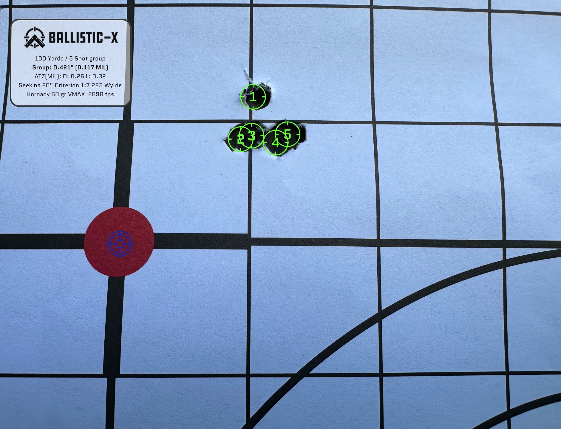

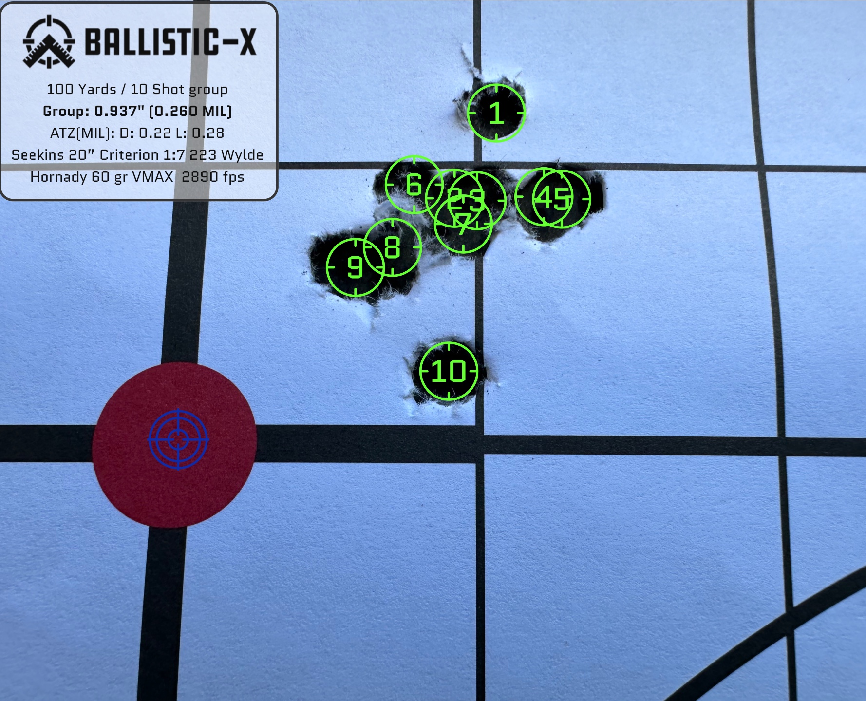

Laxammo has Freedom Munitions 60 gr VMAX. While not considered match, the “reman” is very accurate.
*Edit 4/22/23:
Here’s a 5 shot group and then completing 10 shots same group. Seekins w/ 20” Criterion 1:8 (disregard 1:7 in the photo)
Ballistic-X-Export-2023-04-22 20:58:12.381742.jpg
Ballistic-X-Export-2023-04-22 21:00:08.738131.jpg
