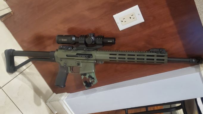

Reactions: 3rd Monkey

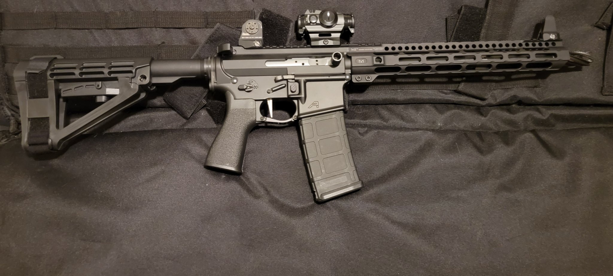

I’m very impressed with my 20” 556 1-7 standard uppper. I think I have 300$ or so in it. First two cold bore shots are in the bull, the rest printed pretty tight. Cheap Andersen lower with rise armement cheap trigger. The only thing I did was run a the tubbs final finish kit thru it before loading 73 grain elds with rl 15. I’m not sure if it helped or not, I didn’t test it prior.
I’m very impressed with my 20” 556 1-7 standard uppper. I think I have 300$ or so in it. First two cold bore shots are in the bull, the rest printed pretty tight. Cheap Andersen lower with rise armement cheap trigger. The only thing I did was run a the tubbs final finish kit thru it before loading 73 grain elds with rl 15. I’m not sure if it helped or not, I didn’t test it prior. View attachment 7854526
I was going to ask about the tubbs... but I saw the rest of your post. I have witnessed no difference between tubbs and a "normal" break in.

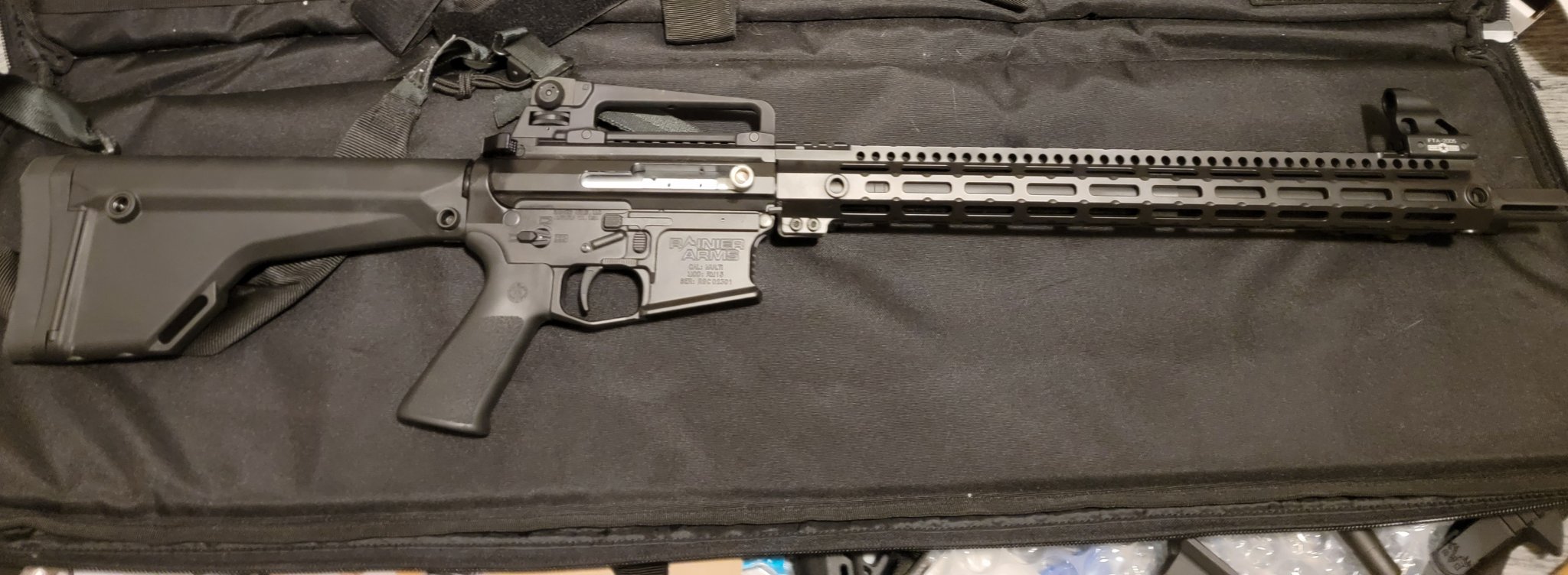

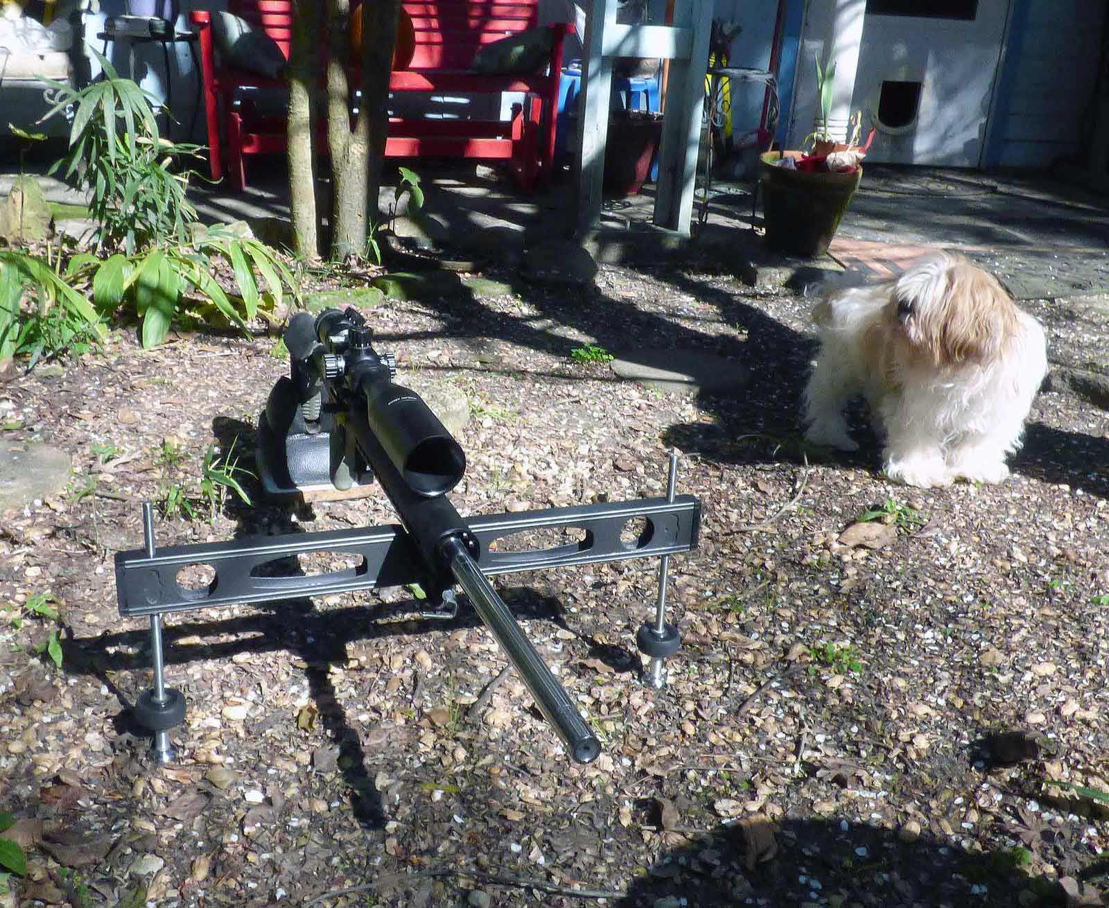

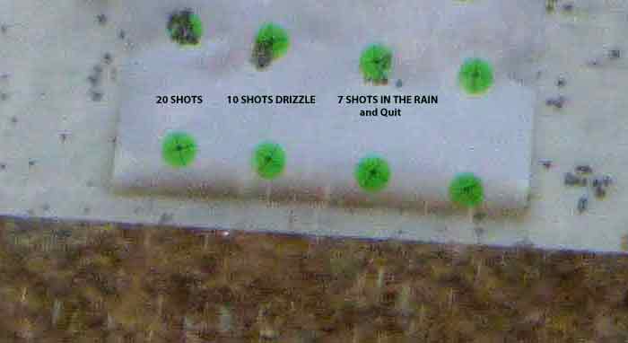

Here one of mine;
No-Gas port 28" barrel, Cut ejector spring, DIY ambi bolt release. Running LONG Loaded single shot off a sled.
Are we talking BCA low end complete uppers? or the BCA side charge receiver?
I have several and love it for prone shooting. Pretty strong upper.
Here one of mine;
so basically a straight pull bolt action AR. interesting choice
Yes. Since you have to single load for F-Class anyway, No-Gas isn't really a handicap.
Besides, it's just an upper. :)
Put together an almost identical one for the wife, but with gas.
Should be shooting it soon.
Both are X-Caliber, 28", 1:7, Bull, 5-R. One has a gas port :)

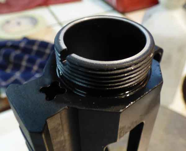

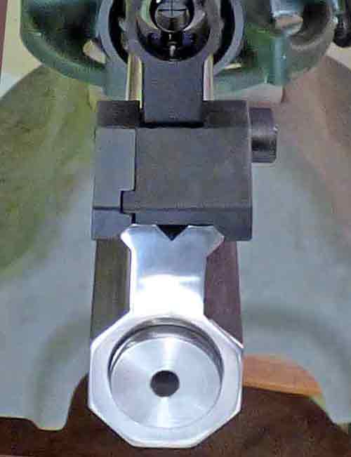

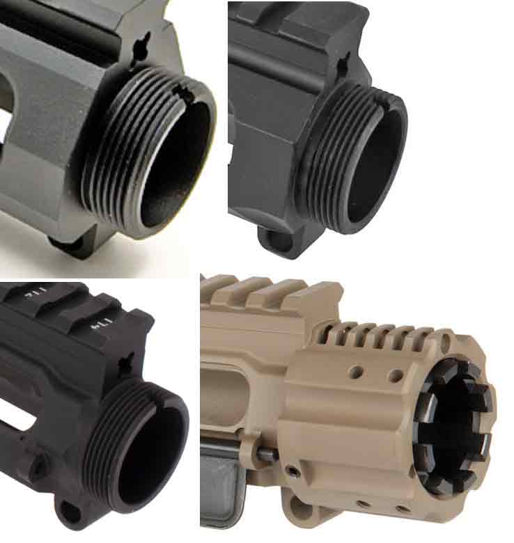

The receivers I have needed some lapping of the face for a nice complete contact circle.
They are NOT thermal fit like some high end uppers and will need some type of shimming.
I mask and spray rattle can high heat paint on the extension, burnish smooth with very fine grit for a real thermal fit (about 0.002" interference).
Heat receiver in oven to 200+F, barrel in freezer @ about 4F. Slip together and hand tighten nut until parts are near room temperature.

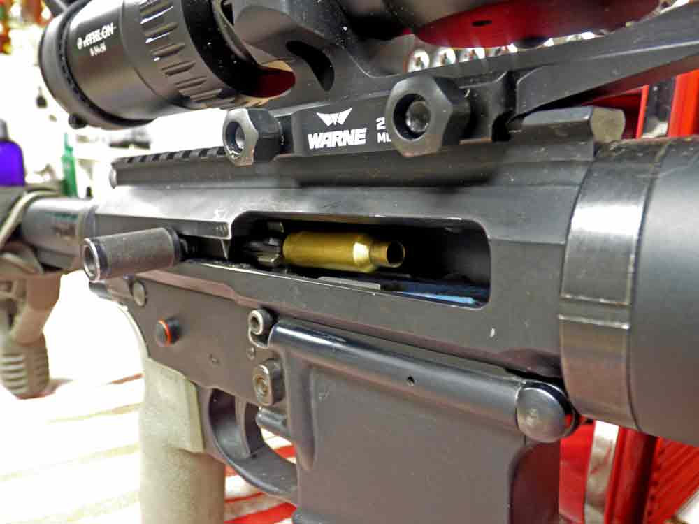

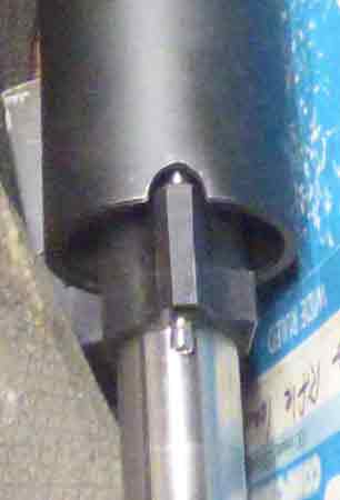

I will mention the only drawback that these have is you have to unscrew the charge "knob" to remove the bolt for cleaning. Could be something of an issue if you need to remove the bolt in field.
You are correct. When shooting prone I keep a hex wrench in the ammo box just in case and a spare BCG in my range box.
Gen 1 Vs Gen 2 knob
Made this handle for a regular Carrier that doesn't need a wrench :)

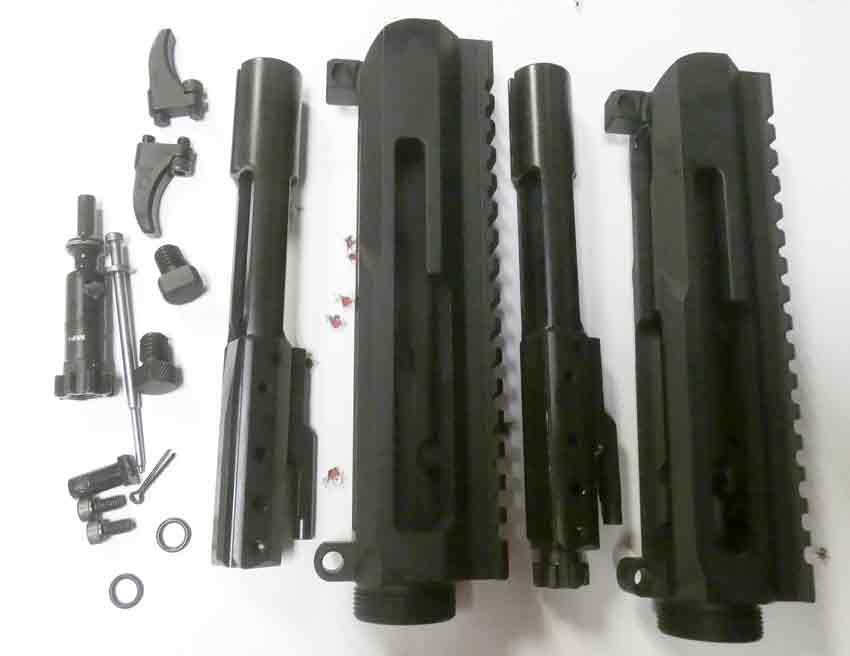

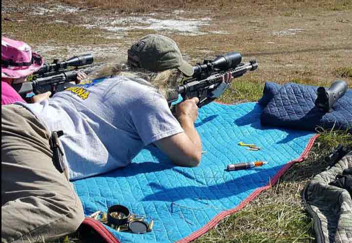

Here's another pic of a couple BCA upper receivers back in 2017.
Wife shooting a 22" .223 Wylde, and me with a 21 inch Heavy barrel blank. Both Green Mountain barrels.
Lots of sand around and got some in the rifle, probably through the missing dust cover, during sight in.
Dust cover opens on a regular receiver after first shot so can't blame the BCA receiver.
Just felt a little rough and didn't want to damage anything.
Had a back up upper and shot that.

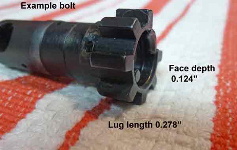

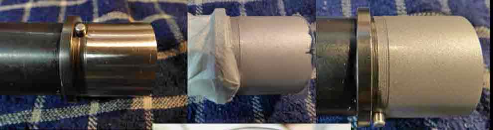

only comment I have is if you plan to use anything BCA, gauge the crap out of it to make sure it's a good part before taking it to the range.
common issues with the carrier is the bolt race being oversized leading to gas bleed, and headspace and firing pin protrusion problems.
Guess I've been lucky.
I use a LWRC 6.8 bolt for the 22 NOSGAR and the BCA 5.56 bolt in my No-Gas 22N.
The wife's Gasser has about 400 rounds on it now with no issues (gets dirtier than my No-Gas :) ) and over 2000 rounds on mine.
Out of ALL my bolts, spares included I've NEVER found one that varied in headspace more than 0.001".
0.154" to 0.1545" with a spec of 0.156" -0.003".
Pin protrusion is pretty easy to measure @ 0.028" to 0.036".

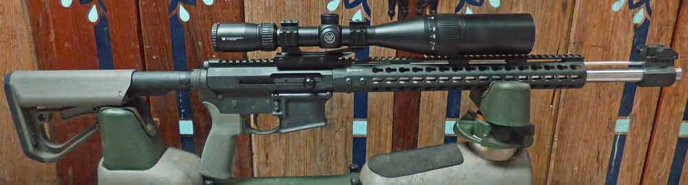

I run one... I shoot left handed anyways and wanted something that didn't leak gas in the rear. I'm using just the upper and BC. Cam was extremely gritty/sticky and was replaced with a POF roller cam. Barrel fit was decent but I still use bearing retention compound.
Overall I wouldn't really recommend but if you're looking for an AK style side-charger, that's the ticket. Completely fine for my application.

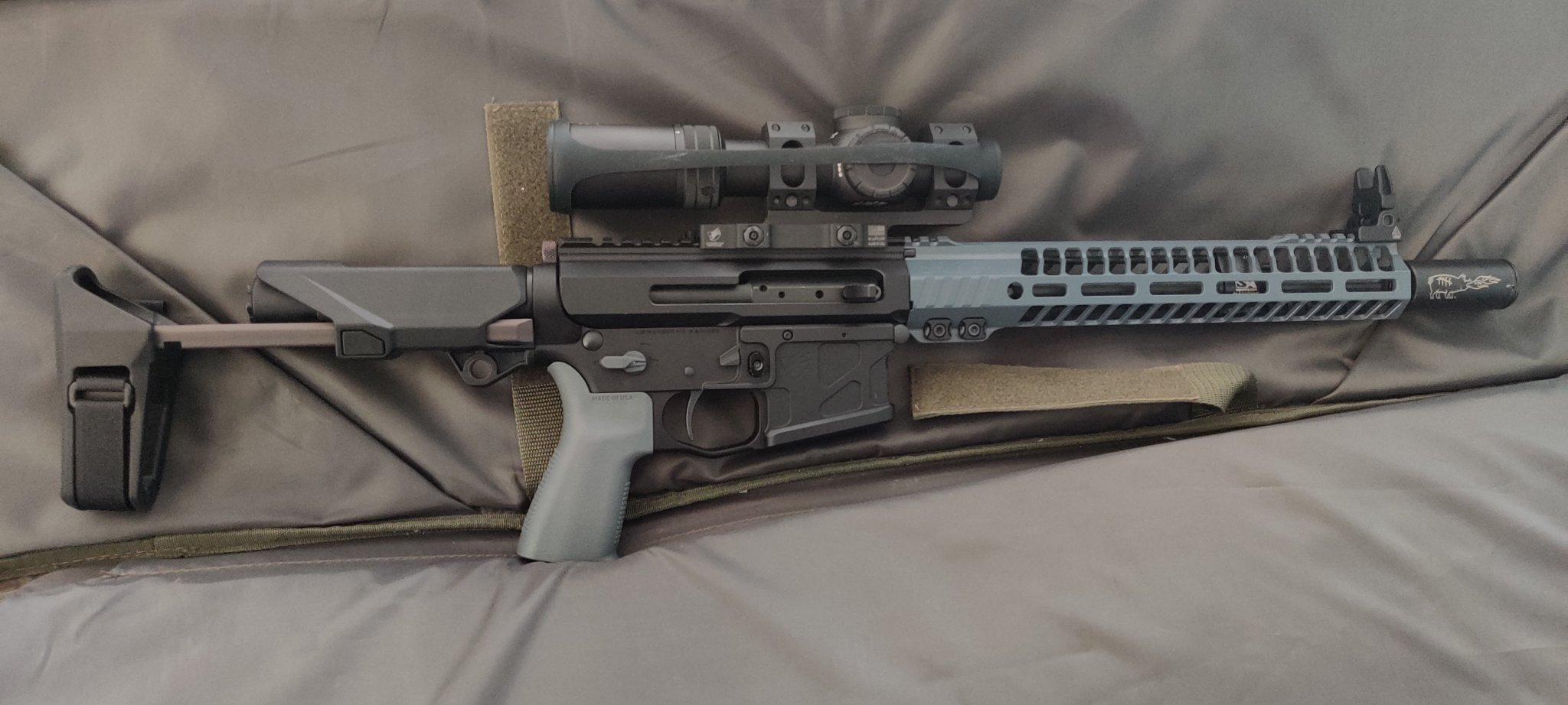

With heavy barrels (0.936" gas journal) handguard clearance to gas block may be an issue.
Had to cut a little clearance for the wife's gasser

Forgot to add, 24" barrels on my 224V gas guns.
The 28" will likely give a little more speed. Shooting prone, I picked the heaviest profile they offered.

I don't think a thin walled upper would handle the weight as well as the BCA (or other stronger upper).

I put a AMU Shim in each of my long barrel uppers and shim the adjustable stock to eliminate rattle.

Here's some 100 yard practice on a rainy day. 20 shot average was 3010fps with a LabRadar.
Great information. I agree that the BCA side charging upper (I have two) is thick enough for the job. I also have one of the LaRue 2 stage on one of my 224V gassers. As a side note, I've gotten 2930 fps with the 85.5s out of my 24" Valk (can't swear to accuracy as I was only testing for speed) but a "bolt" gun or facsimile should be a bit faster and a lot nicer to brass.
