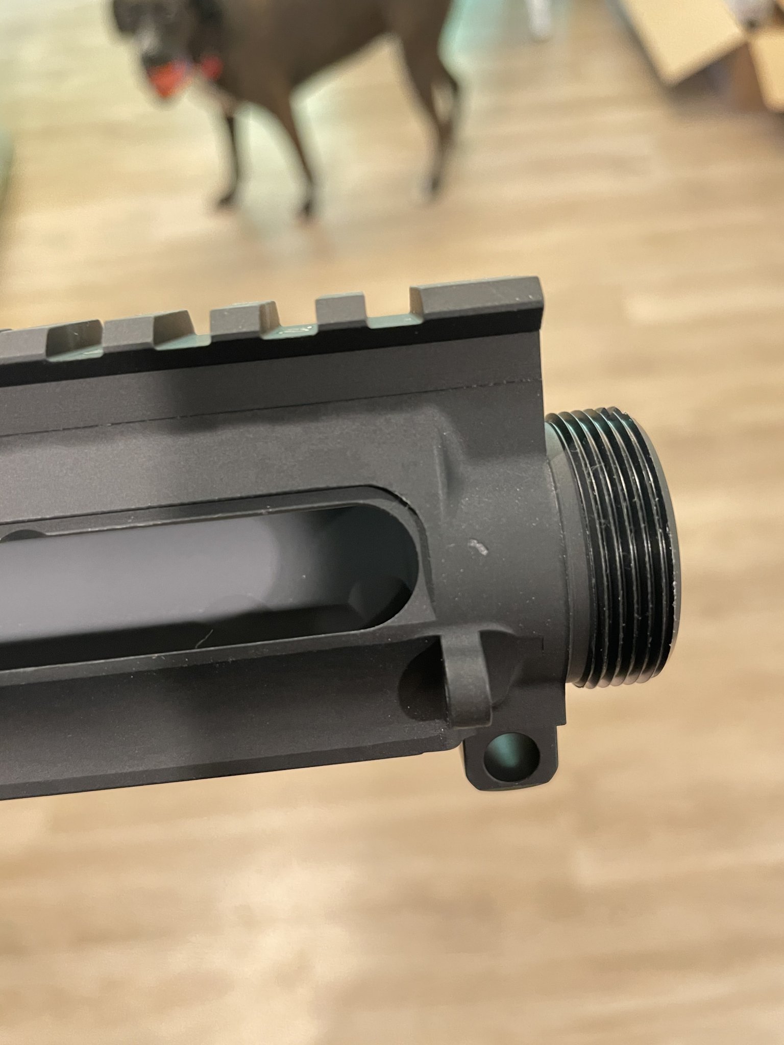

    Mine showed up today. Tiny blem on the side of 1 (you really have to look hard to see it) & the other I cant find a thing wrong with it........nada nothing.
    Lol, I mean, it is technically a blemish. Not one I care about. My rifles get used, no safe queen ARs here. View attachment 7625325

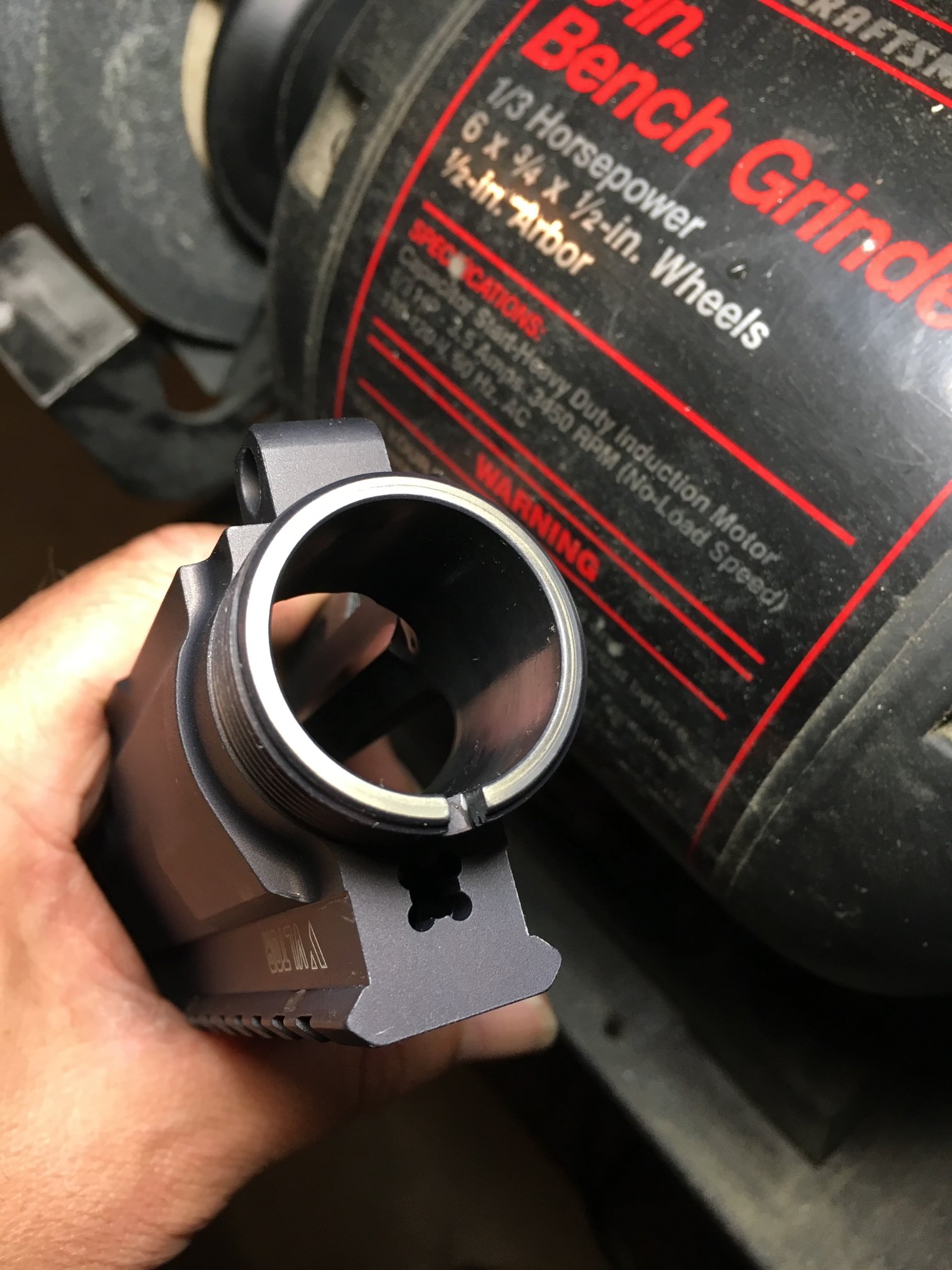

    Every upper I've ever lapped has taken some time to true in (VLTOR MUR, Aero M4E1 & std, BCM, & billet).
    It's kind of surprising really given the capability of modern CNC + the fact it's well known this mating surface is important. They must machine that damn extension face in about .2 seconds. It should be dead nuts & I'm baffled as to why upper lapping jigs are even still relevant.

    After speaking with an anodizing rep, he did say the anodizing could be part of the issue. He told me anodizing is rarely a even , uniform thickness, and even the items position in the tank can produce different thickness.
    Yep I've thought about the anodize being partly to blame & haven't completely ruled it out.
    The one thing consistent with all the uppers I've lapped is that I'm lapping .001 - .002 bare aluminum on part of the mating surface before getting through the anodize on the rest. If it were just a variation in anodize thickness I should be lapping off the thick anodize portion & then hitting bare aluminum all the way around once through it. That's not what happens though.
    Either the anodize process is causing a warp in the aluminum or it wasn't flat before anodize. I'm leaning towards the latter.
    Left side of below pic (VLTOR MUR) you can see on the left side a few thousand's have been lapped off and the right side anodize just came off.
    Brownel's lapping tool + fine compound was used.
