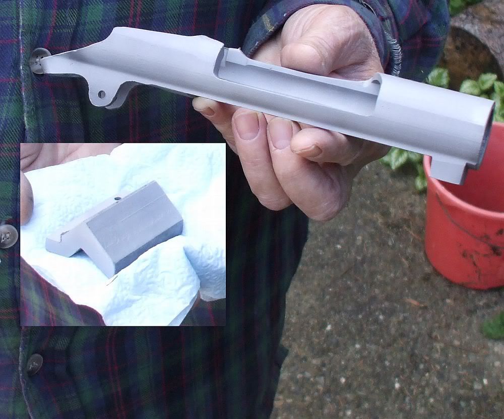

Last month I asked my brother to TIG weld a steel mount to the rear of a 91/30 receiver.
So he sand blasted the mount and the receiver, the whole receiver!
I was worried that would make the bolt lug abutments and the bolt bore rough, but a couple strokes with the bolt and it was smooth again.
The milled and filed Picatinny rail maybe too smooth, but the sand blasted receiver steel soaks up G96 and Oxpho cold blue or paint like fresh plowed ground soaks up piss.
