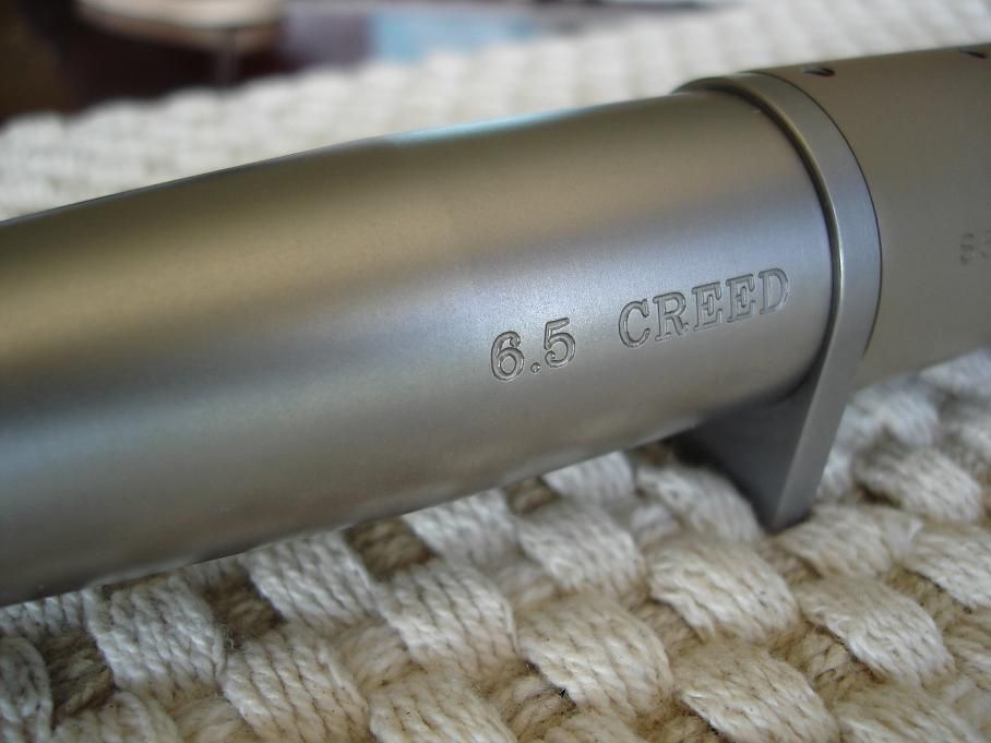

this was done with 60-120 grit glass beads at 80 psi. it's not hard to get an even finish but it's good to take it out of the cabinet into the sun a time or two during the process to make sure you didn't miss any spots. when using alox, it's much easier to see exactly where you've covered wile still in the cabinet than it is with glass beads. it would take a lot of work to over do it with glass beads though.
