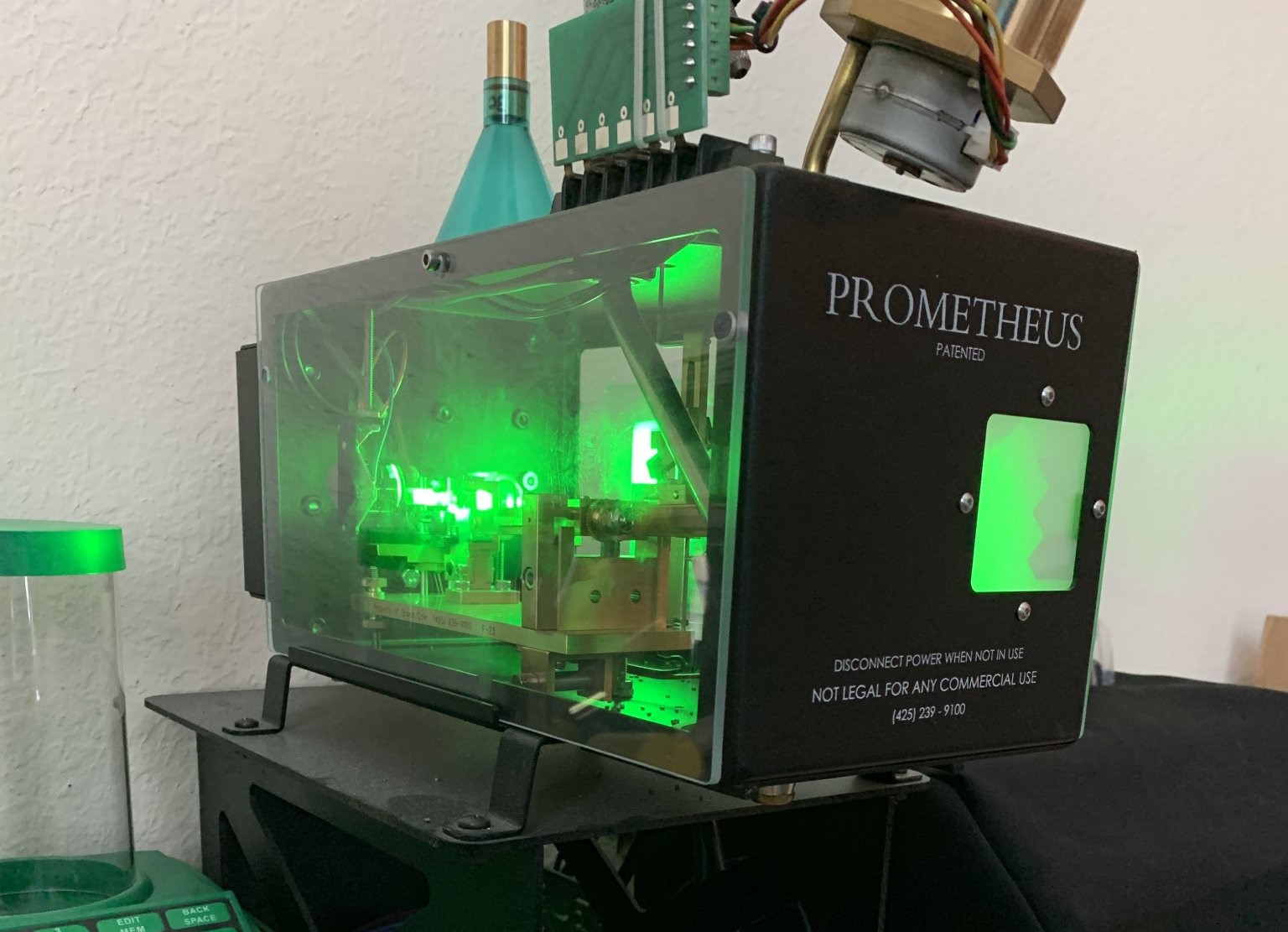

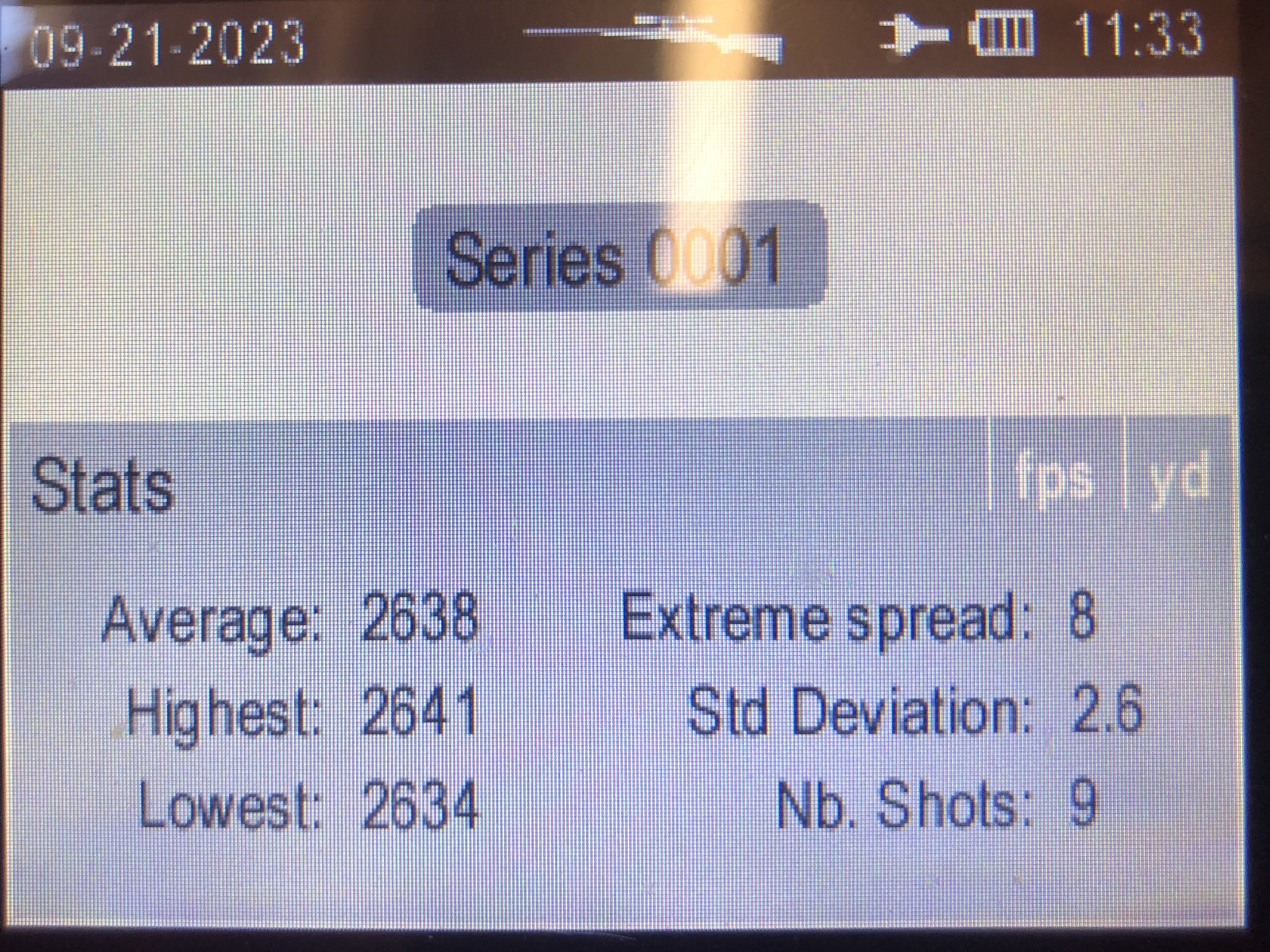

A properly tuned beam scale will run with an e-scale…. This from my Scott Parker tuned OHaus. It reads to the kernel. 43.3 N-150 / Berger 200-20x.
I have two scales that he tuned - very consistent scales. I'm happy with my ST but keep them around as an solid analog option if needed. Avoid anything with a threaded poise (mostly the models ending in 05) for better consistently. I do remember that Scott wouldn't tune most scales with a threaded poise.
Impressive.. do you mind telling me your process as far as sizing the brass? And any other things you’ve learned that greatly effects ES/SD?
