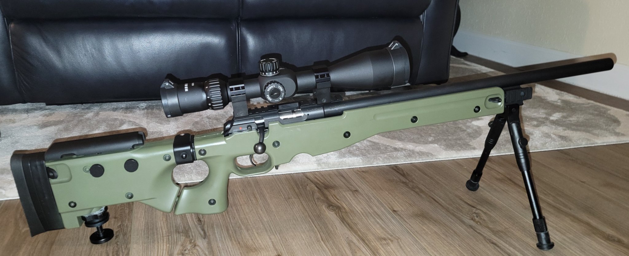

I'm going to show the final outcome, first, then provide the overall details of this build.

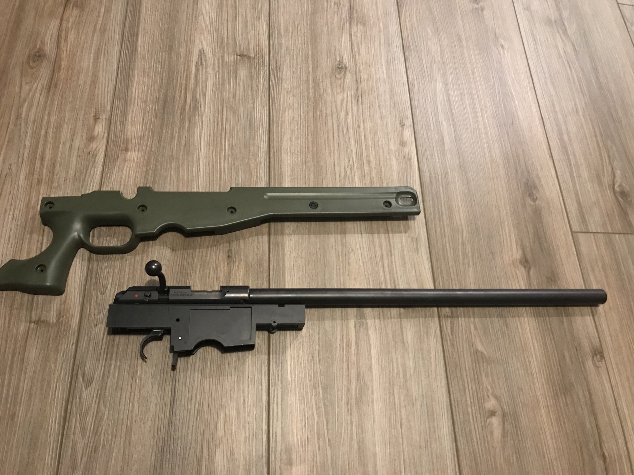

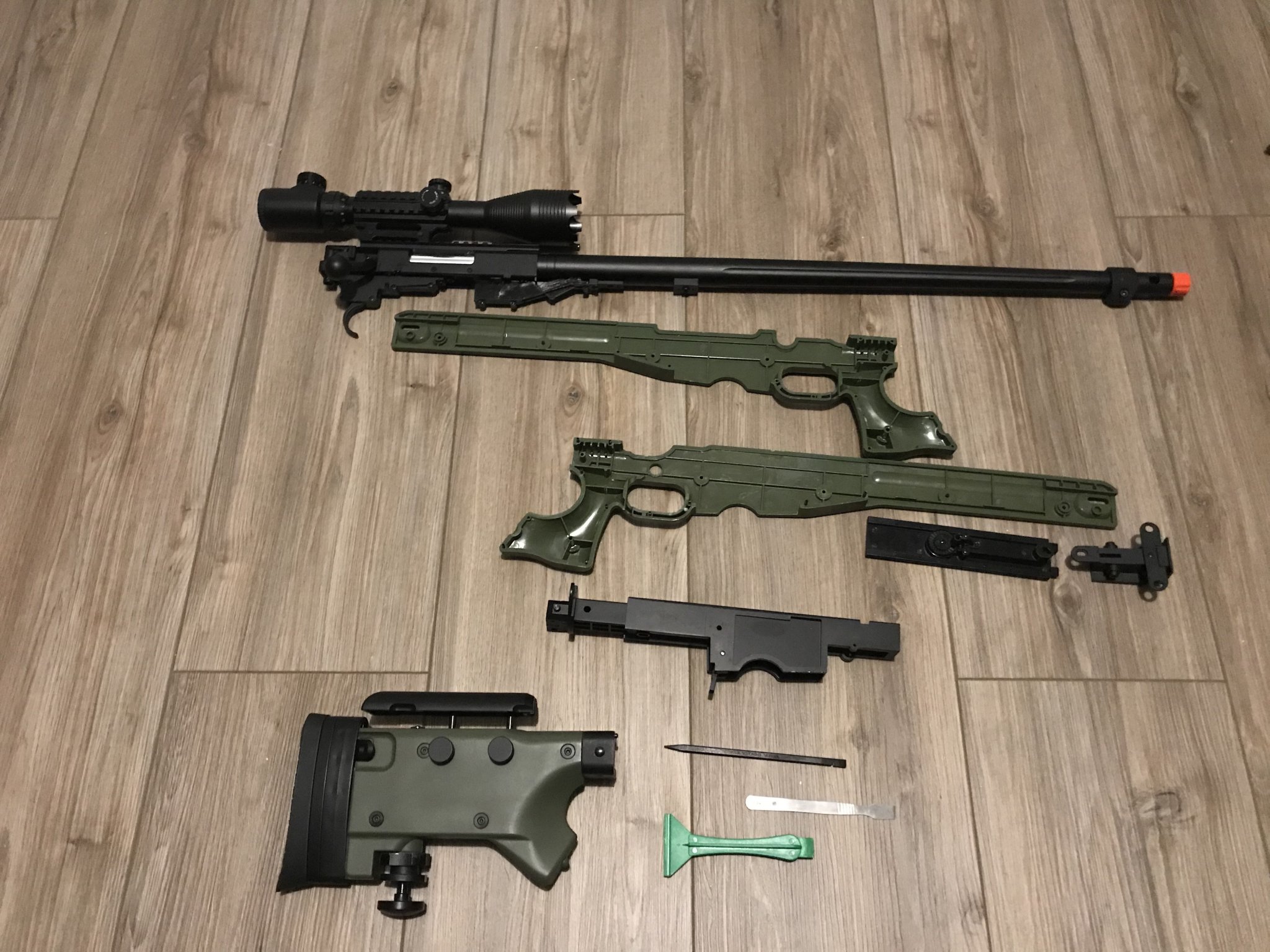

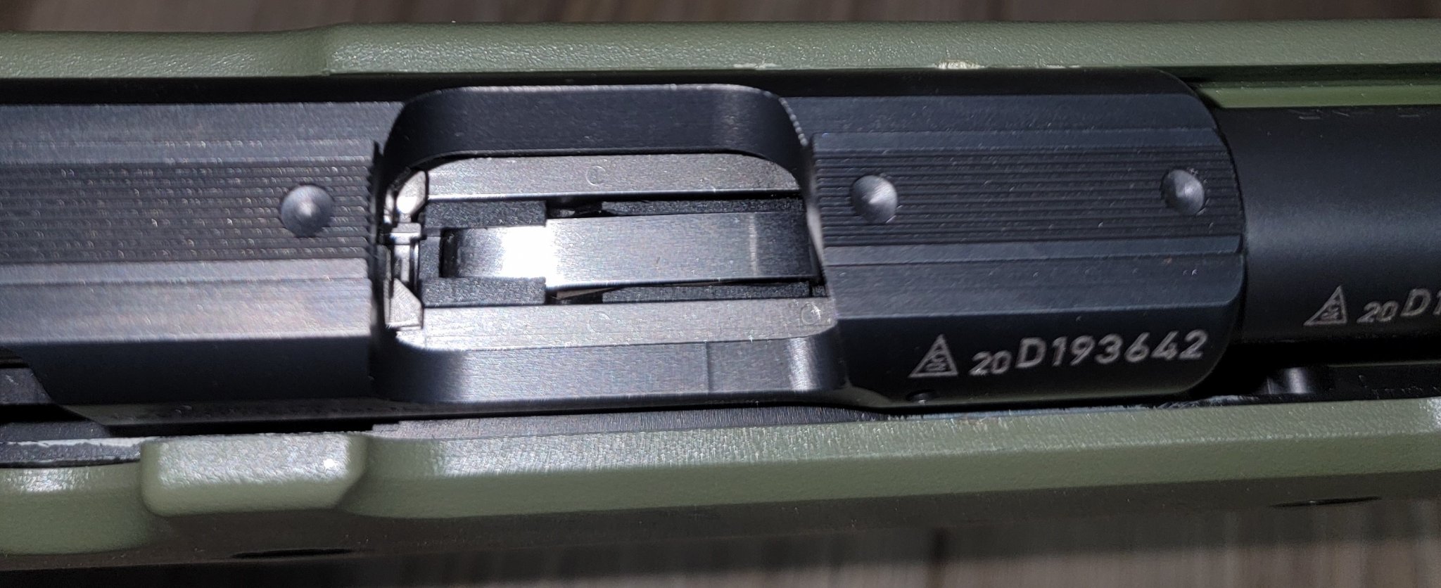

After prying the stock apart (it's held together with tension pins), I took note of everything. The stock has a receiver attachment bolt in the trigger guard and a second bolt within the mag well. I had to relocate the rear bushing to align with the CZ receiver and I drilled a new hole for the second bolt to marry the action to the chassis. I barely had the tolerances for both and was super lucky everything aligned like it did. I mentioned the internals being an aluminum cast chassis, plastic, and fore-end for the sling points and spigot attachment point. I filled in the section with square tubing from Grainger, JB Weld and some thin aluminum shims to ensure everything stayed attached. There should be no real load in this area, save for the bipod attached out front, and I did stress test this attachment method without issue, though I would have preferred a full cast or weld, but that wasn't in the cards. Adapt and overcome and, so far, so good...

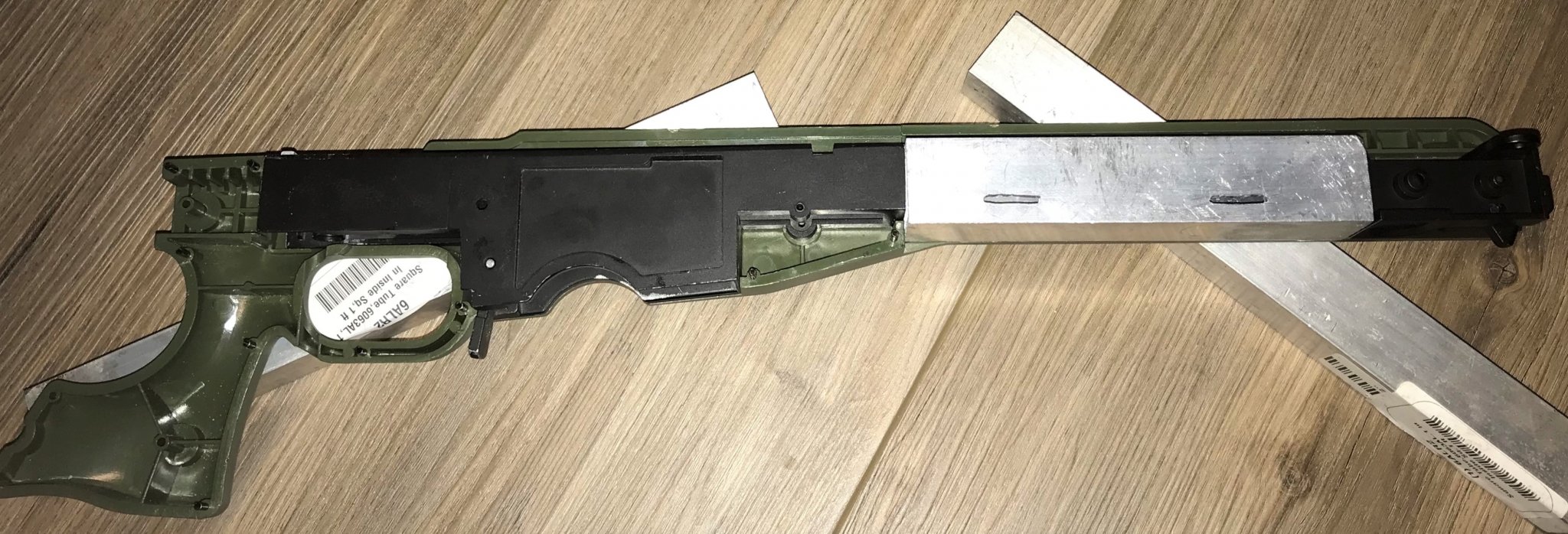

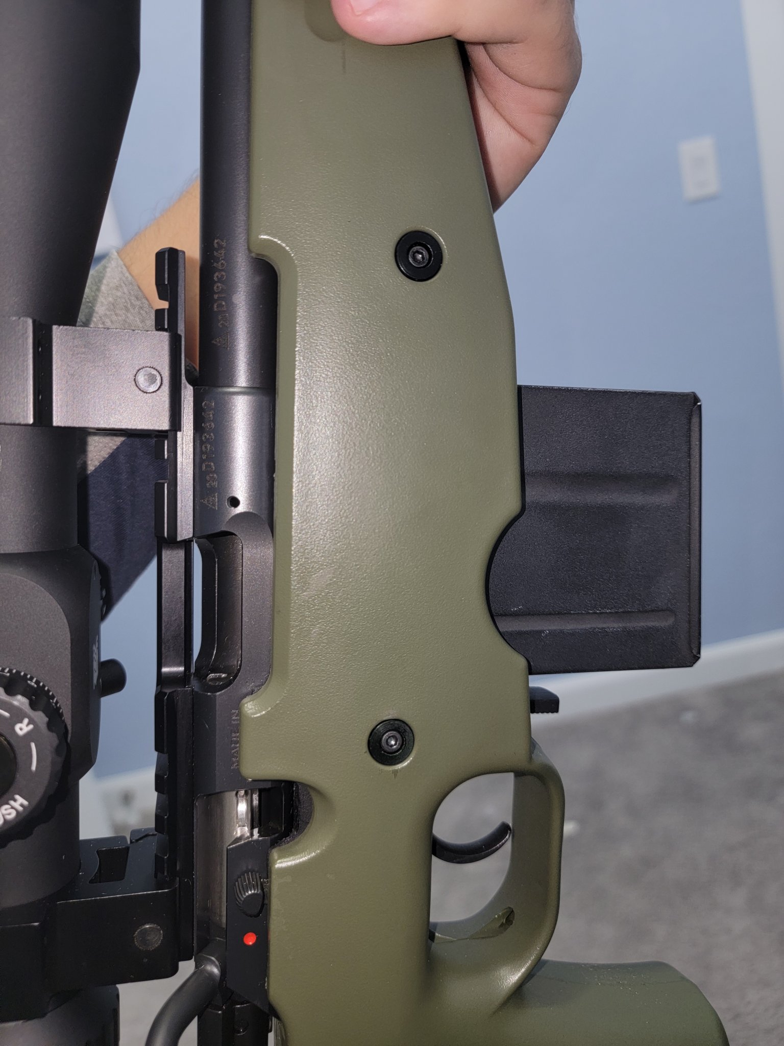

I probably could've done a better job with the tab alignment cuts on this square tubing, but only you're seeing this and a little slop here just helps with assembly. The through bolts hold everything tight and keep the skins well attached. Once I had the rifle chassis fully adapted for my purposes, I had to figure out what to do with the cylinder. I don't presently have anything on my phone, but the magazine is comprised of a metal outer case and a plastic two part BB reservoir/guide system. Basically, I figured out where the magazine needed to be and cut out a relief within the magazine. Once I had everything aligned well, JB Weld came to the rescue, again, ensuring the magazine is securely held through bedding. It is still removable, though, because I maintained the split features within the magazine. You can see the CZ Magazine aligns perfectly.

I can't show it in photos, but I also shored up a lot of slop in various areas. I "milled" a new pin (drill + file + stainless bolt) and resurfaced the faces for the folding stock to take up slop. Similar for the spigot attachment, using JB weld (again!) to reduce the gaps and permanently attach the rail to the spigot. I bedded the action and filled in any voids with L-channel that I filed to follow the contours of the action, then painted everything black. No point sharing the photos, since you won't see the details, but they were steps I took. In between that, I did take it to the range a few times just to ensure everything functioned and didn't fall apart. I didn't have "proper" optics, at this point, so I used the airsoft scope that came with the rifle. I had a friend's son visiting from Europe and I took him to the range. Everything went pretty well and the rifle functioned as intended and he thought it was pretty cool. But, he's a teenager from the Netherlands who had never shot anything before...

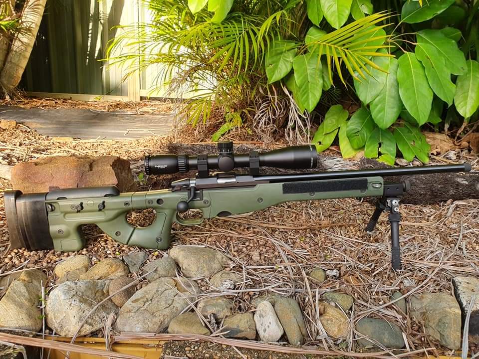

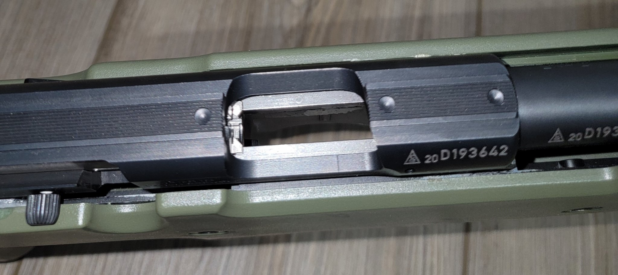

Tikka T1X in a Wombat Ordnance Tikka chassis (Aussie made) and rocking a Sterk bent bolt handle and bolt shroud (Also Aussie made). Standard mag fits within confines of AICS mag port.
Cool. How does that mag release function? I thought the release on the Tikka was forward of the magazine. Is the mag well integrated into the wombat frame to allow the use of a release at the trigger guard?
Refer to this pic. Mag release and housing stays on the barrelled action. It all fits within the confines of the AICS mag inlet. Reach up with your finger to drop mag out. Lots of clearance to get your finger up there. It sits not far from the bottom of the stock.
Glad it works so cleanly.
Tikka was on my shortlist and I probably could have made the action work like I did with the CZ. The actual magazine is held in a shroud to have it the size of a short-action centerfire. The effect is similar to the RimX or Vudoo magazines in appearance, but closer to the Mossberg 715T magazines in construction. Having that larger mag allows the use of the chassis integrated magwell. Hiding the rimfire magwell within the chassis centerfire magazine bulge works, too, and yours looks pretty good. The worst were the Savage conversions with the magazine in the fore end.

Sorry, I only just saw someone respond on this. Yes, I ordered the MB4403. These have a solid aluminum receiver up through the mag well but, forward of that, it's just plastic for the hop-up adjustment. I had to get 1 inch aluminum square tubing from Grainger and I glued it to the receiver using JB Weld to fill in this area. You can see the setup in the build photos.
I'm not sure if a Bergara magazine will fit in this receiver. I can say that I did try to see if my Remingtion 700 action would fit and the screws do not line up. I think the magwell was close, but my 700 has the floor plate rather than a magazine, so I can't say for sure. You may have to do even more work than I did to get your Bergara to work in these stocks.
