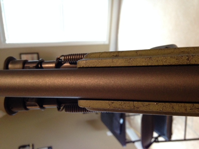

Ok so long story short I have a stock that the barrel doesn't sit centered in - haven't checked my lug on the action yet but- I want to correct it by bedding.
It seems like the bedding block would be too snug against the sides to actually get any bedding material in.
Anyone else have this problem and is bedding a good idea ? It's only off a bit but I don't like it. Can it be bedded like it is or do I need to remove some material??? Help!

Here are a few pics of what I'm working with- was yours this tight of a fit before bedding? I'm just not sure I have room for the bedding? Does this look right?
I understand that it will raise the entire action up in the stock a bit- will it just make it's own fit or will I be too thin on the sides? Just checking before I get into all of this.
Thanks again!
You need to make room for the bedding...
Looks pretty centered to me, not counting the right front. May just be the stock...
I used Accu Riser spacers when I bedded my last B & C stock. They're basically washers that vary in thickness to lift the action off of the bedding block so you can get bedding compound between the two. They work pretty well. I believe there sold by ernie the gunsmith.
Yes, they stay in place and are locked in by the bedding compound. If you search Ernie the gunsmith and look under gunsmith tip number 6 it shows a pretty good tutorial on how they work. I tried to post a link earlier, but it must have been blocked.
I used a carbide burr to remove a slight amount of material and provide a rough surface for the bedding material. Use tape around the barrel to center it and set the action height. Action screws with cut off heads and several layers of tape so that they never touch the bedding material after assembly.
