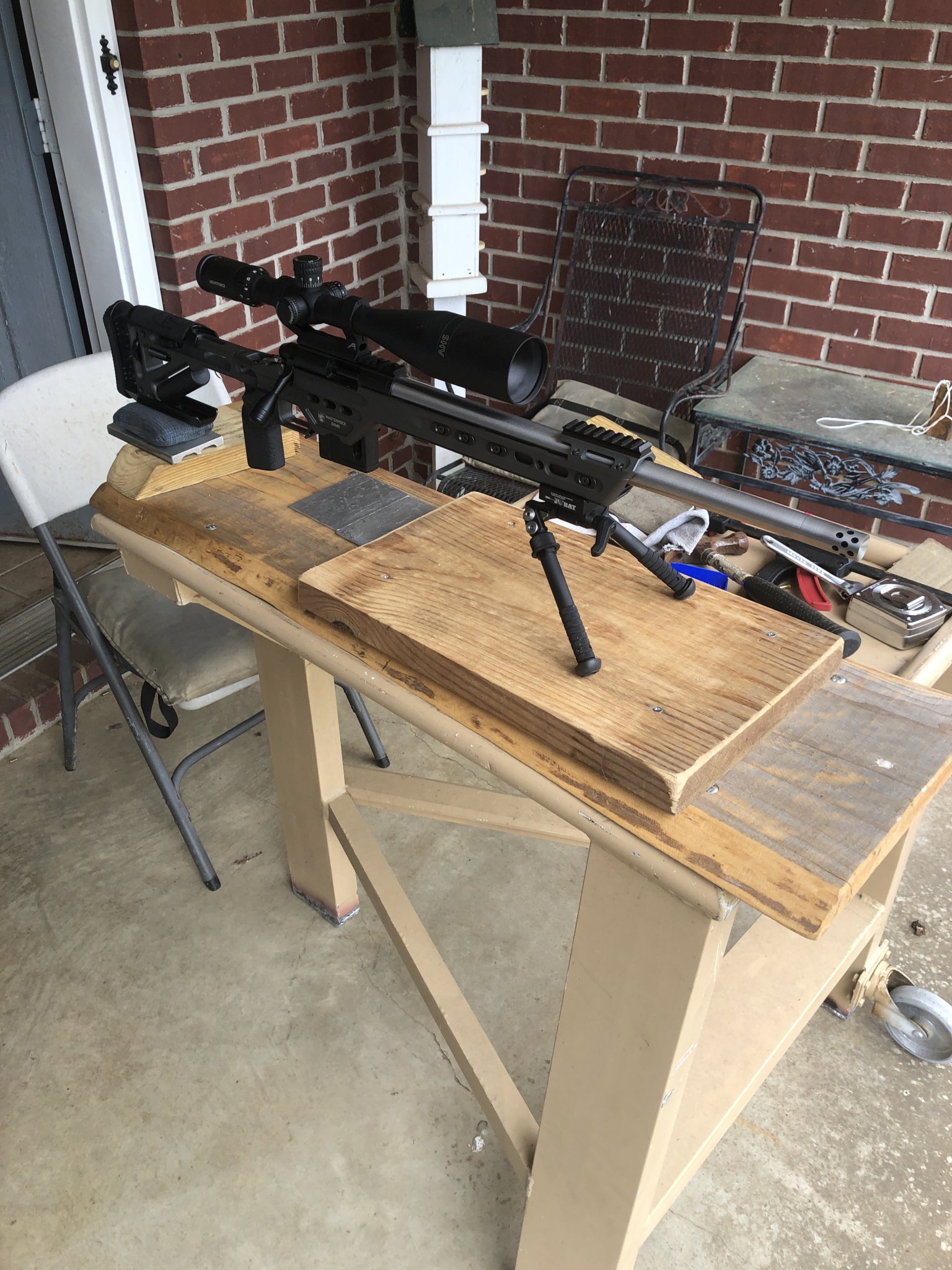

Today i changed bipod legs to 45 instead of 90 and screwed a 2x10 onto my bench to make up for the height loss. Too windy rite now to test. According to 6x5, we shoot similar, wish we were closer, could probably help each other.
Looks good. Me too buddy like minds work the same.
