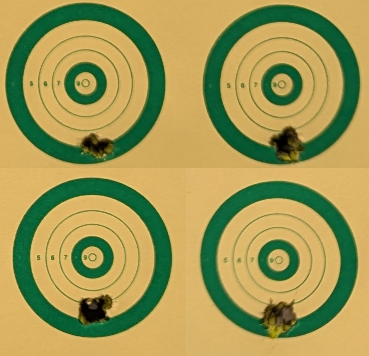

I don't do benchrest, but I've just made sure the action is installed with the magazine in it to make sure it's not canted and tightened it to 65 in/lbs. I could not imagine there's going to be some sort of torque from the bolt that is going to move it... especially given I run my centerfire actions shooting 308,6.5 recoil w/o any issues in the XLR as well.
These are all 10 round groups at 50 yards with the Vudoo.
I get the same results.
The only reason I’d bother is I’m starting to do most of my shooting 150-300y
Even 150 with the v-22 is boringly easy on the 9in plate I have at 150.
Im going to add a 3in, but leave the 9in for friends.
