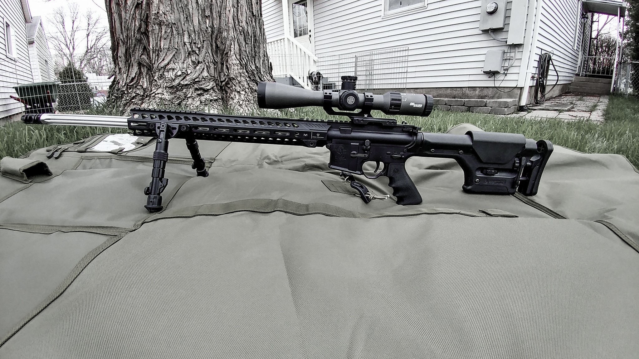

Just built my first AR. I used a Rock River Upper, Lower, and BCG. Wilson 24” fluted varmint Barrel with epsilon vg6 brake, SLR gas block, Magpul PRS stock, Strike Industries Strike Rail. When I first put this together I ran into a few problems. The barrel nut was too small for the barrel. About .050” to be exact. Opened up on the lathe. Nut was hard as hell. Fixed that no problem. Problem is the spacers for timing the nutt for the gas tube wouldn’t work either. No way to fix that. Nut timed at 35 ft lbs and the fit between the barrel and receiver was sloppy. Very sloppy. I wasn’t getting a warm and fuzzy about this. Went to the range and dialed it in. Shot like shit. 2 MOA with Federal Gold Medal Match and worse with American Eagle.
Took it back apart and trued the receiver face up. Bedded the barrel with Loctite 620. Lapping the face also solved the timing problem with nut. Ended up with about 70 ft lbs this time. Back to the range. Used same ammo. Shot two 10 shot groups. The American Eagle was .921” and the Gold Medal was .613. No flyers. Pretty sure lapping and bedding is a good thing. At least when the fit between the barrel and receiver is shit. Definitely solved my problem.
