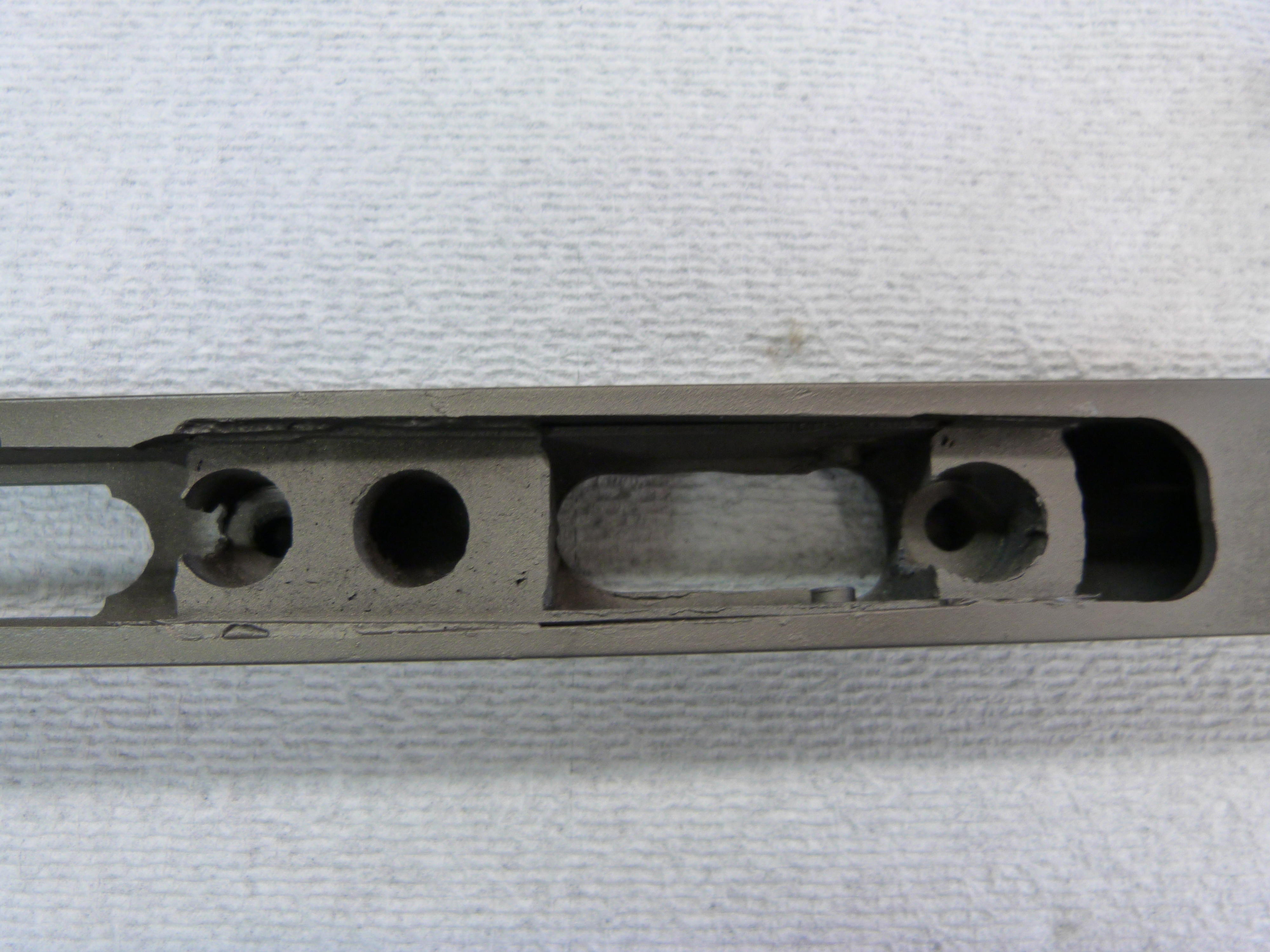

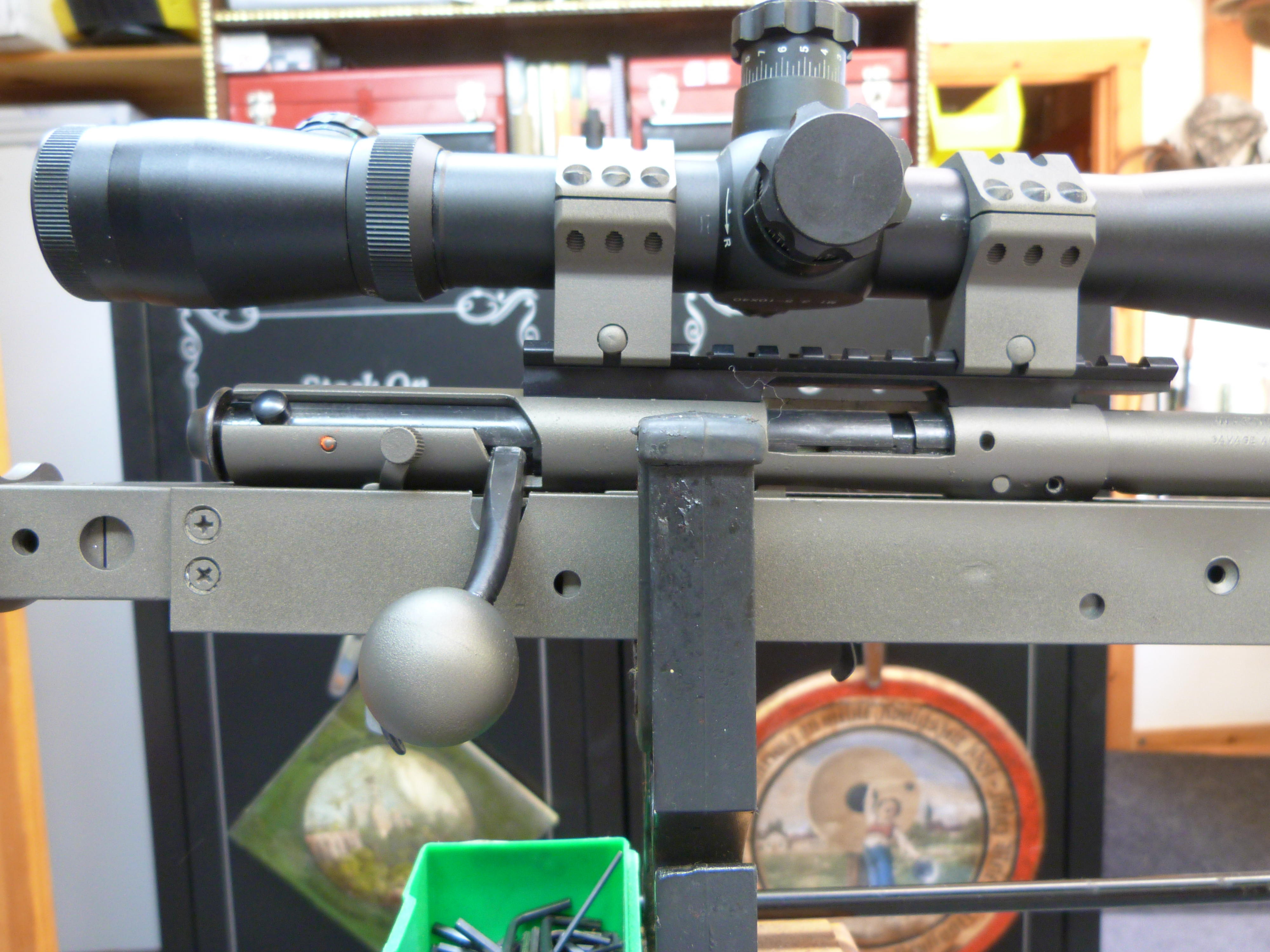

bedding
Like this. Pillar bedding with acraglas gel.
