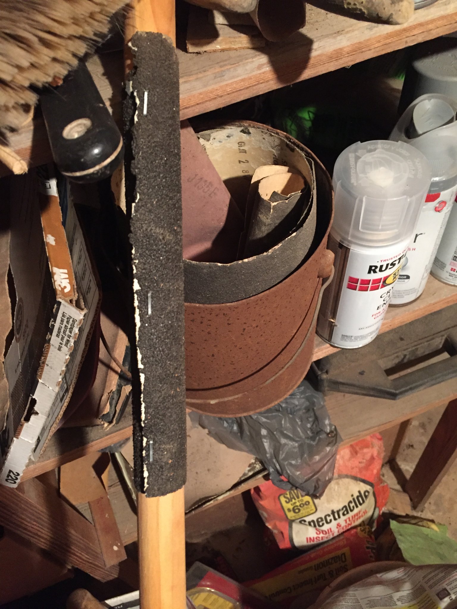

My stock wand
Edit: Thats #2 grit on my wiping stick. Thats right, not 20, not 200. 2.

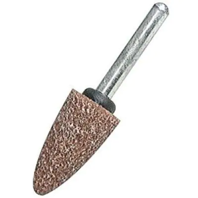

But with the marksman profile I have in my manners having a couple bumps I used the stick for the long straight sections to smooth it all out but I actually took a dremel to my manners at those transition zones with a coned grinding bit in the interest of time. It went quick and its easier to sand the high spots down and blend it in than it is to sand the whole thing by hand. Plus it can be painted again and covered by a barrel so who really cares?
Happy to help.
